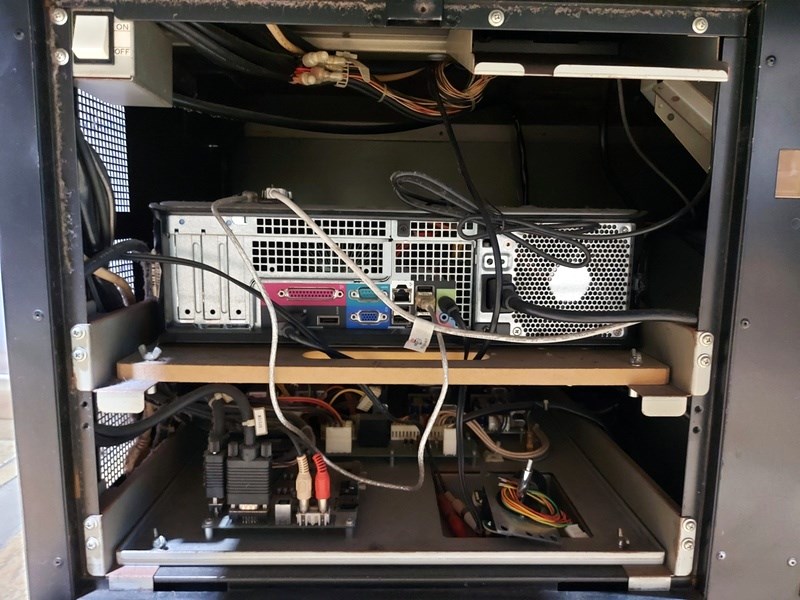

You can Just run a PC off the IEC in the cab no worries. This setup has had mame in it for ages and is setup like a arcade pcb.

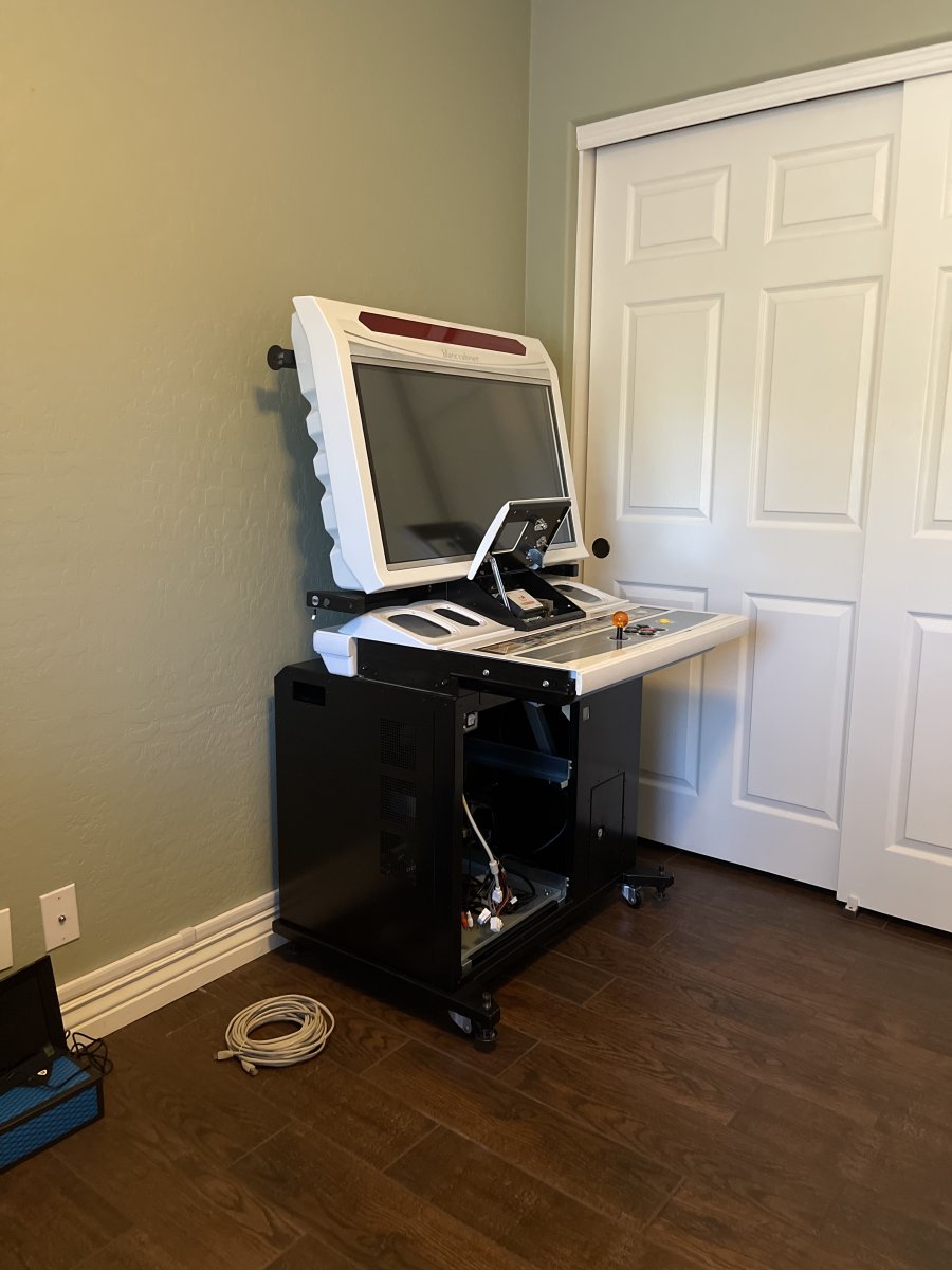

I’m new to the community and just got my first cab, so I wanted to post and ask some questions. I have a Namco Blanc and I was wondering if anyone has gotten the lights to work without the DBZ game, or original hardware. I plan on running a PC and a Mister. When I power the cab on the monitor starts up fine, but none of the other lights come on. Just curious to hear everyone’s thoughts
So I see no way possible to integrate the lights plug and play. I’ll probably replace most stuff with simple LEDs, but that’s a project for another day.

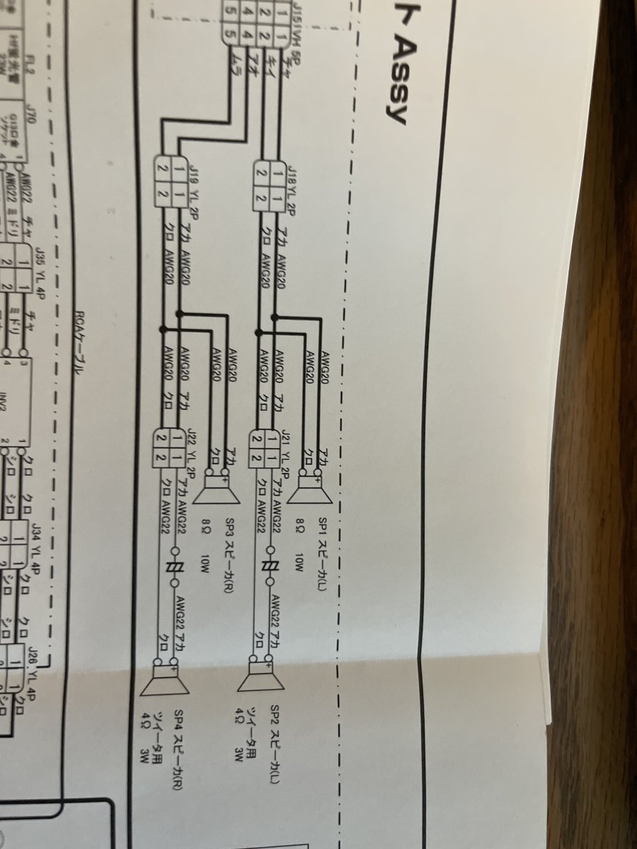

On a similar note, it appears as if my audio AMP (C2-IS AMP PCB) is busted. The other giveaway is the heat shield is bent and barely hanging to the amp. The speakers work on a different amp, but I have major clipping. I tried this amp from Amazon (https://www.amazon.com/gp/aw/d/B077Z7DBRT?psc=1&ref=ppx_pop_mob_b_asin_title). But double checking it appears to be a 4 Ohm to 8 Ohm amp. Looking at the wiring diagram both a 4 and 8 ohm wired parallel. I am no electronics expert, but does that mean I need an amp capable of driving 2 Ohms? Any suggestions?
Take the front cover off your panel and see if the tube in the top is blow (4 screws each side). This & the control panel lights will power on usually without any namco games etc installed.
Ive got a spare c2-is-n amp over here if you get stuck with the speaker solution. There are a bunch on YAJ that would be suitable also.
