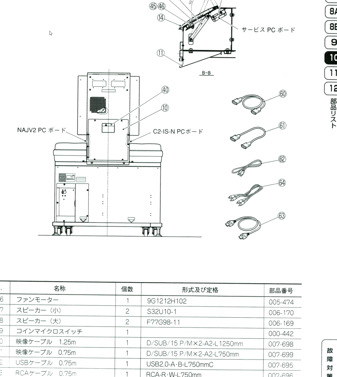

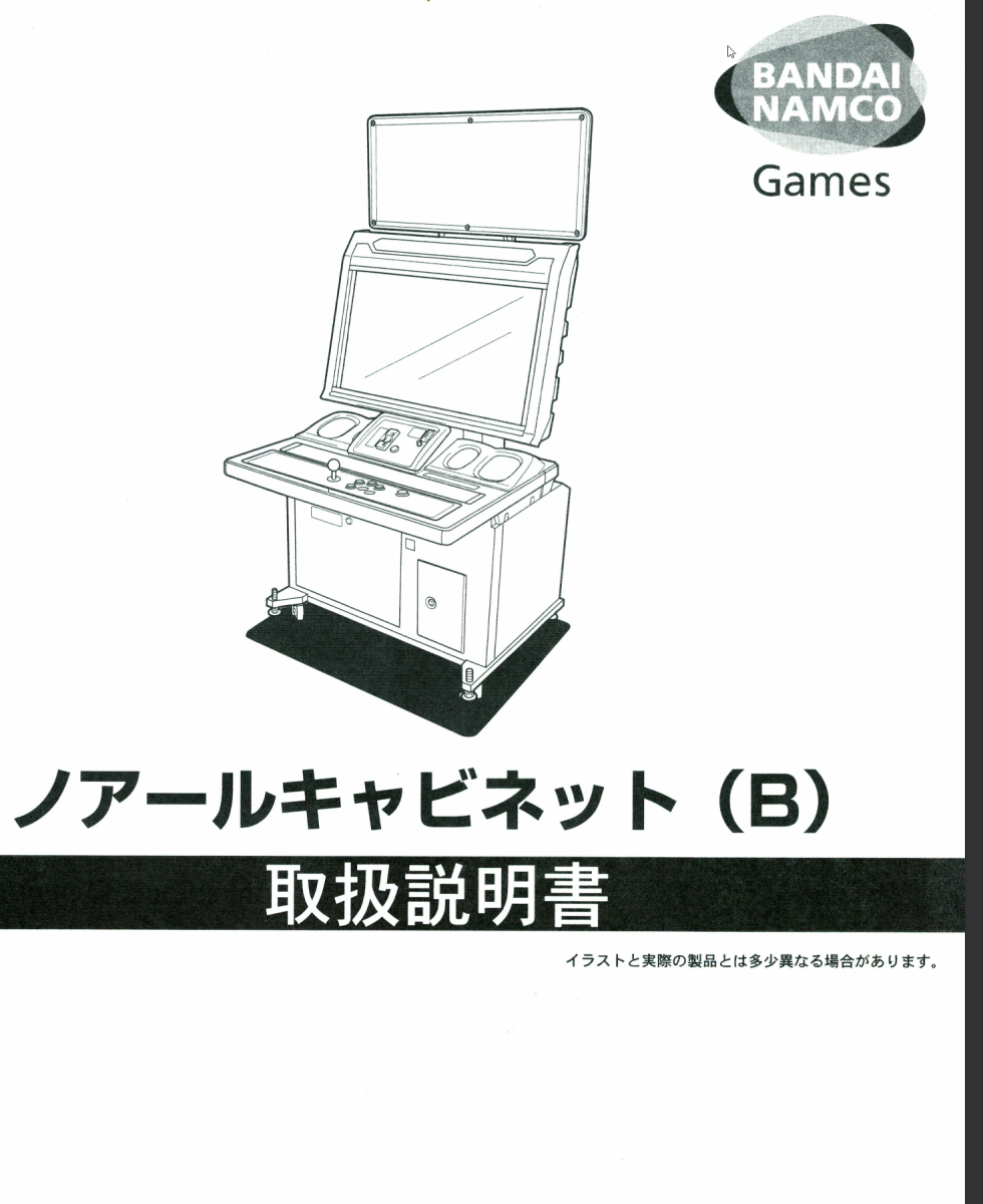

Just a note, i scanned few month ago the Japanase manual of the noir cab" B version
You can find it there : https://wiki.hfsplay.fr/doku.php?id=bornes:namco:noir_cabinet_hd
So its in japanese but we've got the technical information.

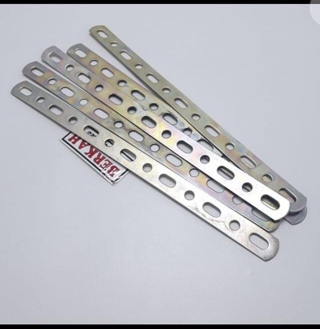

I’ve just got myself a decent 32” monitor to put in my blanc, I’ve removed the old monitor but no idea how I’m going to mount the new one and line it up with the front screen, does anyone have any ideas or done a monitor swap themselves without using original monitor.
so,someone on Fb used Versatile 30cm long perforated iron plate bracket to make it work. Here is a pick of what you are looking for. With these you can essentially make a bracket. I plan on making one this winter at some point to put a 4K in my noir.
edit: you want to use the bracket of the old noir monitor “I used a 30cm perforated iron plate arranged in a rectangle assembled with the default Namco Noir bracket, and it went in and was good and re-installed with the screen plastic casing neatly” The monitor he used
