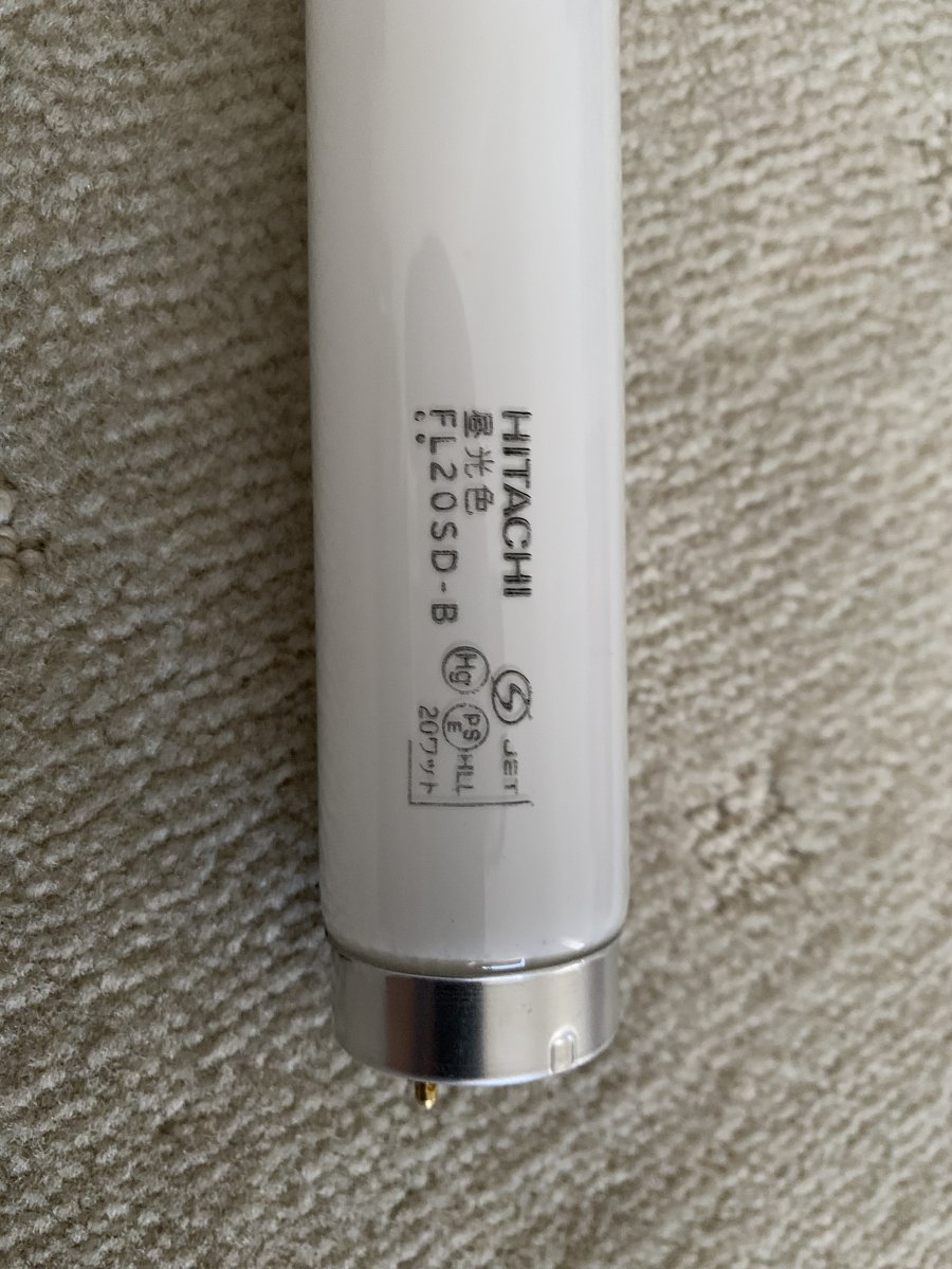

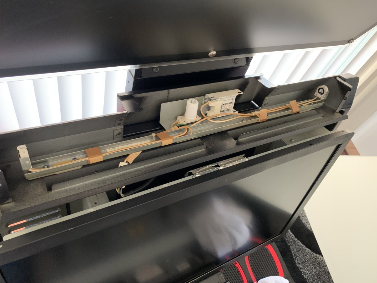

Hi, first post on here. I recently acquired a 2007 early model Noir, and it appears the overhead lamp was DOA.
Is there anywhere I can get a replacement lamp or drop-in LED conversion kit?

I ripped mine out since I couldn't find replacements. I put a 100v LED on it and just tapped into the existing 100v connector.

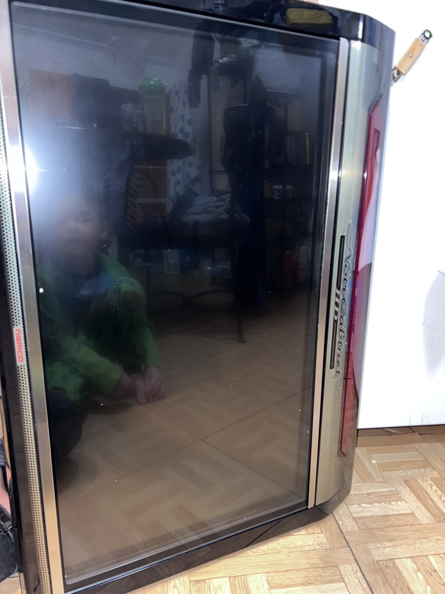

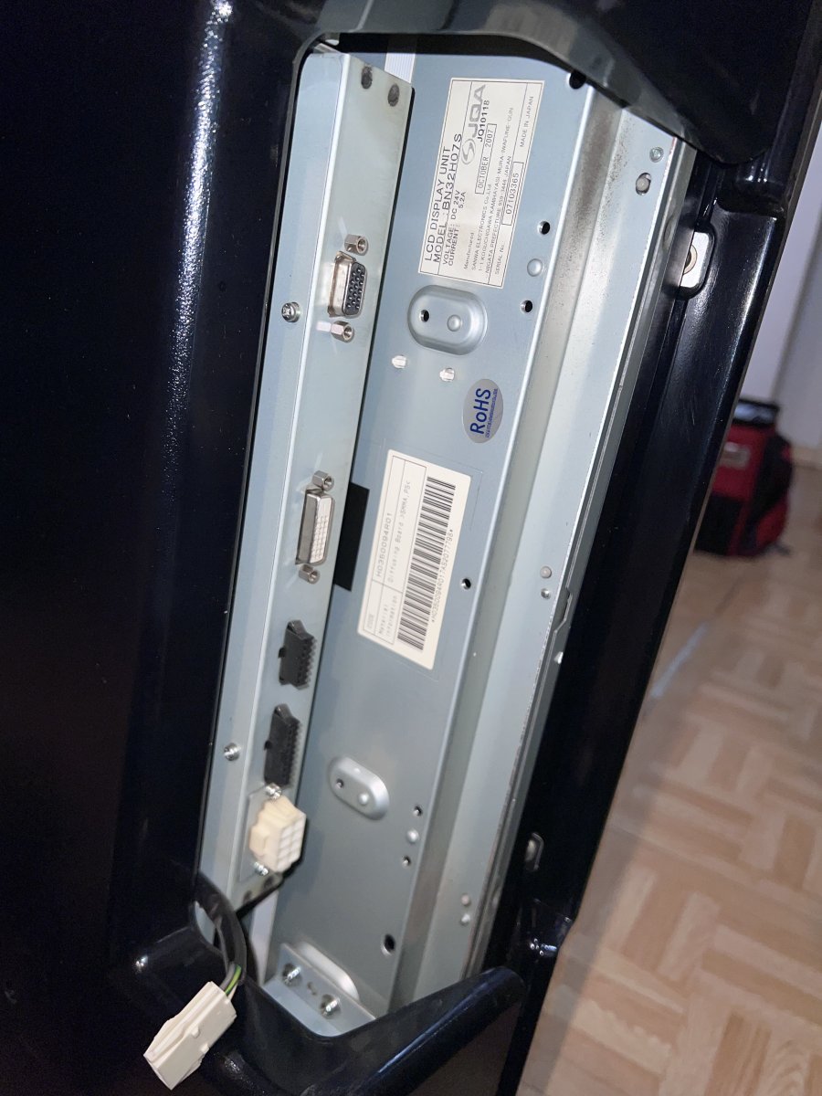

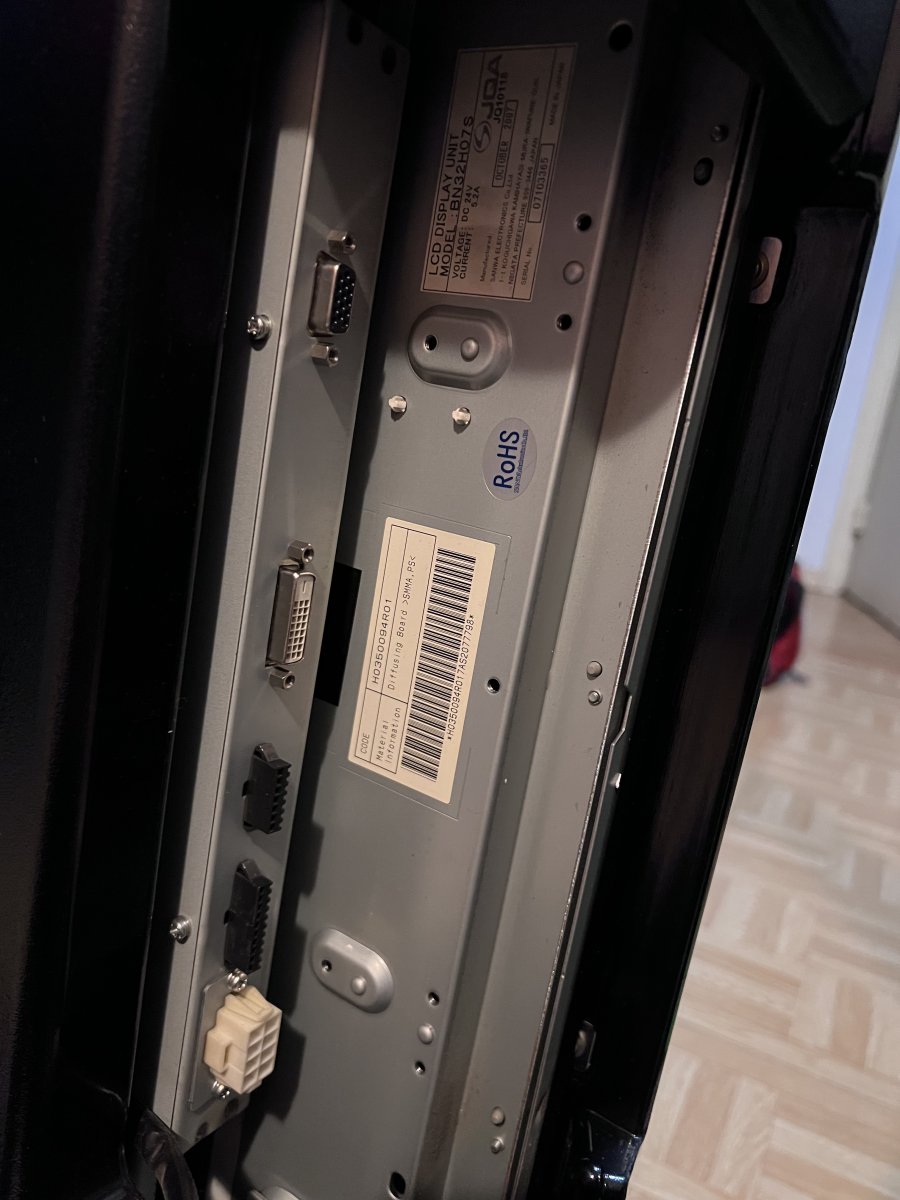

I ordered a replacement monitor with bezel from Japan. But it did not come with any plugs. So basically I don’t know how to send it power and have no way of adjusting the picture settings. Is there any way I can get the board to adjust picture settings and a diagram on how this thing gets power?
I'm not sure exactly which monitor you have, but on my 720p sanwa version, it looks like this:
Looking at the manual, the you'll need a JST YL 8 Way to get your 24v source to the monitor (which you will need to pull from the PSU) and a JST XH series for the test/service buttons
I think this cabinet as a spare and has been stripped of its parts. (I bought it cheap) Isn’t there supposed to be a board to adjust the picture settings. And what kind of psu do you recommend.

This is the monitor.

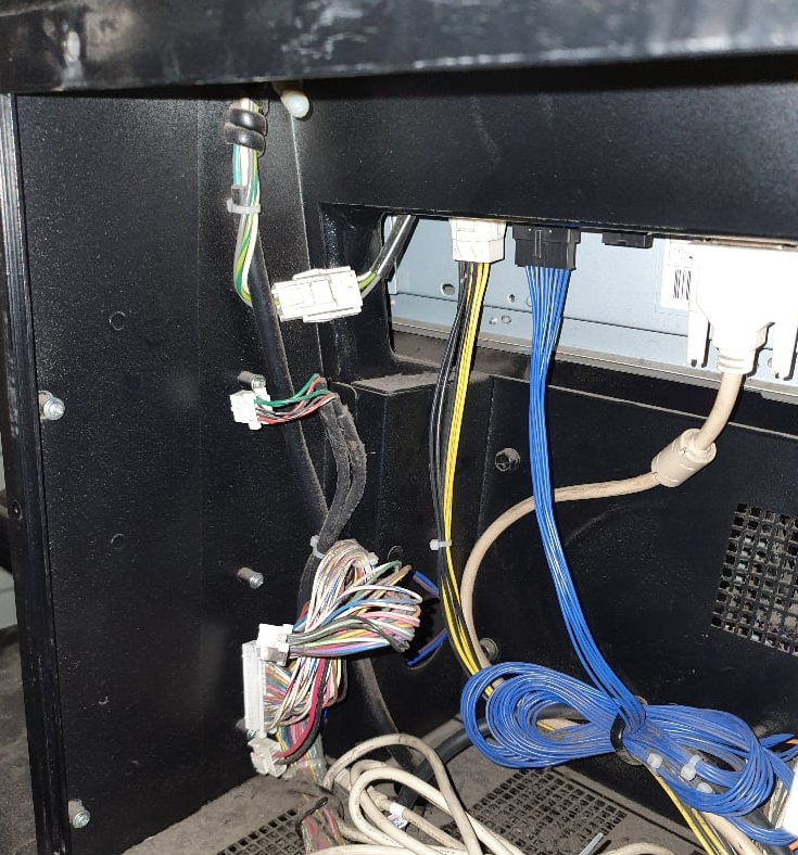

My guess is the 3 pin grey green white wires is power to the fluorescent tube. The blue wires are for the pcb that controls the monitor which I don’t have. And the yellow and black is for powering the monitor?
same as mine.. the 3 pin is for the fluro (100v).
The white connector furthest to the left (when looking at the back front on) is for power (24v - wired up as per the diagram above) the first black connector goes to my remote panel

It’s used. I got it from yahoo Japan auctions. I used Buyee to order and ship. Cost too much. Yahoo jp sold it to me for 160. But shipping with Buyee cost $350! The good thing is it was shipped fast with fed ex. Received it in a little over a week.
