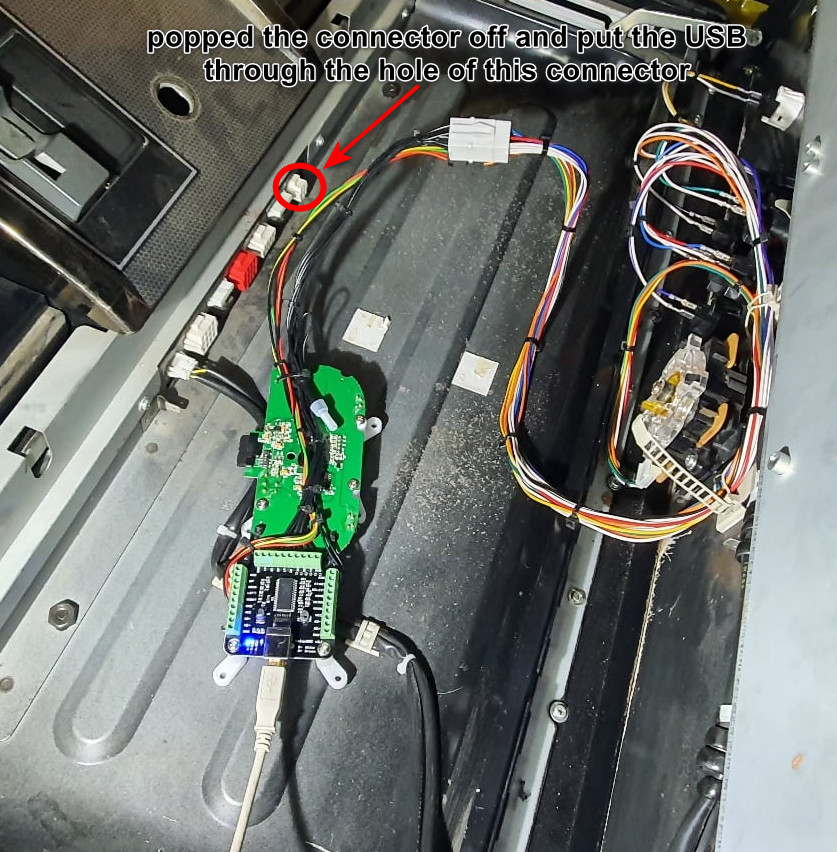

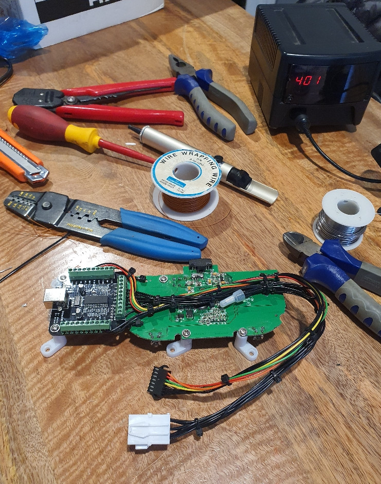

Looking to do this to possibly wire a Brook board and also maybe try my hand at getting a USB cable through for a phone charger. Can someone show a pic of exactly which thing can be removed? Thanks.
I did something similar but with old parts I had... I dual modded a 360 fight pad with a chimp (ps3 + imp for switching boards). Had them wired to the respective connectors of the cabinet so if I want JVS, I unplug the two connectors and connect them straight to the back plate, if I want PC/360, I unplug and put them back in
The whole I used to pass the USB cable through was the last connector

Are you breaking that last connector with pliers to get it out of there, Julius? I guess I'm nervous to pop it off as I don't want to damage anything. What would go to that connector if it was left in there anyways? And noted on the 3.5 to RCA female splitter for PC. Tracking that down on Amazon now.
nope. Just pressing it down from the back plate
I actually didn't bother finding out what goes there, I'm sure it'd be on the manual
Successfully got it out without breaking anything. Now for the next part - if I plan on going between 1p and 2p Brook/Bigbox setups, should I opt for two Zero Pi Brook boards and rig things separately or is there a Brook board out there that handles two player setups with ease? I'd prefer the one board that allows for 1p and 2p options as it would cut down on cable management. There is minimal info online/YT about two player Brook setups. What do you think?
