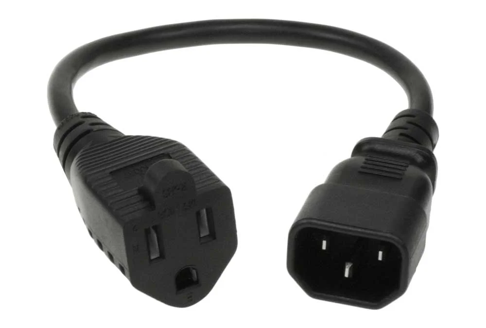

For power inside the cabinet there's a hard wired C13 power cable (like a normal atx computer power supply cable). You could get an adapter to then plug a power strip into it if you need more outlets.

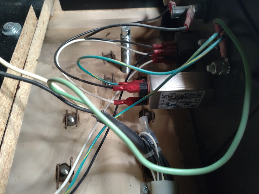

Here's some pics of the power area. It's pretty much just the power switch, fuse/breaker, and ground distribution. Since the transformer is 1:1 you probably could replace it with a 240 to 100. It's just hot, neutral, and ground/earth in and out.

Thanks the pics will give me a idea the cab I will prob get a outside stepdown & may convert it later down the line the previous owner of my Lindy did the same.

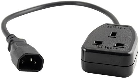

I will prob add a power strip like this if it has the kettle plug like yours.

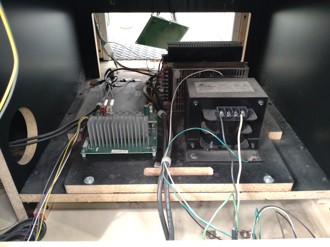

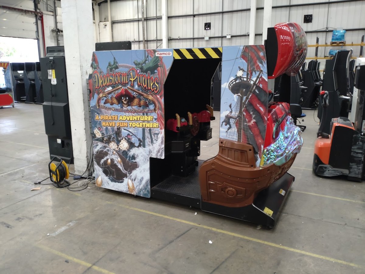

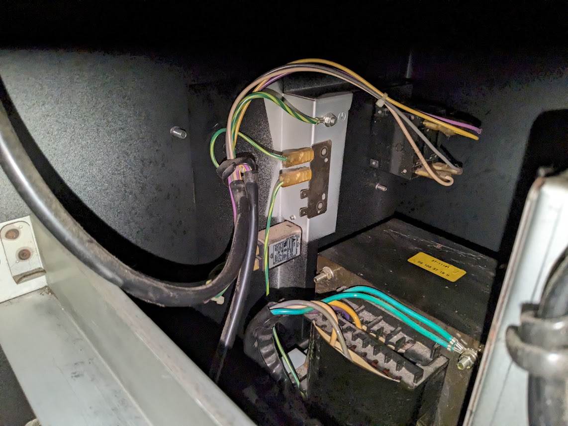

Low & behold I had a Deadstorm pirates SDX cab on my run up at work for next week (I mostly fix gambling stuff but we have the odd video here & there) & got to take a few pics of the power area Namco like to use those isolation transformers don't they.
And I also gave the Namco 357 (industrial PS3) a good strip down & dust out after this picture was taken.

This is what Namco put in the Deadstorm Pirates cab:

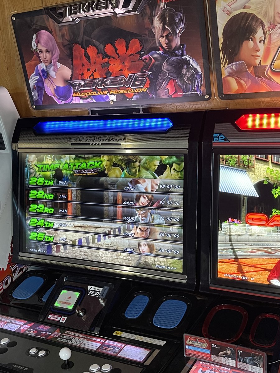

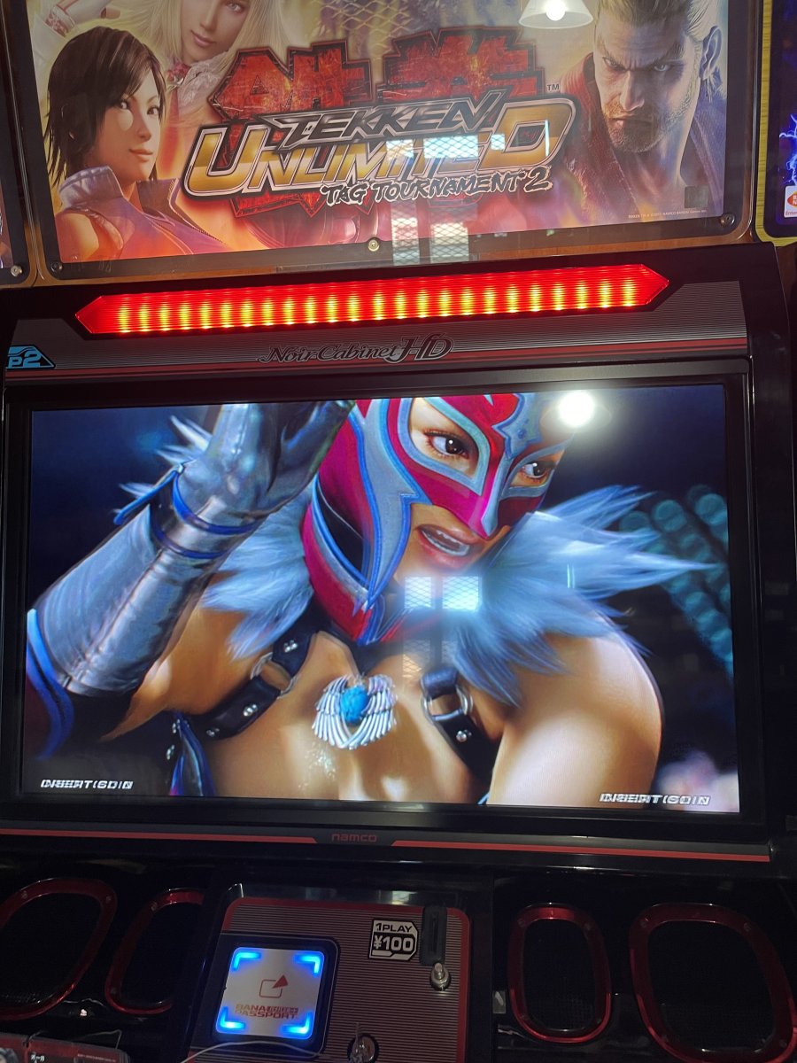

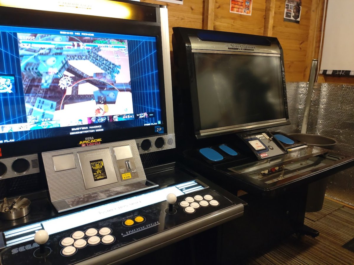

@muckyfingers helped me replace 2/3 my noir monitors. He utilized gorilla tape and this monitor for both cabs. I am very happy with the results.
LG FHD 32-Inch Computer Monitor 32ML600M-B, IPS with HDR 10 Compatibility, Black https://a.co/d/5XCDpRr
(I just had a kid so if I posted this in the past and forgot, my bad) 😂
Wow, those look wonderful!

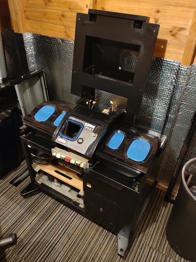

And so it starts...
I've started to strip it down a bit so it can get a good clean
