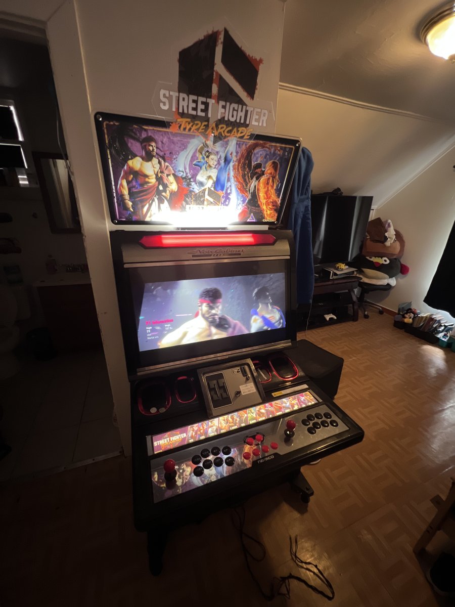

Super random - does anyone know the total height of a Blanc with the DBZB topper? It sits soooo much higher over the monitor, I was curious about the actual combined height.

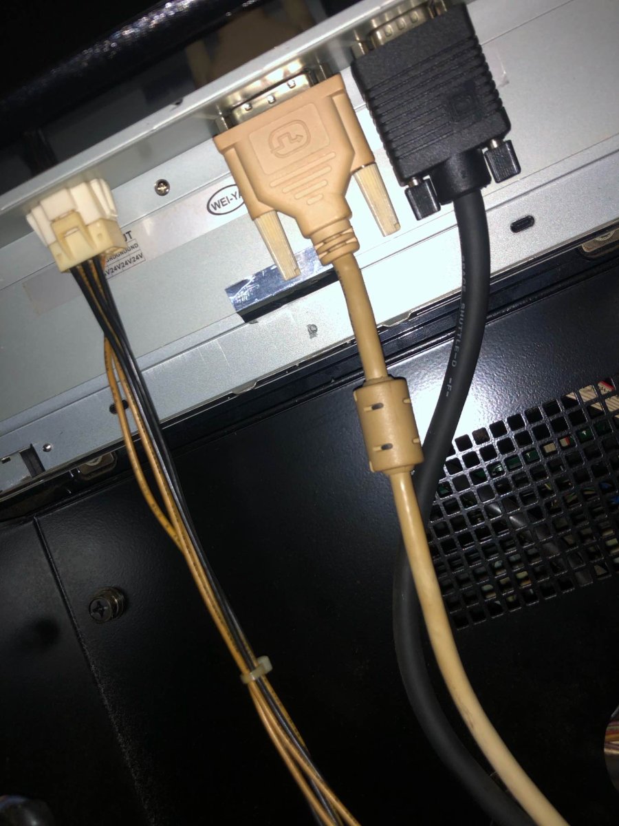

The seller in the UK sent me a picture & the blue has the Wei-Ya but looks like its VGA & DVI only am I right in thinking the V2 has HDMI?

The monitor themselves are DVI and VGA, the cables in the Noir are VGA to VGA and a DVI to HDMI.
That was the case for my monitors as well. I think I have two different revisions of 1080p Wei-Yas.

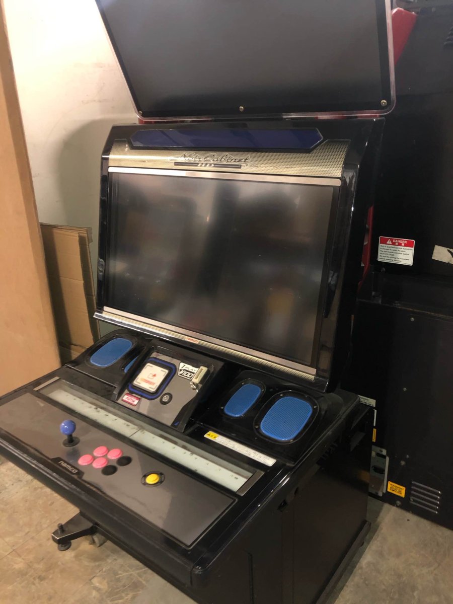

Here are some pics on what is on offer.

The red ones are VGA and DVI, blue to I think.
The metallic red ones may be HDMI, they are newer.
My red one came with the original monitor which was back lit with fluorescent tubes, although the image was pretty good I swapped out for a modern cheap HDMI screen.
in my limited experience you want to budget for a new panel, yours will be rusty and perhaps a new screen.

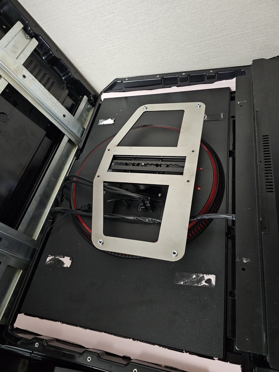

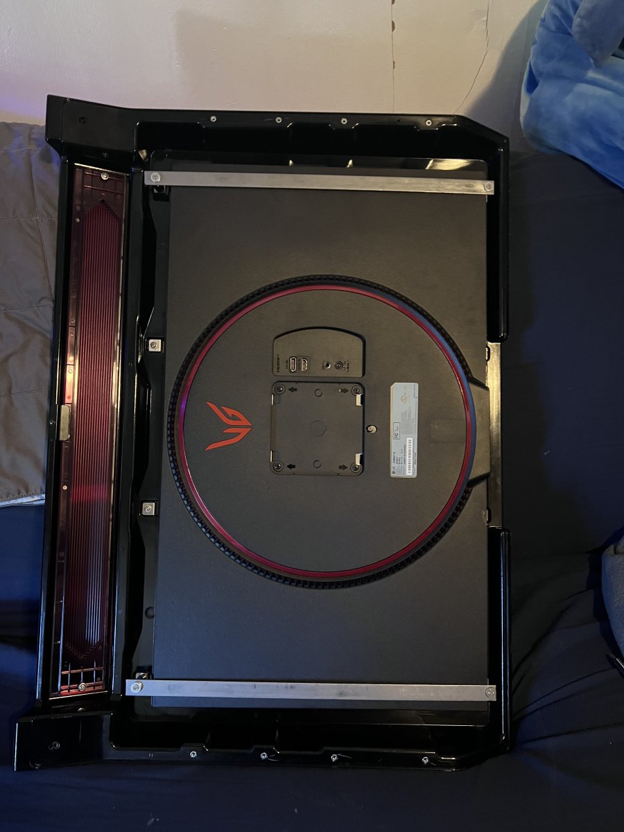

I had a LG monitor from Costco installed. Use 2 long metal brackets on each side with the same screws that come with the bezel. Easy install. Toss the old bracket. Just cut to size and drill two holes in each.
That’s a great simple solution, but you would have to make sure the monitor that you are using has a bezel/frame around the monitor.
If using a monitor that is bezel/frame free, the monitor would just fall forward and/or wobble around.
Source: Me, trying to mount a bezel free monitor in my red Noir with double sided tape and getting nowhere. I ended up making a one off wood mount for that specific monitor.

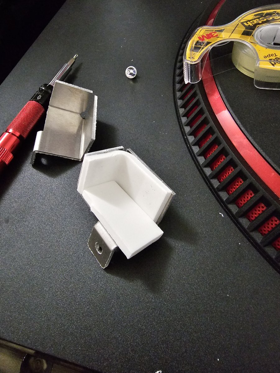

I think I might just scrap my bracket ideas and finally do that. Its been time consuming since I dont have a 3d printer/metal shop readily available.
