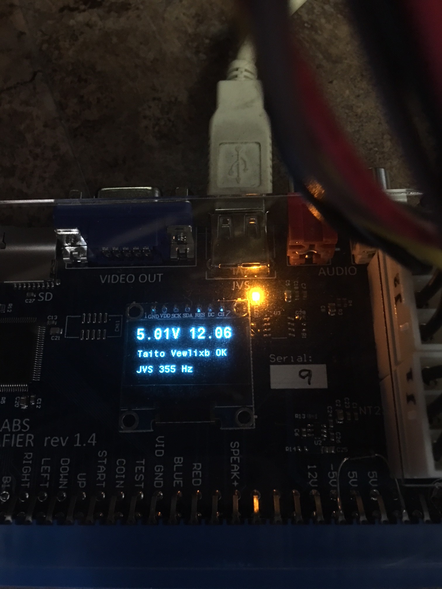

Just got mine in today. Everything works perfectly on New Net City. Got the kick harness wired up ready for some cps2/3 games

Woohoo! Let me know if you need me to test anything for youIn other news, got the vewlix IO today and there is indeed hope
Still doing a bit of research on it, but the fix to get above is really easy and something anyone can do. I'll post a bit more when I have the facts.

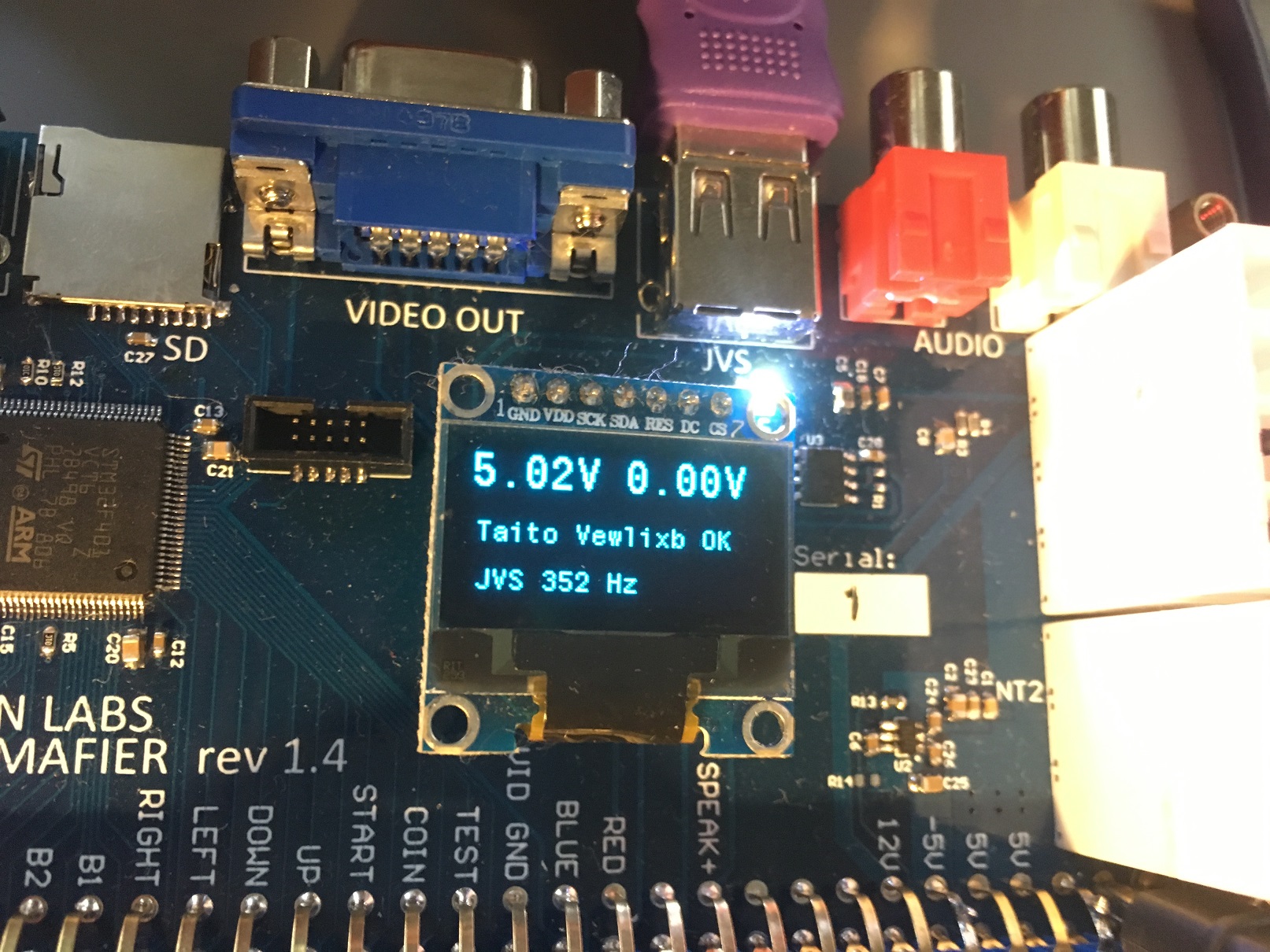

I've tested the mod with other IO boards I have at hand and all looking good (sega, capcom, taito egret3) and in theory it should be good all around. The resistor removed is to make the signals a little 'prettier', but not all JVS systems use it so it shouldn't have a negative impact.@invzim Thanks for figuring it out. Does the fix affect the jammafier working with other boards after this fix?

Great stuff! Thanks for testing quickly, one thing is on the bench - but you never really know until it's tested live.

The vewlix io has a couple of 100ohm resistors in series with the JVS datalines, I have no idea why they did this or what they were hoping to accomplish - and I've seen other RS485 design that does this.
Big thanks to @Derick2k for sending me a board to investigate.
