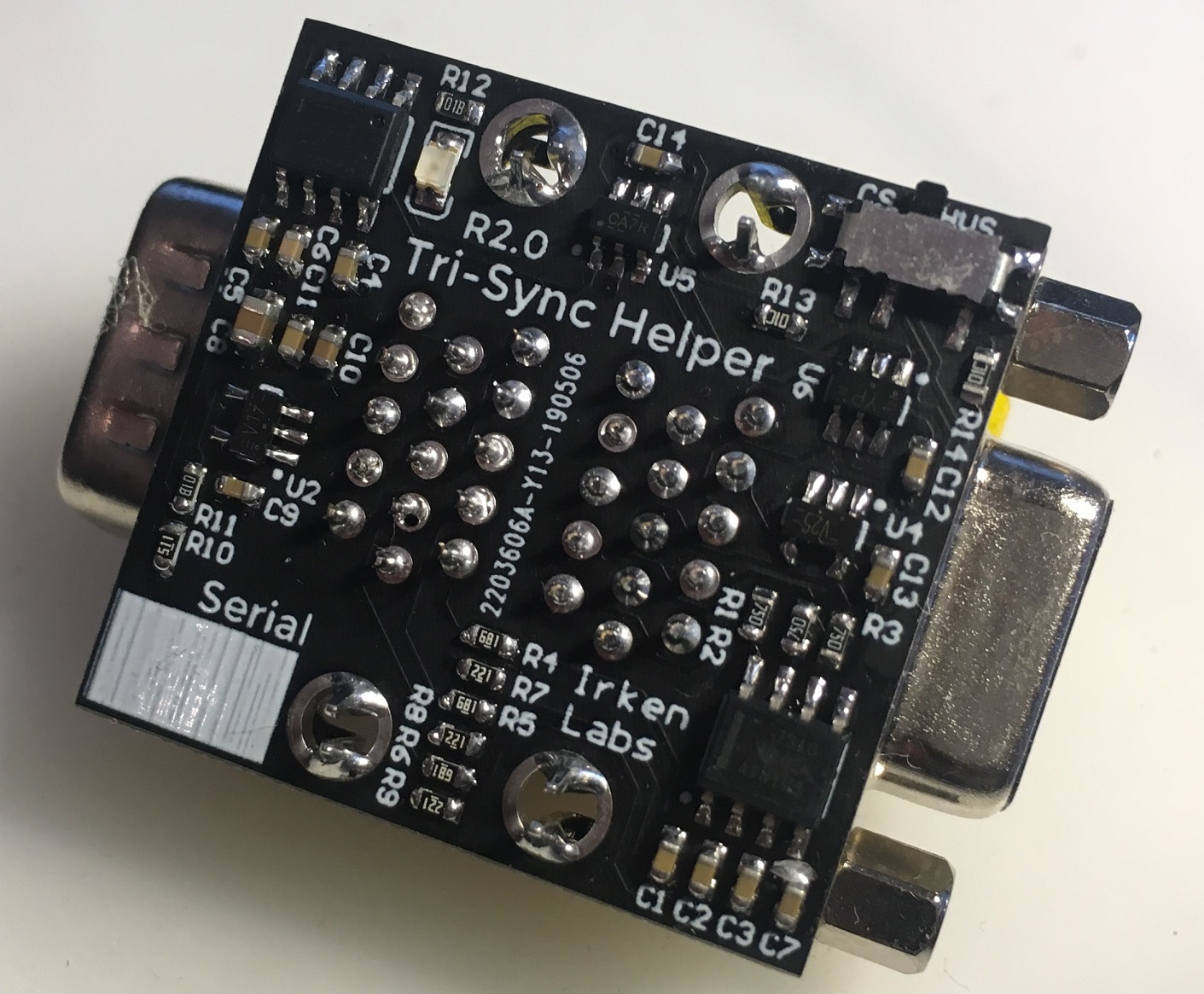

Also I'm happy to report the Tri-Sync helper does an excellent job on the MS9 from the Cyberlead!
