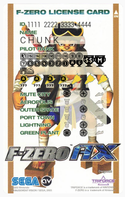

I've got my first test print using real game data, doesn't look too bad, just need get some higher res scans as this one is ripped from a Japanese auction site with the original print data photoshopped out!
That would be brilliant, thanks very much, I'd be grateful for any that you have, the aim is to get a selection so a random card is offered when purchasing in the game.

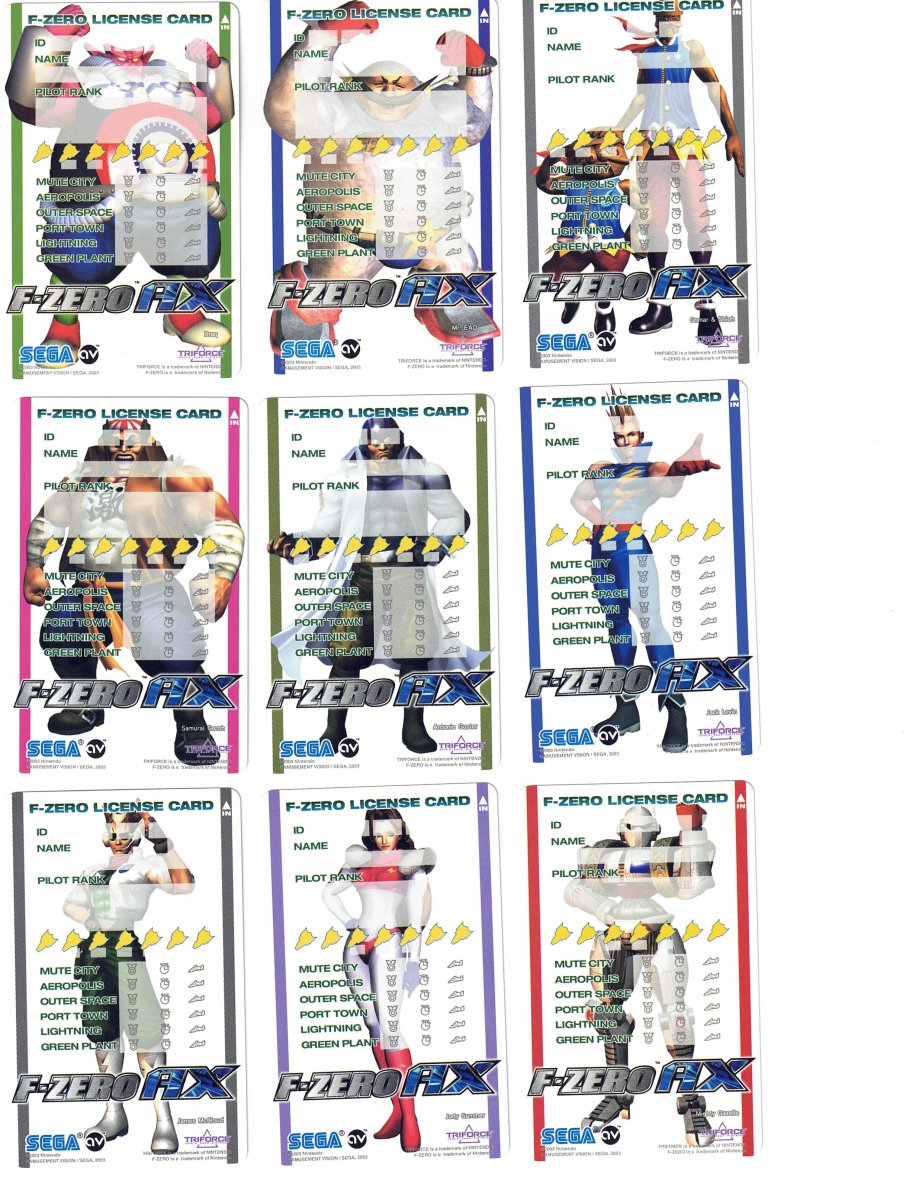

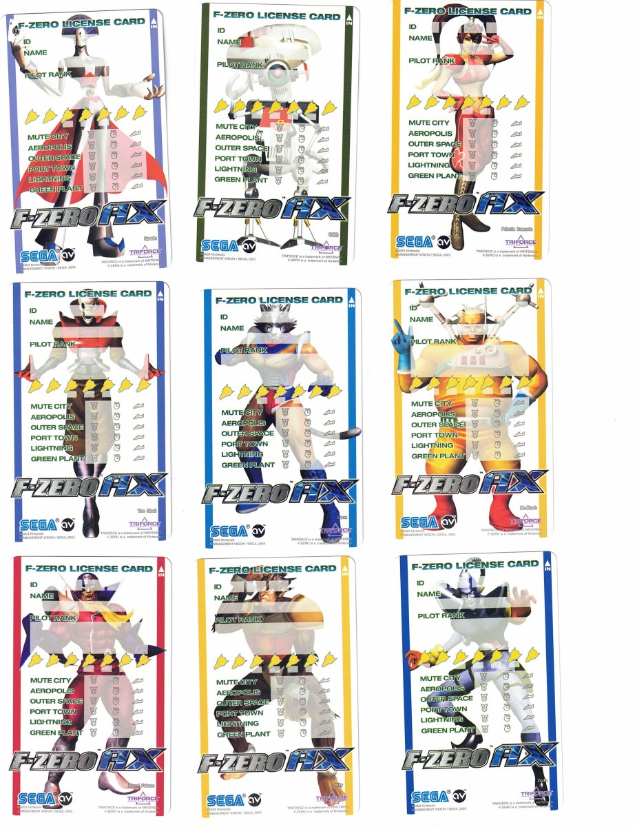

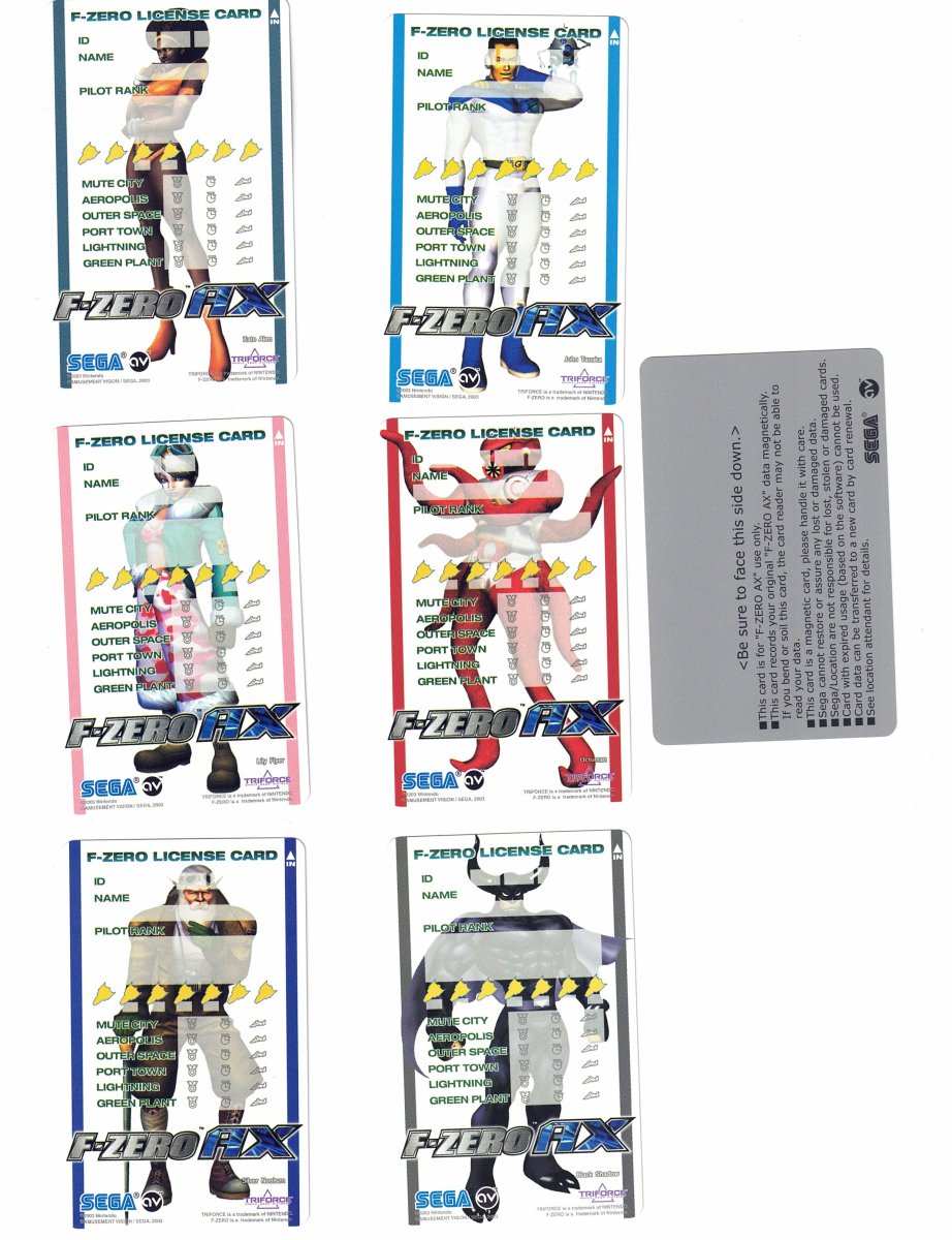

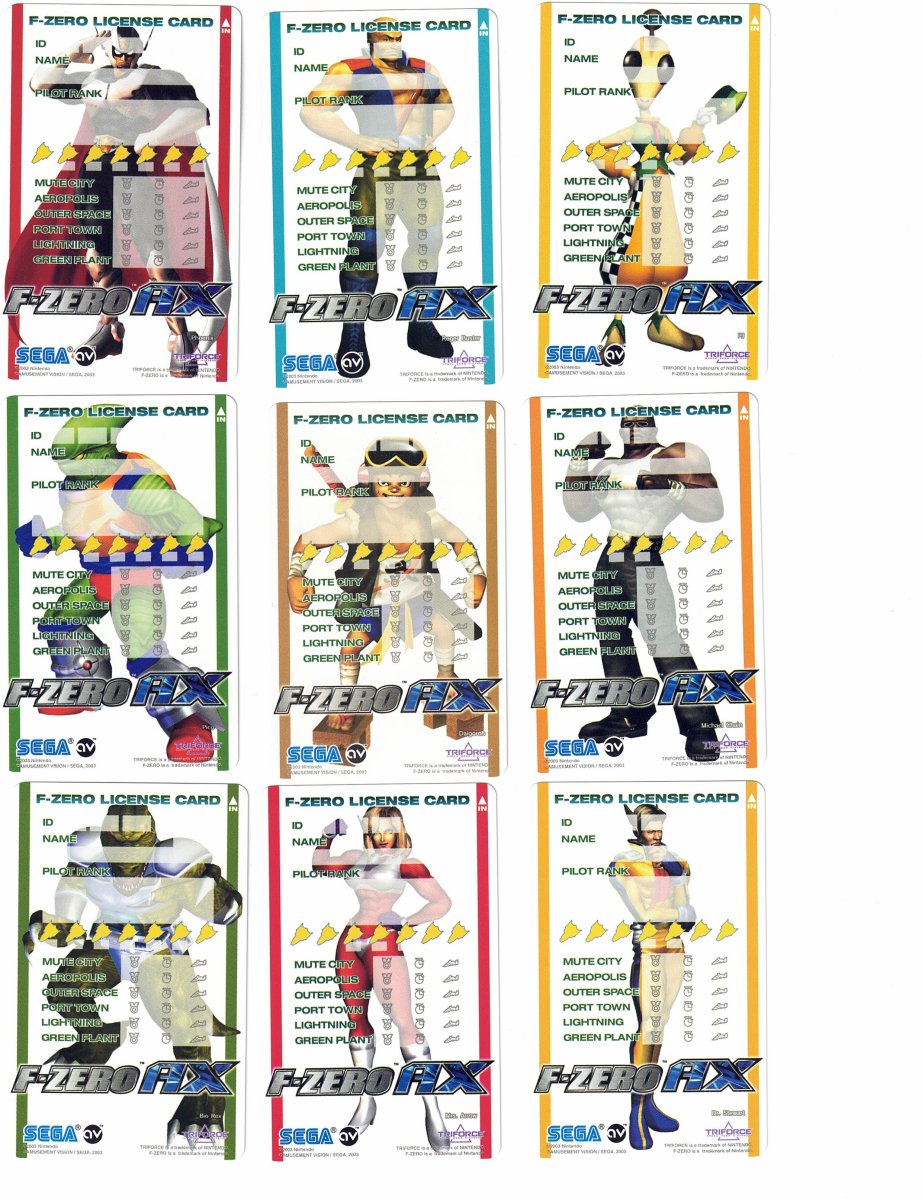

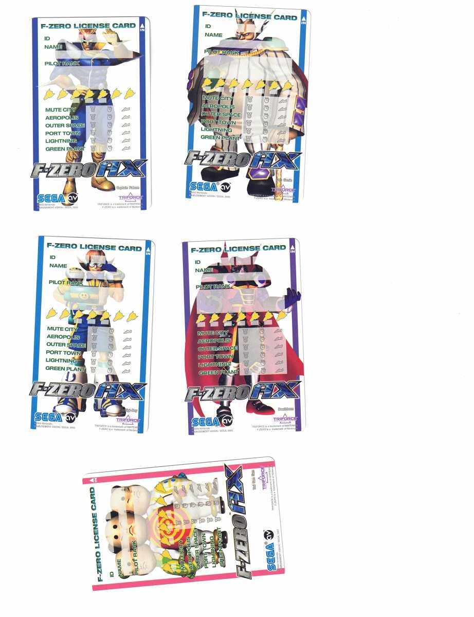

I'm missing some in the scans but I have all the cards except the Jp exclusive one that came from the Gamecube. Potato quality at its finest

Wow! I honestly didn't realise there were so many! many thanks for scanning them in, it's great to see them all together like that - unfortunately ... I need them at a higher res :unsure: - the other cards I have are all around 600x1000 pixels each to capture all of the card detail and make the icons clear when printing them, I know it's asking a lot but would you be able to rescan at around 300dpi for me please? if that's not possible, no problem, I now have a list of all the ones I need to find!
96dpi according to Windows, the files attached here are only 200KB each, did they get resized when attached?
Probably. There is a hard limit i believe to post pics. Pm me an email address and I'll send it when I have a chance
Got them, they are perfect! thanks so much again for scanning those in for me, the F-Zero code is all done now, I'll release it along with Mario Kart which I'll start this week
