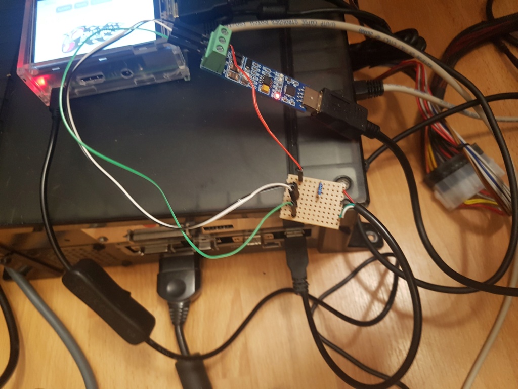

So I always this error with OR2:
So my setting:
Have you set the controller for OR2 in OpenJVS mappings? The Chihiro message looks like your RS485 adaptor isn't being recognised or the openjvs process is not starting. Can you post an image of the launch screen for OR2? It should show what mapping file is in use.
Try changing the value to another colour like red or yellow to see if you get any change on the LCD
it seems base board witth usb faulty. I will change it.
