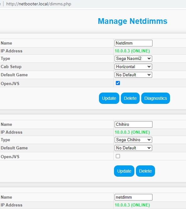

ok more or less sorted. I think this can be summarised as user error :)
So it turns out that when I added my netdimm in the wipi software I used the scan function rather than enter the IP and details manually. What i didn't spot until I got my laptop out instead of my phone is that the system type that was discovered during this process was naomi instead of naomi 2. Changing this to naomi 2 (my motherboard is a naomi 2) under "manage netdimms" sorted out the issues with games not loading.
What's interesting is it wasn't just the naomi 2 games not loading, but some naomi games also. Lesson learned - have a netdimm entry that matches the hardware system you are using.
So with just naomi 2 selected under netdimms I can load all naomi and naomi 2 games. If I select a chihiro game I go straight to a no dimms available message - no attempt to load the game. If I change the system type to chihiro under manage netdimms, then select a chihiro game it will load (or at least attempt to load as I don't have 512Mb yet) and not display no dimms available on the wipi menu. All makes sense so far.
The next step to try was to add multiple instances of the same netdimm IP under manage netdimms i.e. one for naomi 2, another for chihiro. This then allows me to load up both naomi, naomi 2 and chihiro games. So I have a netdimm entry (or multiple) that matches the hardware system of games I am trying to load, rather than the actual hardware the netdimm is being used with.

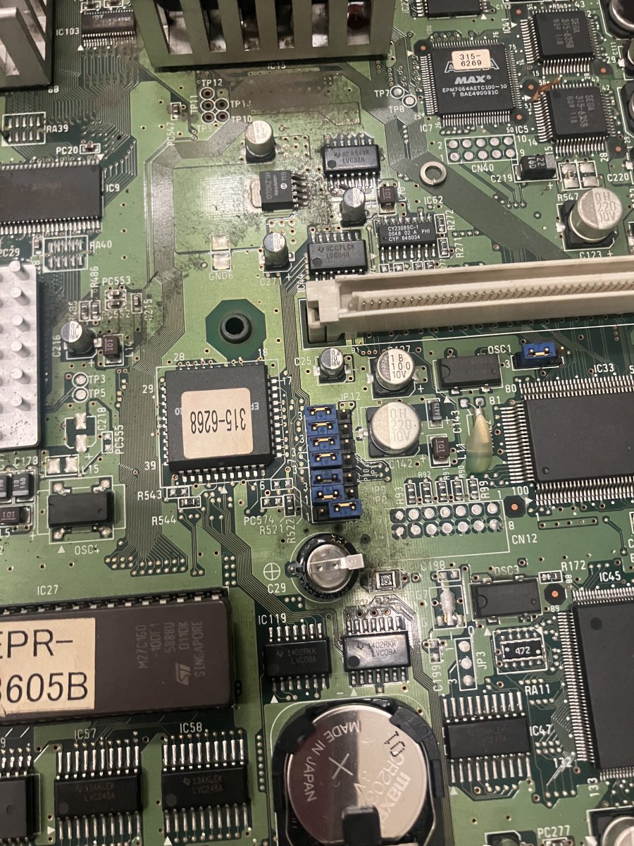

Hello, I tried card emulation with Naomi 2, I use FTDI Breakout -> Naomi CN8. Everything is connected but Initial D Arcade 3 Makes
"CARD R/W ERROR"
Should I do something?
I Changed The Jumper Setting on the M/B, Like attached files.
Thanks.

Ok its not recommand to use a Chinese clone FTDI BreakOutboard. Its repeat 00 00 00 at response.
Now using some other cable, it will be work.
