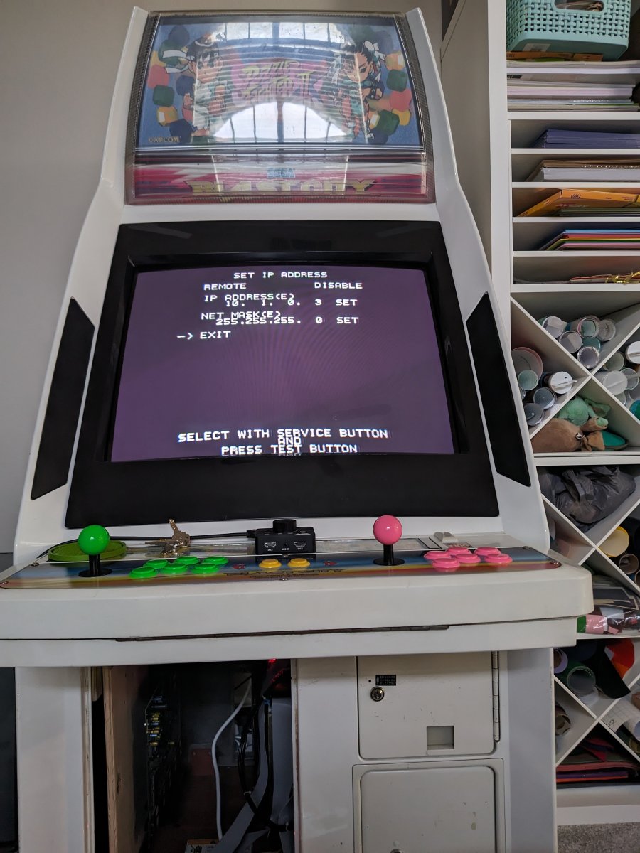

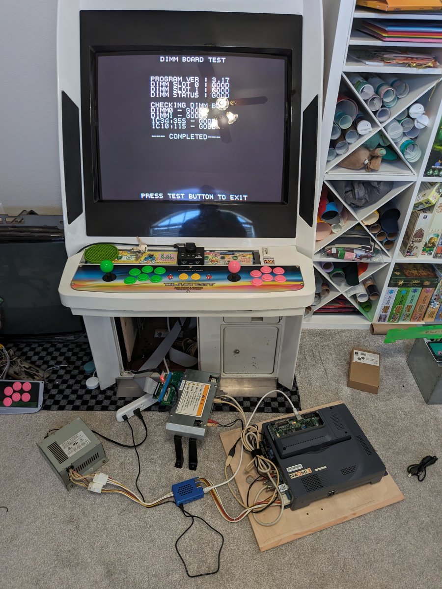

I decided to bust out my naomi netdimm setup today, but annoyingly my Pi refuses to connect to the netdimm via the ethernet. I used this regularly for ~1.5 year, but haven't used it for about 6 months.

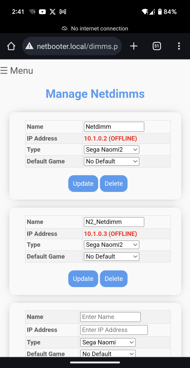

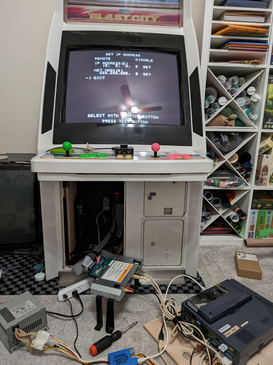

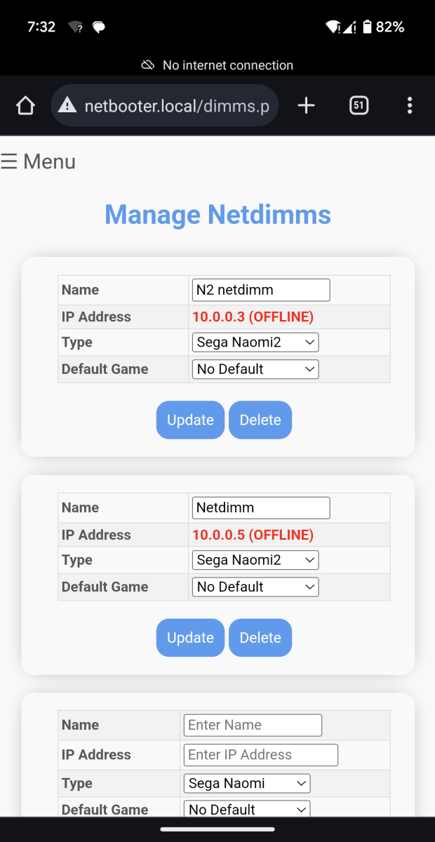

Voltages are all good. Board is all seated as expected. Dimm board test passes. I tried changing my IP and deleting/re-adding the naomi in the WiPi menu.

Dimm version 3.17
Wipi version 6.1-4
Setup (note dimm cover is off because I was checking that the sub board was seated):

I just directly connect the WiPi via ethernet to the netdimm.
Tried multiple confirmed good cables.
No hardware changes. I just put it all on the shelf for ~6 months and then tried it again.
I had the same problem not too long ago.

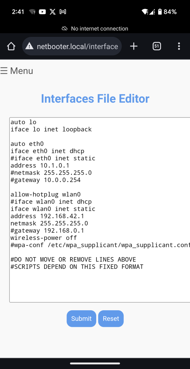

Reconfiguring the network settings to a new network segment on both sides solved it for me.
I tried changing the ip addr on the netdimm and adding it as a new device in the WiPi. Is that what you meant?
Not exactly - I changed the LAN interface configuration to 10.1.0.0/24 instead of the 10.0.0.0/24 subnet.
So for example 10.1.0.1 for the wipi and 10.1.0.3 for the netdimm and connected everything to a switch to rule out a cross over cable problem.
Aah okay I think I follow what you mean. Still no good though 😭
