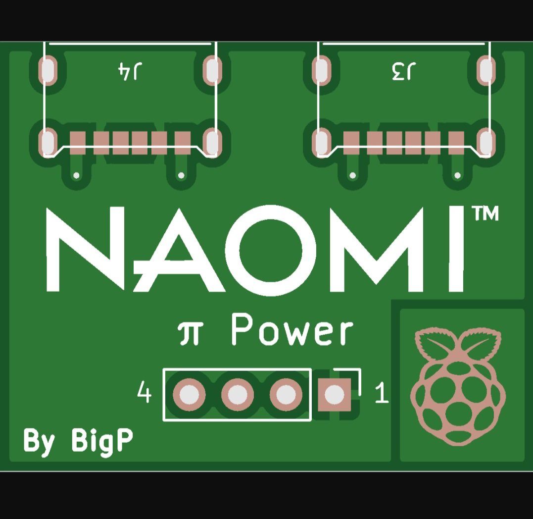

Any advise on what to make a power cable with for USBC on the RPI4B? I just pulled apart a usba to usbc power cable and the wires are pretty thin, looks like max amperage on usba is 3.1amps. Is it better to just use GPIO?
Is there any reason you need more than 3.5A for a RPI4B? That should be plenty unless you are running so power hungry hats. At idle the 4B draws 0.51A (2.5W) under load maximum draw is 1.52A or 7.6W at 5V. The CN12 connector (or is it CN2 I forget) draws off the 5v rail so it should be fine. I looked at this when creating this to run my set-up. Should have spares available in a week or so if anyone is interested.
I doubt it, I ended up making it out of a USBA to USBC cord. I was more worried about the cable itself not the naomi, i had noticed USBA wiring is rated for 3.1A. I decided it probably wouldnt pull that and not long enough to melt anything, even if it did I am sitting next to it when its on. So far so good no issues and way more conveinent.
Like I said Max Amp draw pf a RPI4B is only 1.52A you will be fine. I have looked up the specs and metered it with netboot running the max I could get it to pull was just under 1A (954mA)

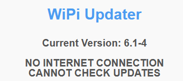

Stupid question, I have the Pi hooked to my home router and in "home wifi" mode. It pulls an IP and I can access from any computer, but when I try to update I get the there is no internet connection message. Is there something else I need to do to give the pi access to the internet?
Besides a working static ip you need an getaway (= router) and DNS (= router ip) . If you can't get it working by the ui: you can always login over sshd to your wipi - it is just a dietpie linux installation - and configure stuff there.
