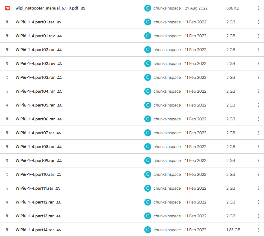

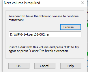

Need a bit of help here, I can't find this specific file.
That's weird, that volume doesn't even exist.
How are you extracting the files? Assuming you downloaded all the files (don't need the .rev ones iirc), then used winrar or 7zip to extract the image from the first file WiPi6-1-4.part01.rar?

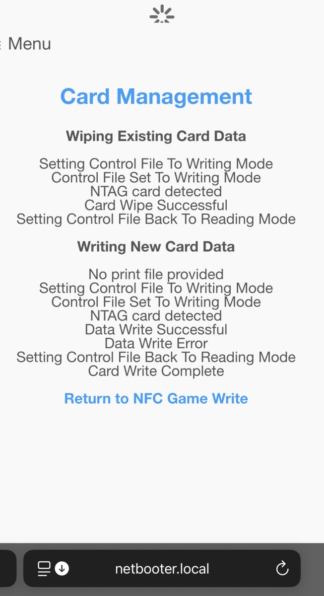

I got an NFC reader and hooked it up to the Raspberry Pi 4 but I am not able to switch games while playing a game.
My goal is to be able to either get to the OSM or switch games directly when tapping on the NFC.
I have connected the NFC to all 4 USB ports already. Wipi is setup that when it boots it goes directly to the OSM. In the web interface I have written the NFC cards. The reader/writer wipes the image successfully, then writes it successfully but also says “write error” afterwards. When I read the card under card management I can see that the information was written on the card.
Whenever the tap the card while playing a game, I get the beeps but the Naomi does not stop the take and goes into the loading screen.
The only time I was able to load a game through the NFC was when I loaded Initial D and had the C/W error blinking for about 10 minutes. After that I got back into the white loading screen. Then I tapped the card and I was able to load a game.
What are the settings I need to have to make this work?
Would like to get this to work too but first I just want to be able to switch games using the NFC.

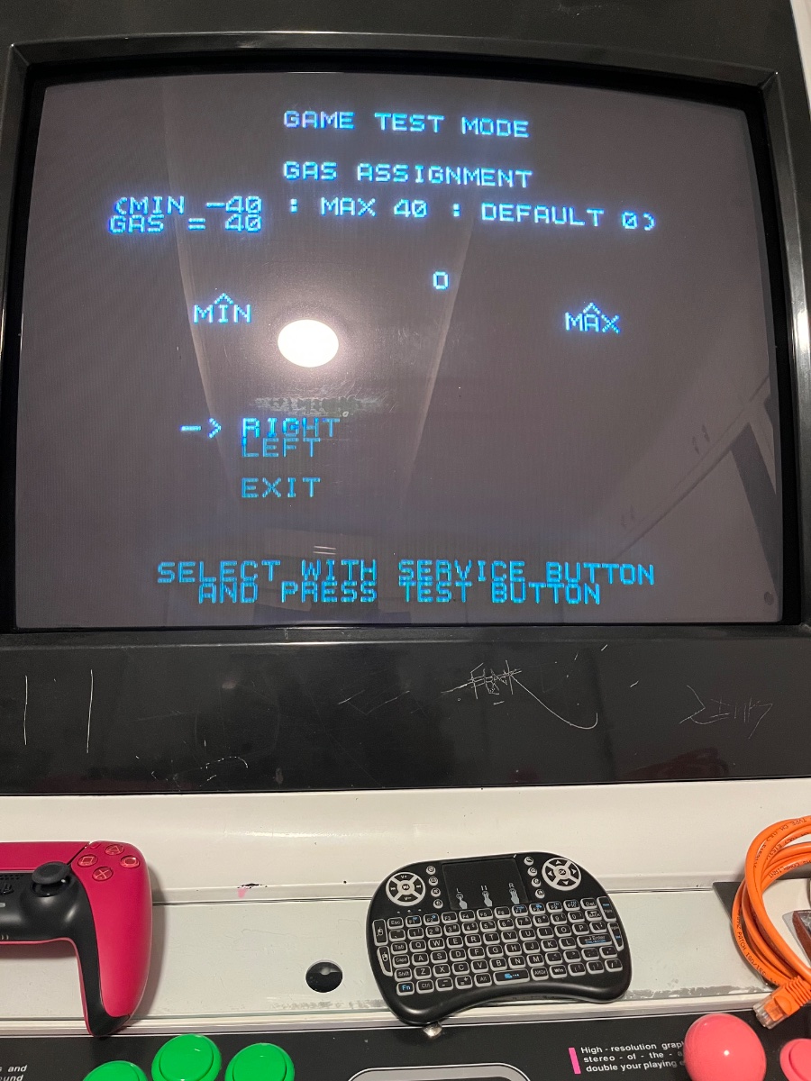

Thank you for the help. In which setup do I go? On the browser in netbooter.local or in the test menu of the Naomi?
I was able to get to the test menu and setup the gas paddle however, I am not able to reach MAX. I set the acceleration all the way to right to +40 but still I am not able to reach MAX.
What else can I do?
Is it much better than before?
I would say in a way. But this speed does not let me play. The cars in the front are gone and I am not able to even keep up with the countdown of 40ish second. All the cars are long gone and the clock just ticks down. How can I get max speed?
