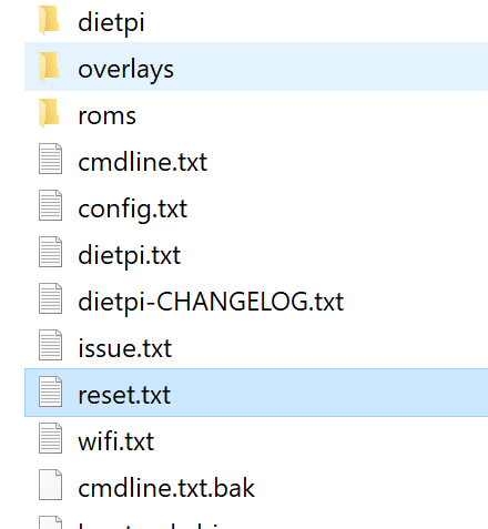

what did you use to write it ?!
I tried Etcher and Win32DiskImager...
if you open your microsd on a computer, do you see multiples files?
Yes I see two partitions. The first boot with folders and files and the second won't let me log in from windows.
if so can you write a blank "reset.txt" file in the root and boot again (only the pi) to try again?
Yes I added empty reset file and restarted Pi but from mobile wi-fi search still can't find anything...
ok these works and I see your files so you really should be good to go.
Weird that you're not seeing the wifi. In your shoes I would question the wifi on the Rasberry pi.
Do you have a wifi usb dongle you could plug in it and try again? or another pi perhaps?
This is what I would recommend - I have had a rpi where the wifi hardware just died....

I checked if there was a fault in the wifi card, for testing I rewrote sd with Raspberry Pi OS image and enabled connection to wi-fi router and it worked.
here is what i do:
1) I turn on Naomi+Netdimm ( IP address 10. 0. 0. 2)
2) I connect network cable (Naomi+Raspy).
3) I turn on the Raspy (Power 5v 3A 15W).
I see the 2 Leds flashing, then from smartphone I search wireless network;
By default, WiPi Netbooter is set to Hotspot Direct mode but can't find.
where do i go wrong? Can I interface via SSH with Putty from PC? No HDMI signal with monitor from Raspy.

Don't know why but i had the same issue as you.
I use the wipi several times in the past and never had this issue, but this time with 3 rasp i had this issue....redid the sd card several times with no avail...
Then i get the 8gb image and that one worked...
So i then use the normal (bigger) image to get the additional files from and i simply mixed both sd card (the 8gb and the bigger).
In that way i got a functional complete sd card.
Hi glstar
I was finally able to detect the WiPi-Netbooter network.
I confirm what you say the large 32Gb image does not detect the network, I solved it by creating the 8Gb one then with Partition Wizard I moved the EXT4 partition to the end of the SD memory, extended the FAT32 partition and finally added the roms. I have not checked but I think it is not necessary to do the image mix, the files are the same.
