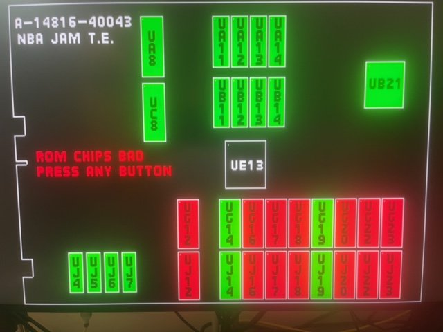

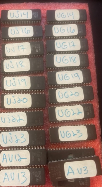

well, I've burned 16x M27C4001:
with these files:
l1_nba_jam_game_rom_ug14.ug14
l1_nba_jam_game_rom_ug16.ug16
l1_nba_jam_game_rom_ug17.ug17
l1_nba_jam_game_rom_ug18.ug18
l1_nba_jam_game_rom_ug19.ug19
l1_nba_jam_game_rom_ug20.ug20
l1_nba_jam_game_rom_ug22.ug22
l1_nba_jam_game_rom_ug23.ug23
l1_nba_jam_game_rom_uj14.uj14
l1_nba_jam_game_rom_uj16.uj16
l1_nba_jam_game_rom_uj17.uj17
l1_nba_jam_game_rom_uj18.uj18
l1_nba_jam_game_rom_uj19.uj19
l1_nba_jam_game_rom_uj20.uj20
l1_nba_jam_game_rom_uj22.uj22
l1_nba_jam_game_rom_uj23.uj23
and the following 3 to the audio board
M27C4001: nbau12.u12 and nbau13.u13
D27C010: l2_nba_jam_u3_sound_rom.u3
installed on a NBA JAM board.

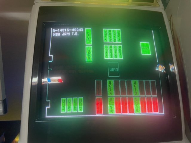

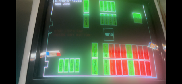

This means the UG12 and UJ 12 are from NBA JAM and not NBA JAM TOURNAMENT. ( is that my issue?)
....and roms are red :

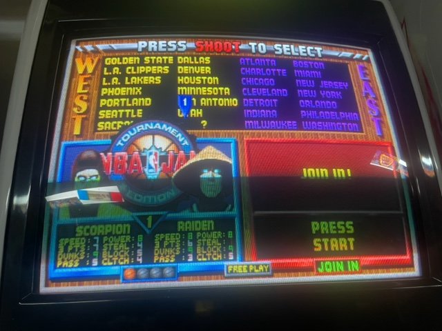

and the game "works" but has severe grfx issue
with roms being ok :
i:\candy\roms_patches\rewind4jam_v1.1\l1_nba_jam_game_rom_uj16.uj16.
ID check skipped
Verifying... Code Buffer
Device is verified
Elapsed time: 64.97 seconds.
.. I have taken the files from the rewind4jam_v1.1.zip and copied them into nbajam.zip and tried them in mame (249 .. in a cmd prompt as mame249 nbajam to load ignore CRC errors) ... and I get the exact same thing? so my rom burning was ok I guess?!
anyone else?!
edit: This means the UG12 and UJ 12 are from NBA JAM and not NBA JAM TOURNAMENT. ( is that my issue?)

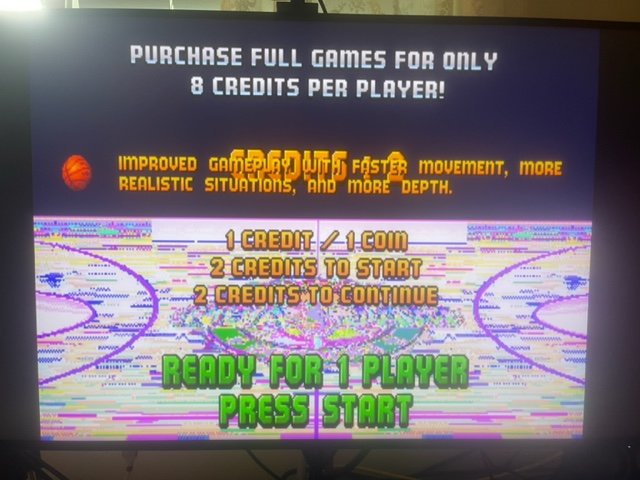

yup ... that is part of it. Dumb me. if I take UG12 and UJ12 from the nba tournament rom set, it works better but not really:
the attract mode is ok but if I insert credits, half the screen is giberish ...if I wait for the attract to kick in again, it will clear it and eventually crash with:

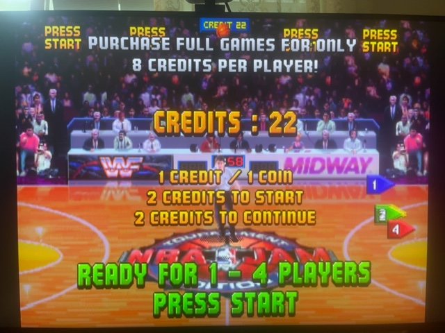

I've downloaded beat and applied the bps to UG12 and IJ12 in nba tournament 2.1 :
with the same symptoms:
inserting credits:
attract mode:
...and it crashed and exit.
Still, I burned the UJ12 and UG12 to try on the hardware and yeah ... these roms/patches are not working for me with a NBA JAM board. The game does coin up but you are not able to start a game, there are grfx issues, reboots, etc.
I tried!
