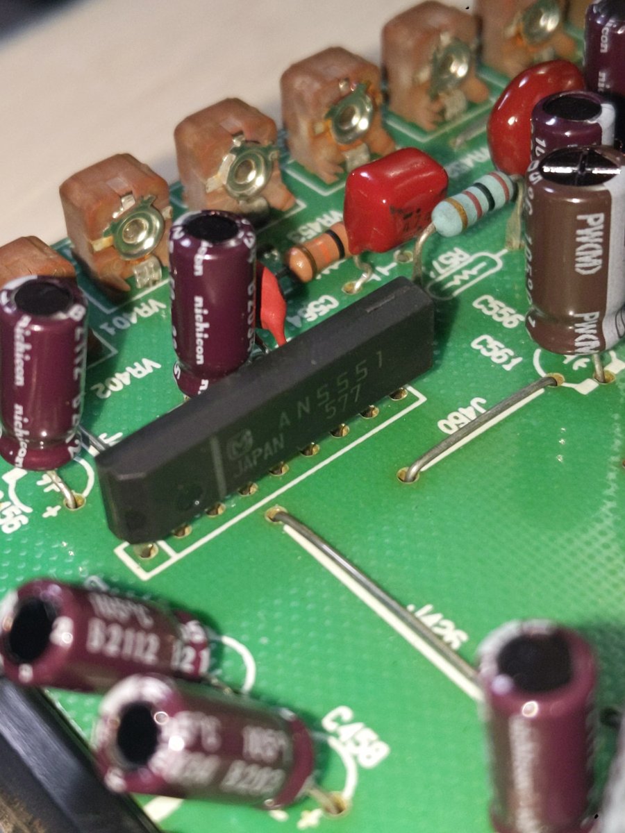

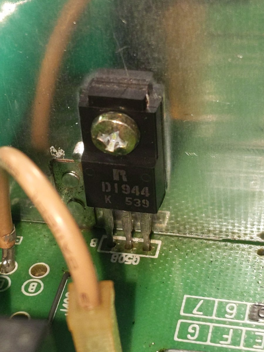

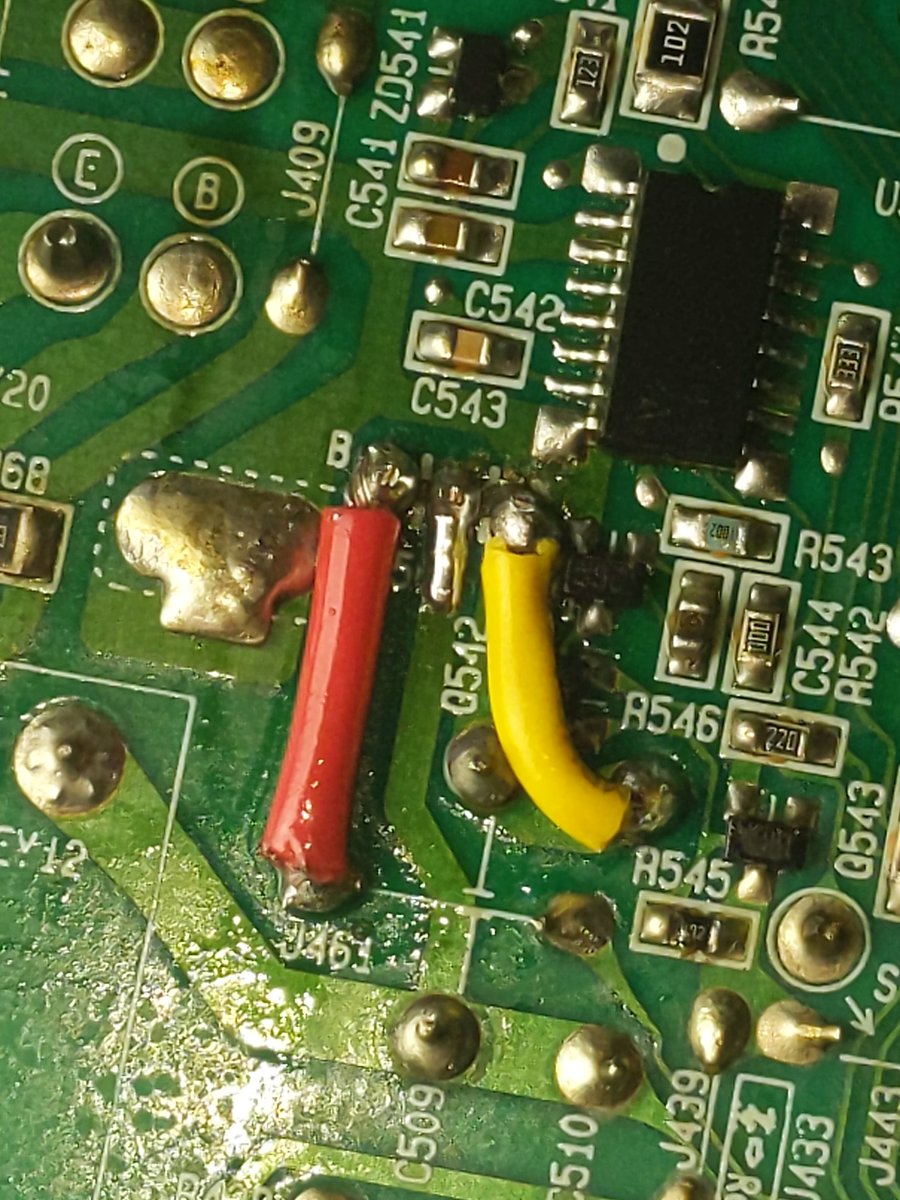

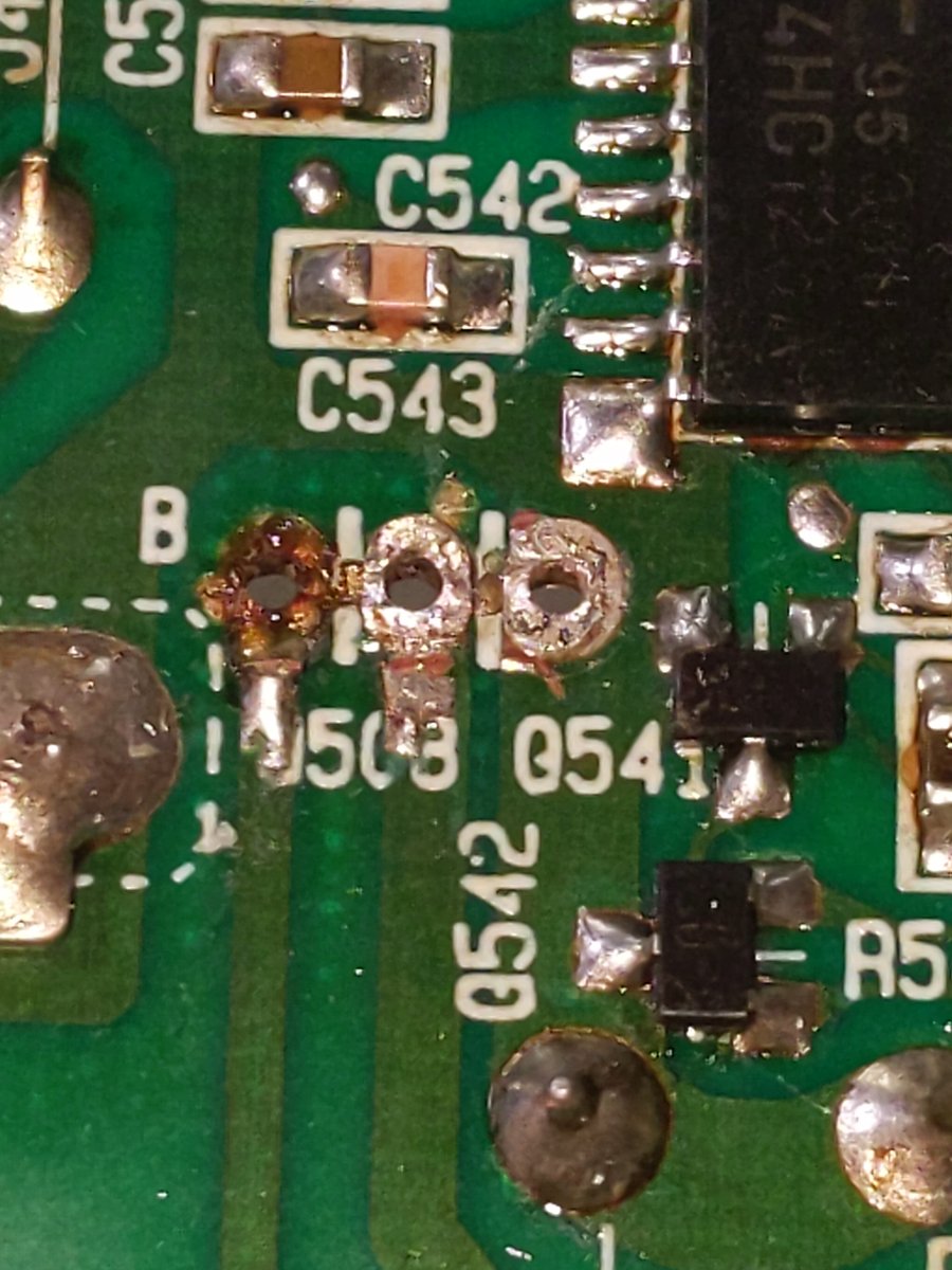

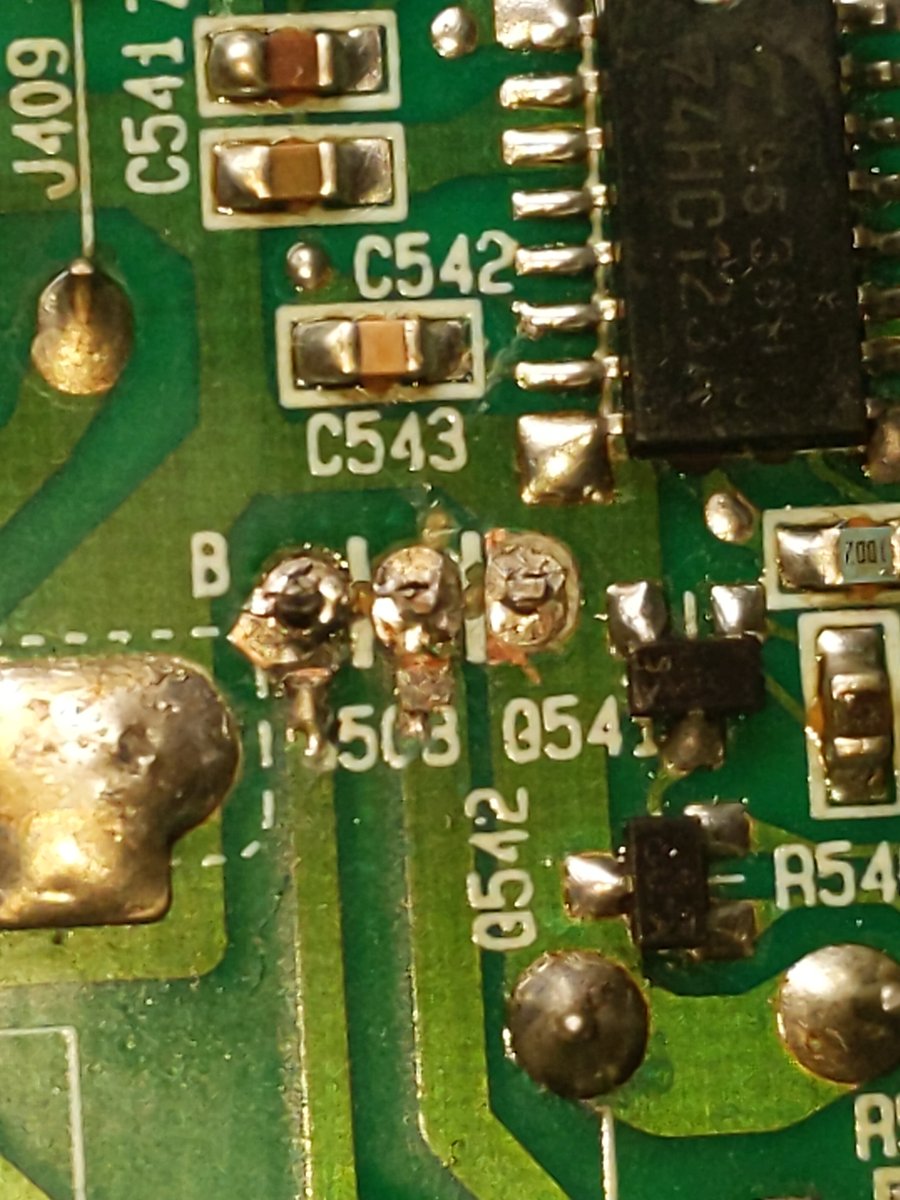

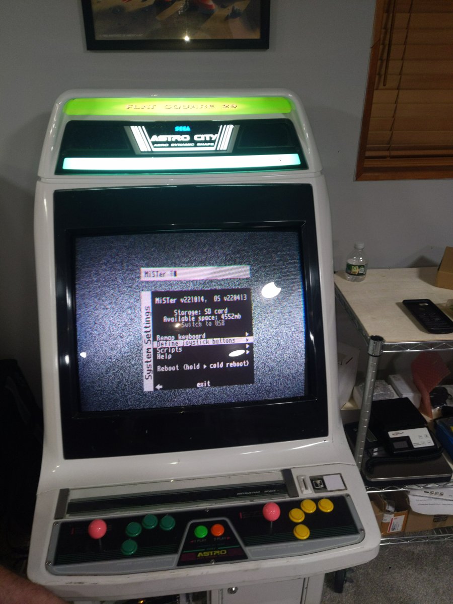

Finally got around fixing the chassis for @RetroRGB yaton Astro. Original issue was not horizontal size control and foldover on the right side. Played it safe and changed out u450 the AN5501, the pots on the remote board, and Q508 2SD1944. The pads on Q508 were terrible, one fell off and two of them were hanging by a thread. I patched that up in addition to all the other work and finally got this chassis fully working.
Thanks for following up. I’ve been wondering how this went. I’m glad to hear he’s got a working cab!
