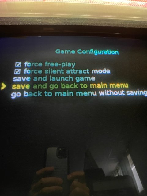

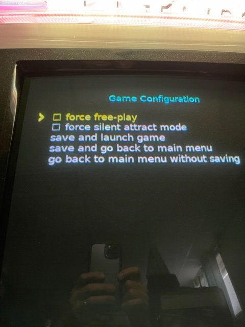

A big update!
There is now a configuration screen in the menu! If you are on the main game list and press [TEST], you will see the configuration screen. It lets you enable/disable analog controls, change the region your cabinet is set to (purely for name display out of the ROMs), change between loading the name of the game from the ROM and using the filename, and analog control calibrations. The calibration screen makes the menu navigation way better on my Monkey Ball cabinet! These settings are saved on the PC or raspberry pi you ran the menu from. So once you set up the menu it should work forever after that.
I also worked on the animations a bunch and optimized the heck out of the text display and as a result the menu is smoother on both vertical and horizontal setups. Vertical setups get a lower framerate because more games can fit on the list on the screen! Oops! But it is good enough for now. I've done a lot of bug fixes and optimizations for the menu to run faster and better and it definitely feels a lot better than yesterday.
I also laid the groundwork for editing game settings (eeprom contents on boot, patches). If you hold start instead of just pressing start, after 1 second it will enter the game configuration menu. I chose this instead of some other button because you might end up on a cabinet with limited buttons. Anyway, there is no code for displaying the game settings so if you do this it will just display "Loading settings..." forever while you get bored. I'm going to work on this feature next however!

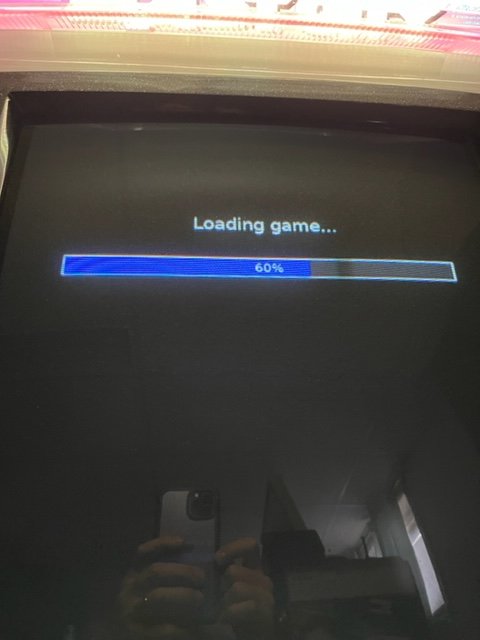

Okay so I just pushed some updates! The following has been added or updated in the latest version:
- Proper centering of text. Centered text used to be eyeballed and now it looks a lot better.
- Bumped the timeouts for various communications by a few seconds, since I was running into a few of them here and there.
- Put an error message in for when your ROM directory contains no ROMs.
- Loading screen! When games load they will display progress on your Naomi now, instead of just sitting on the "NOW LOADING..." screen.
