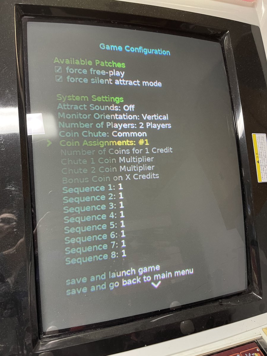

Okay, pushed a smaller update today. There's now a toggle similar to available patches for choosing whether to force system settings or not, and the settings get grayed out if the checkbox is not checked. The bug where games with no settings definition file couldn't apply system settings has been fixed as well, and the settings trojan has been updated to fix reliability issues. I also updated my web interface but I don't think anyone cares about that but me.
EDIT: If you were waiting for a good point to try the netdimm menu, now is the time! I am at a point where I consider it "good enough" and I am hoping for confirmation that it works for others, or bug reports about when it doesn't.
Nice menu !
