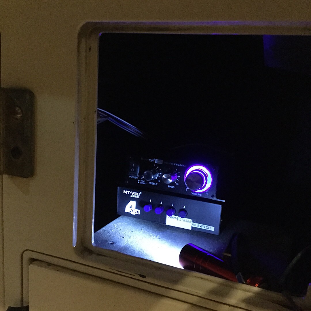

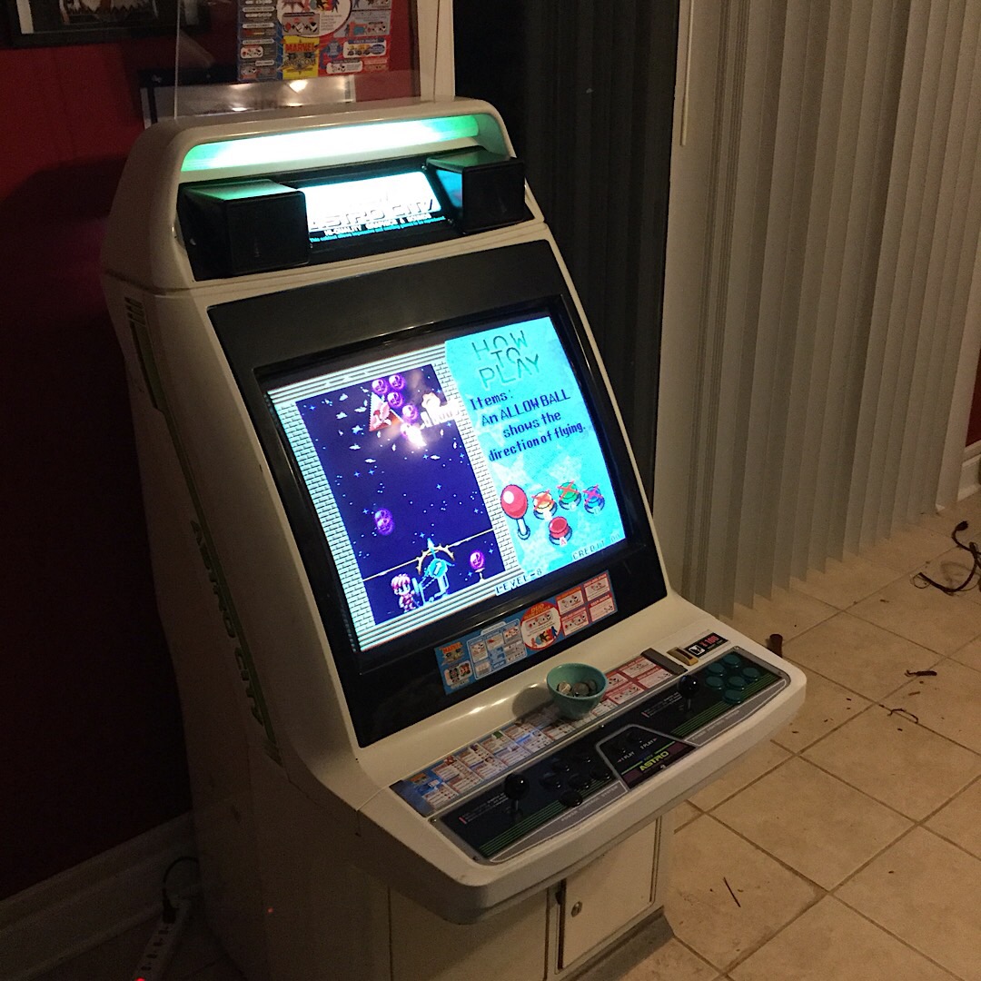

Finally finished painting the speaker housing and installed the marquee kit and some art. Picked marvel/capcom because I think this cab will be home to the cps2 multi for a while. Waiting on my shelf before I put it in here though. Switch and amp fit nicely velcrowed on top of the coin compartment and has plenty of clearance for the coin mech still.

Sounds great to me. I like having the bass and treble knobs to dial it in for each game. As for the instructions I bought some kits for various games off eBay and this one came with one that fits the control panel glass and the marquee and came with that other one so I just assumed it went on the bezel. I used double sided tape. I’ll likely leave that for a year then switch to somethihg else. I also got 3rd strike and ghouls n ghosts. So maybe I put the cps3 multi next time then when the cps1 multi hits I can change to ghouls. I’m planning on getting some blast cabs soon so will get some more art for those. Whatever games I like where I can find repo art I suppose.
How is the sound in stereo now?
Also was it a common thing to Stick the instruction card to the bottom of the monitor bezel in arcades?
Every candy cab that I’ve bought has had instruction cards attached to the monitor bezel, except they’re typically laminated.
Good idea. I have a laminator and didn’t think of that.
