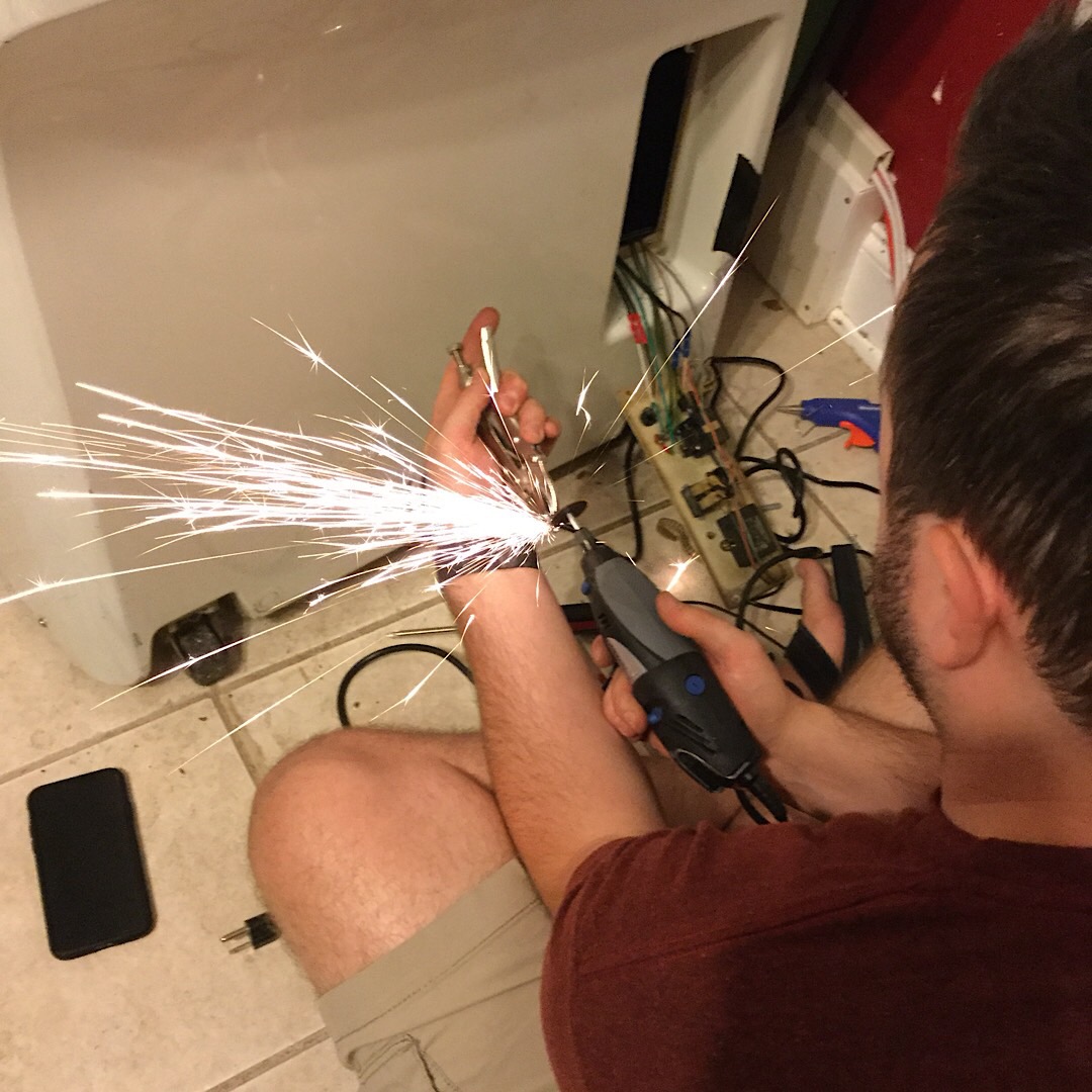

finally got around to working on this. Recapped the power supply as people recommended. I used a jamma voltmeter adapter to get a new jamma edge. One of my friends is good with electricity and he did the recap and reworked my power situation. Got a step down transformer in the cab now. Dielectric grease fixed my noisy volume control. Put in these drop in replacement speakers I am quoting here, sound great. Thanks radiantsvgun! Next up paint the yellow speaker housing and install the marquee kit lions3 sells. Also installed an anycoin. So far so good. Here is a shot of my friend modifying some screws to replace the security ones holding the power plate on the back. Tested a Neo board and rastan, seems good! Thanks for all the suggestions!
