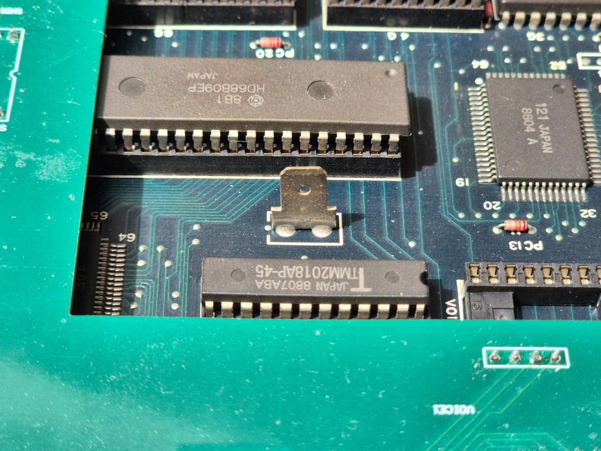

I will upload the instructions today. I have 2 IMPORTANT comments that you MUST remember before installing this multi:
* Separate the 2 PCBs of your Namco system 2 and install the kit separately!
* in the Main PCB, be EXTREMELY careful with some small metal GND connectors that stand out. They change from position depending on the game, so it's difficult to set some standard. you NEED to bend them or remove! otherwise they will clash with the PCB of the multi!
To not create confusion , on the clip , i used my hakko 301 to desolder previously and then i just removed with my
fingers from the pcb …
View: https://youtube.com/shorts/mNki8jdWcsM?si=GJ-wWFCdYddPn3yc
You don't necessarily need to remove if you don't have the tools or the time. You can just bent it towards one side gently using your thumb.
