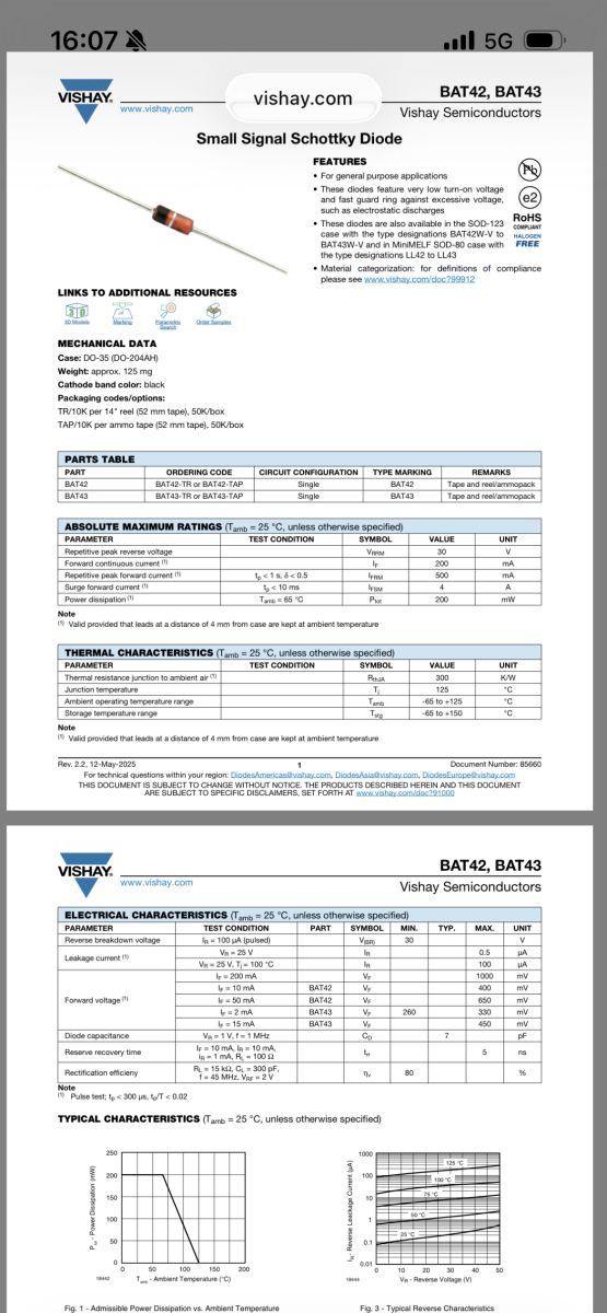

« diode with a Vf <= 0.4V » what does it means ? The Vf should equal or less than 0.4V ?

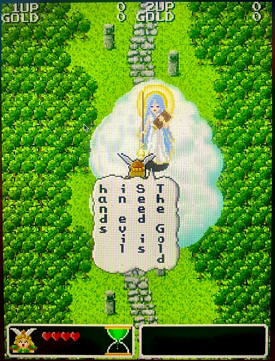

@ekorz bros , can be done some hex moddificiations to have the text writen from right to the left ?
exemple :
- now is in this format :

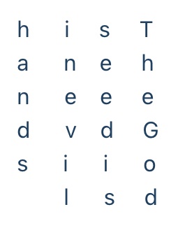

and will be nice if can be this way :
Can be possible to have the text in this order ?
I thought the diode allowed current one way and not the other way and that was all that was important?
Would that explain why Phelios and mirai ninja and not loading / freezing?
exemple :
Yes like @Darksoft said it’s probably possible but it’s a lot of work. The game draws the text top to bottom and right to left, so someone would have to adjust that code and make sure it functioned in all dialogue situations. The original mod was just replacing the gfx references so there’s no existing work to leverage.
It works fine enough for me so I’m not interested in doing it, but it could be a fun project for someone else.

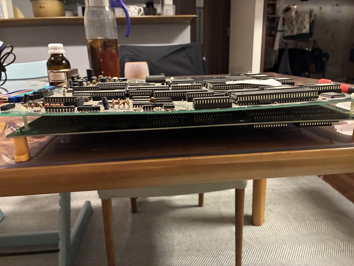

I have some graphics errors on the original game. I will first clean up the board with isopropanol
