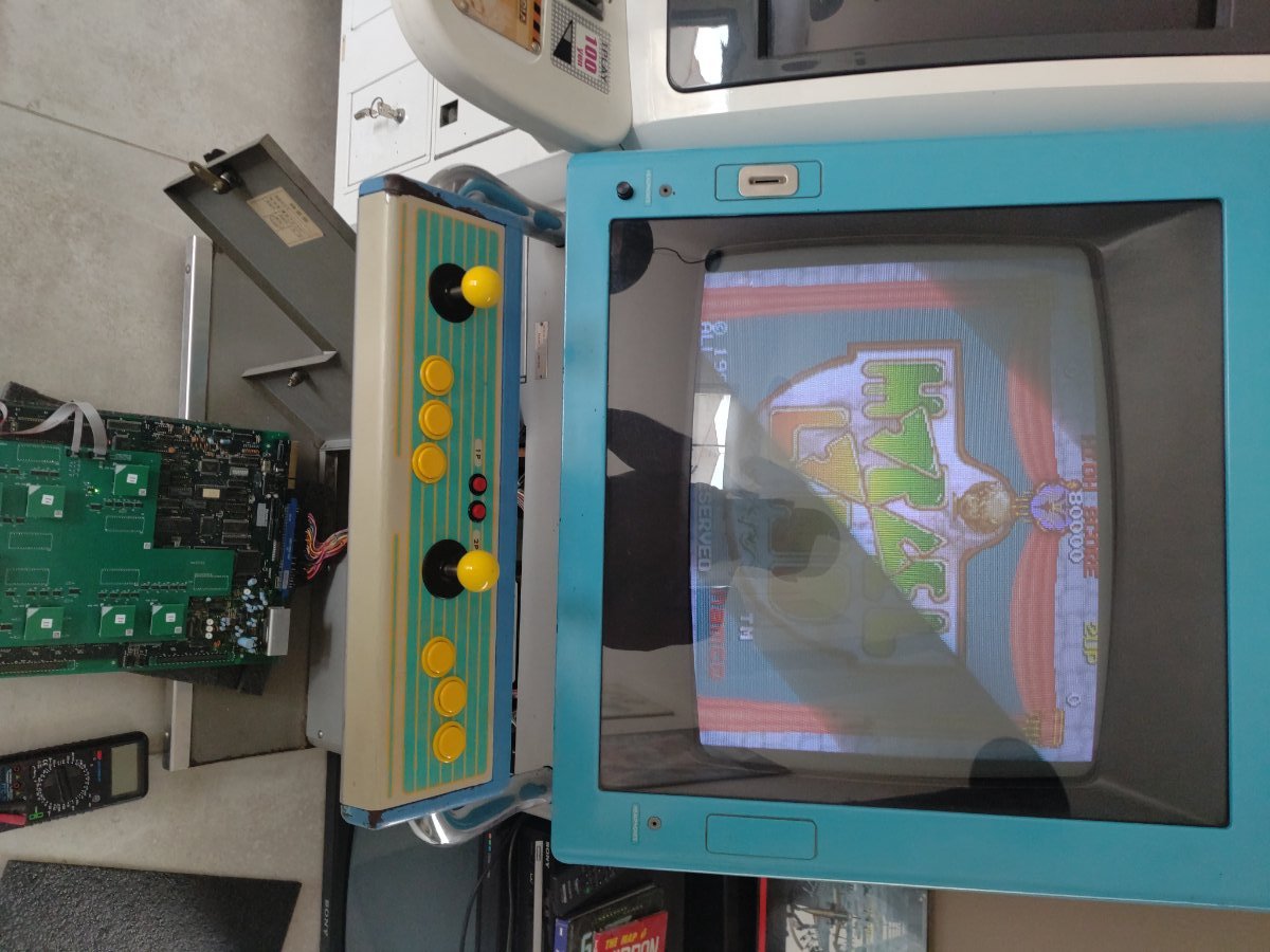

I was able to fix my donor by swapping the cpu board with a cheap mint final lap.
So as a data point, if there's bad ram on your cpu board, or very bodged traces & caps, that can cause random crashing with the multi.
I have yet to recap the final lap which likely needs it and it works fine.

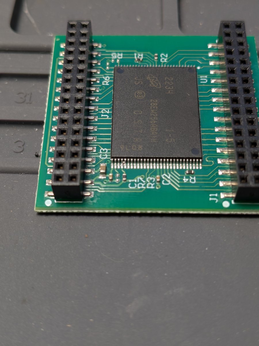

After seeing @Jinyong Kim with a shorted flash module, I decided to check all of mine before flashing and also found a short. I was able to easily fix it, but it is something to keep an eye out for.
If anyone is interested, I'll be designing a 3d printable case for this multi so keep an eye out on this thread :)

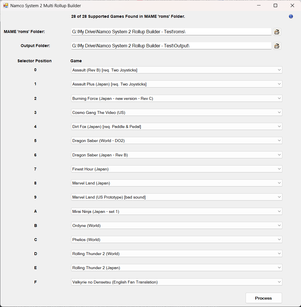

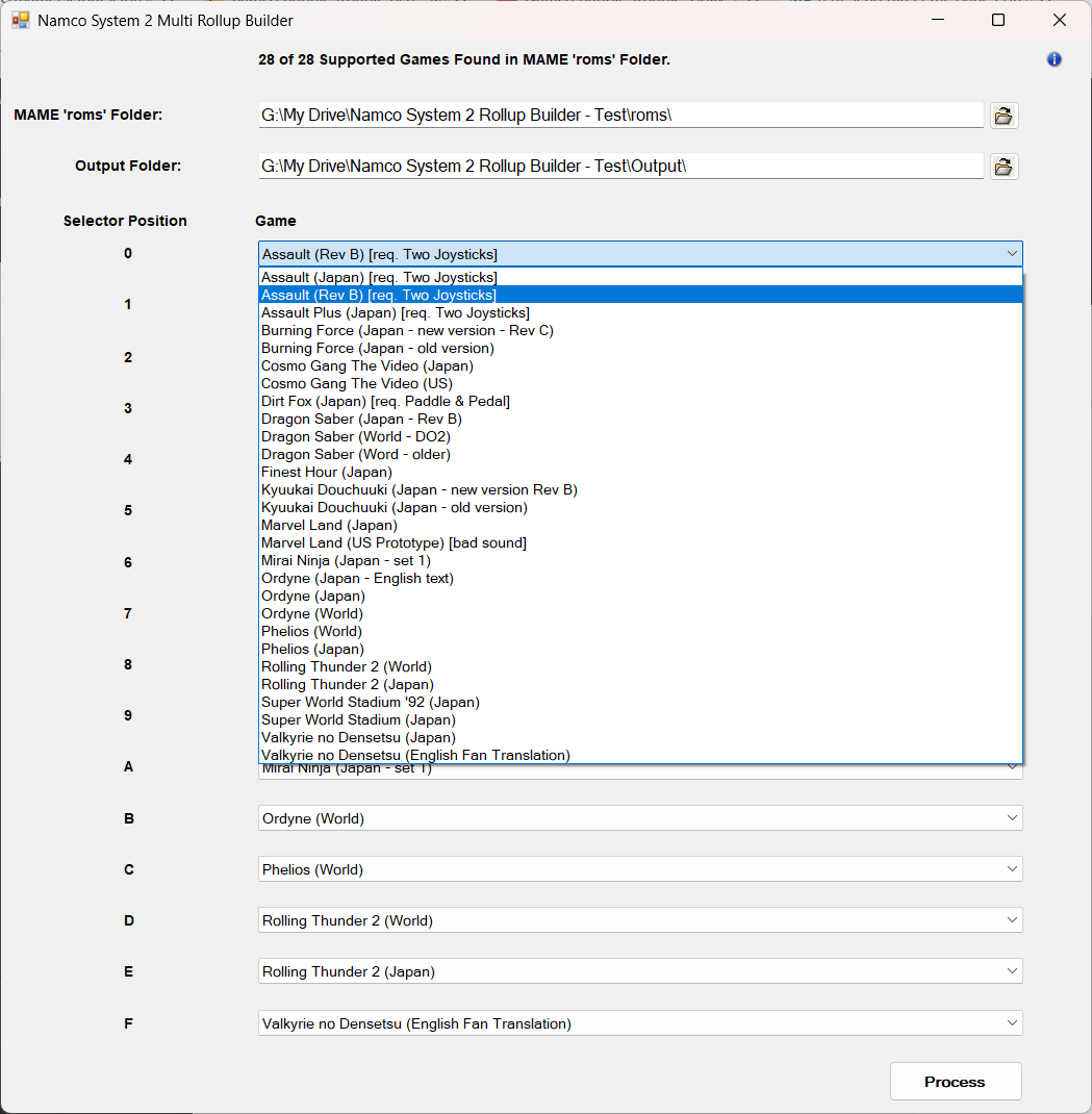

Also, my Rollup Builder tool is very, very close to release - we're just completing some testing on the baseball games. This tool will let you roll your own custom Rollup Pack for your System 2 Multi.

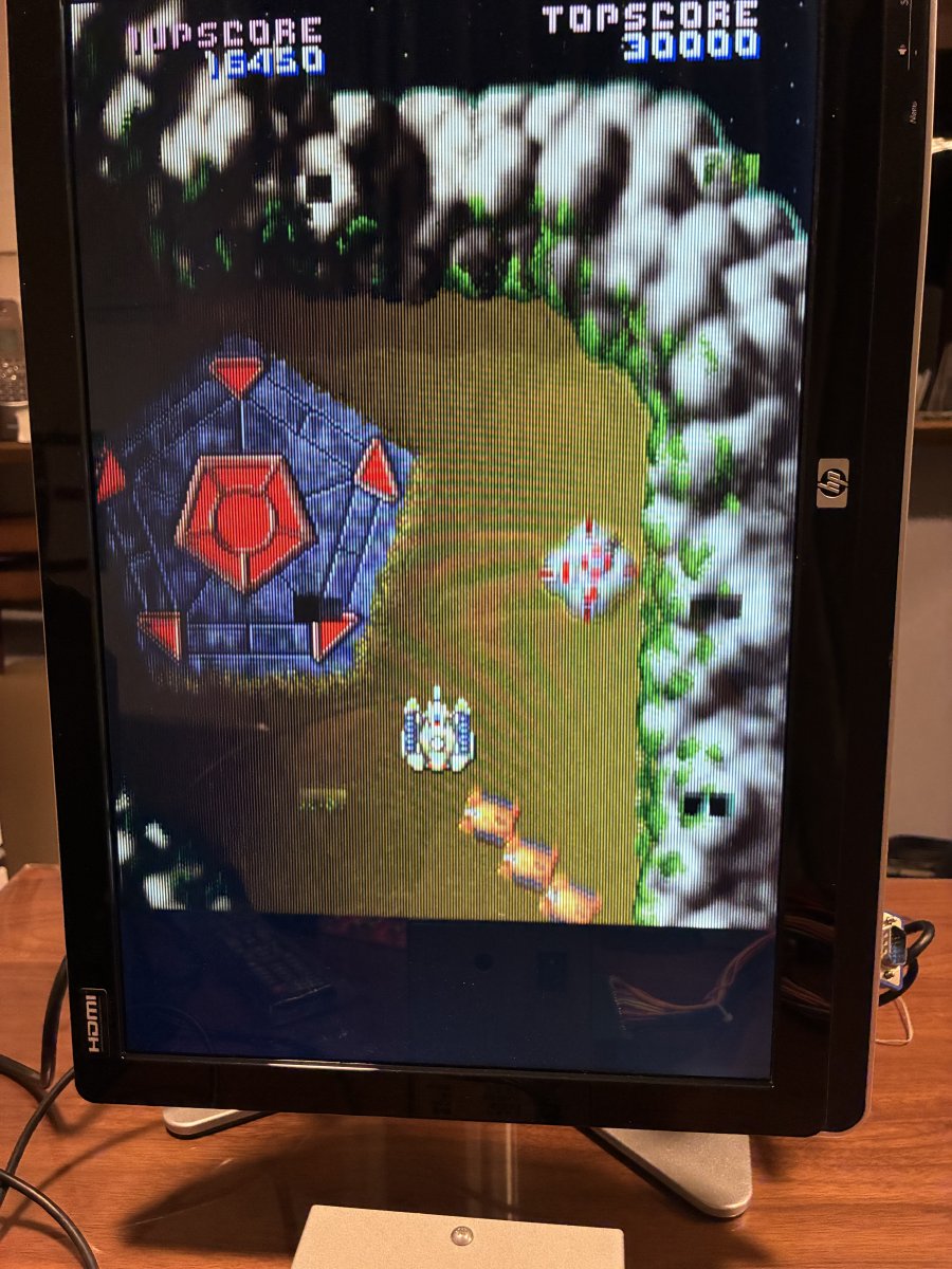

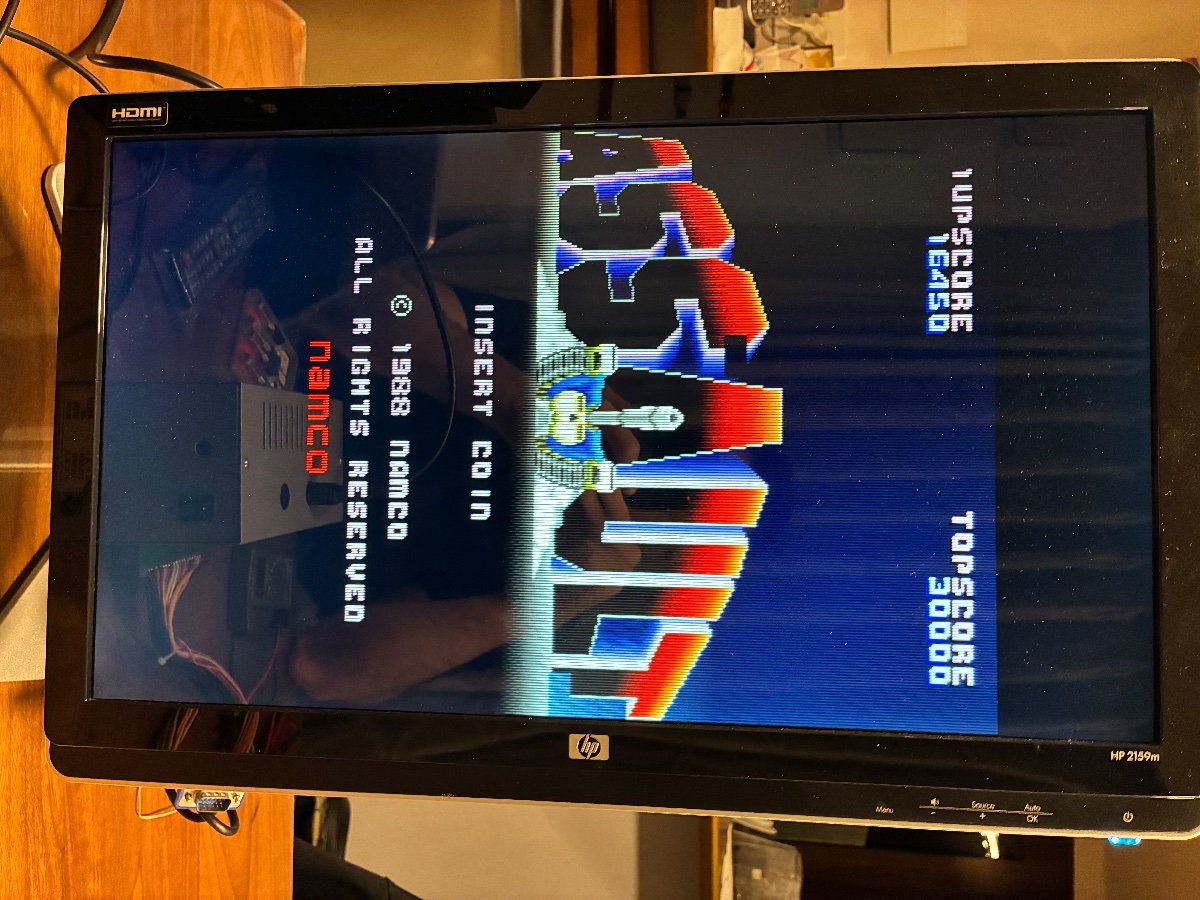

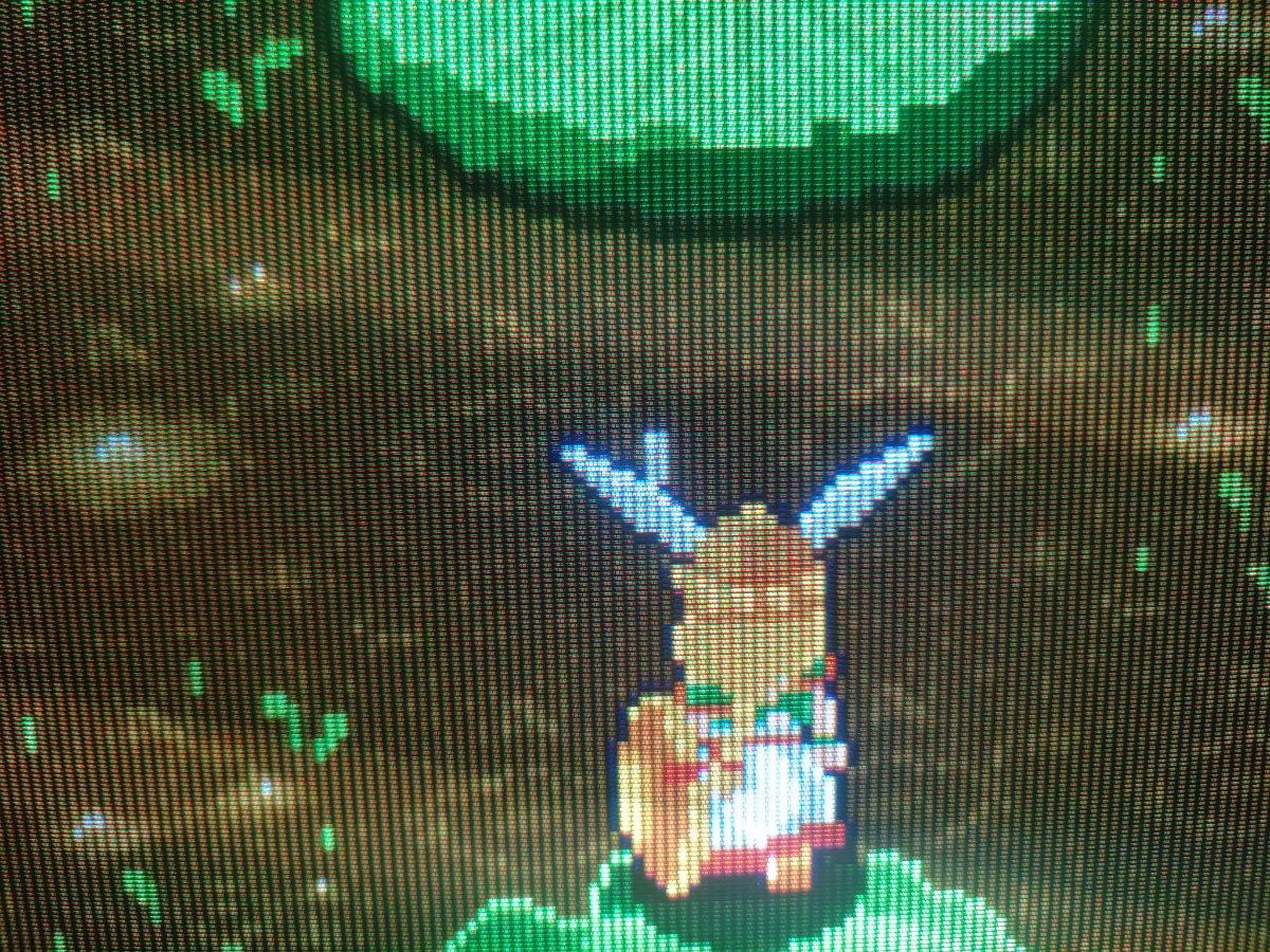

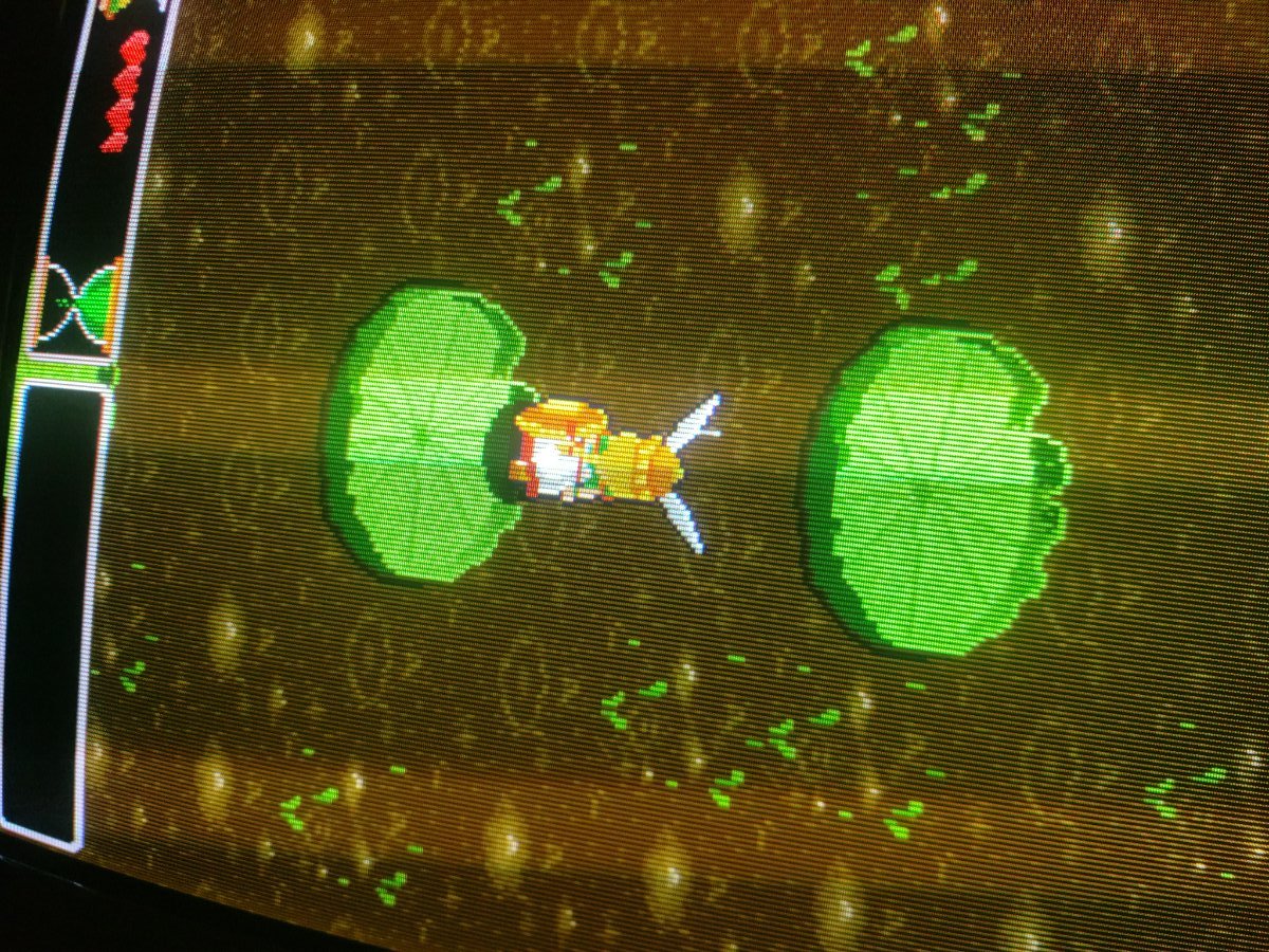

One another thing, I have a little white Line on the sprite of Valkyrie, on top of the left, a kind of glitch.
More I push action button and more ut 's visible.
Does anyone have this glitch too ?
You can sée it a little bit on the pic attached...
Thx guys

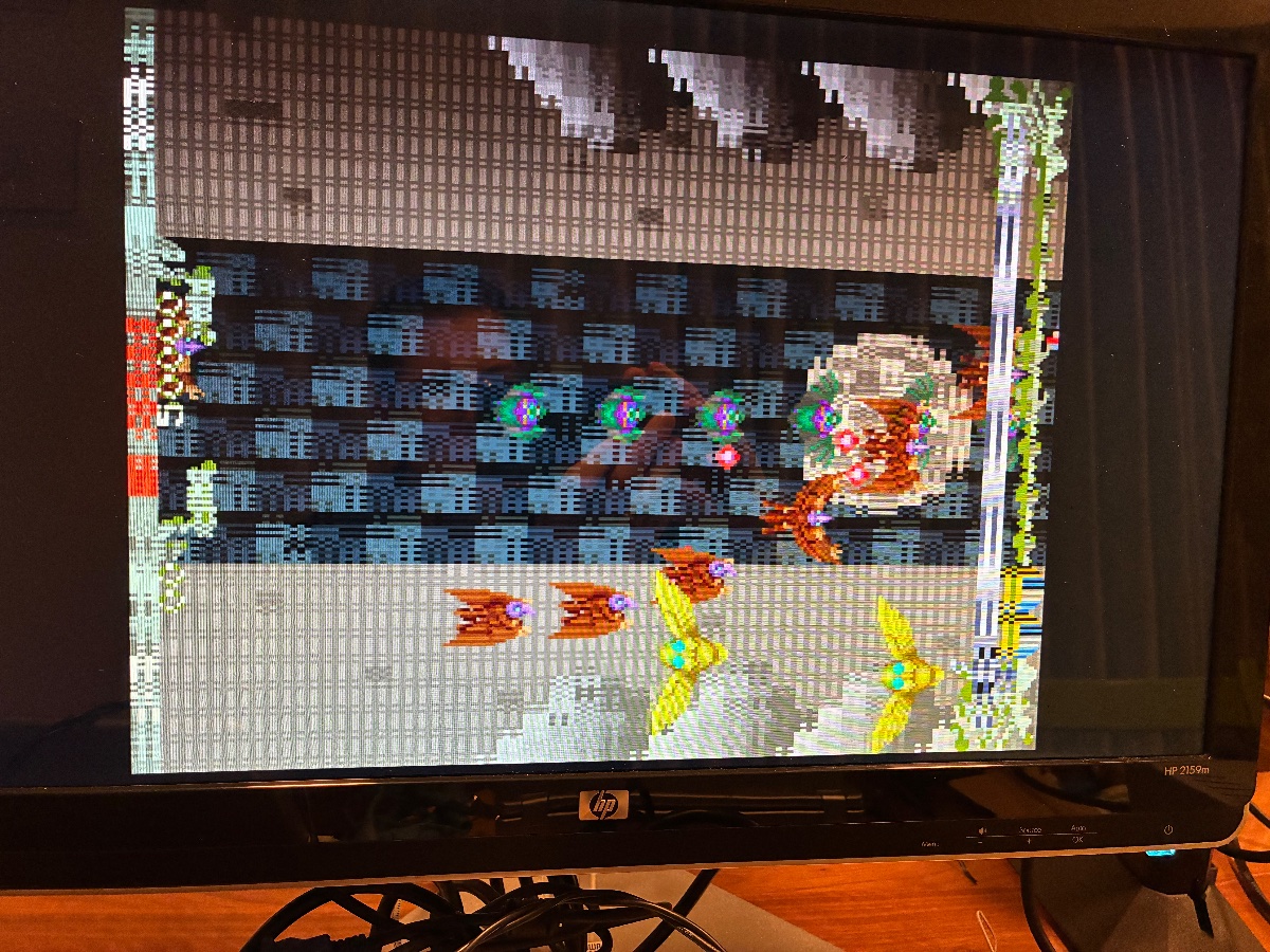

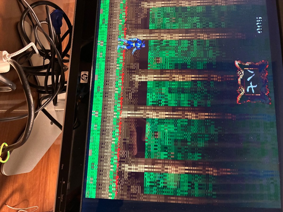

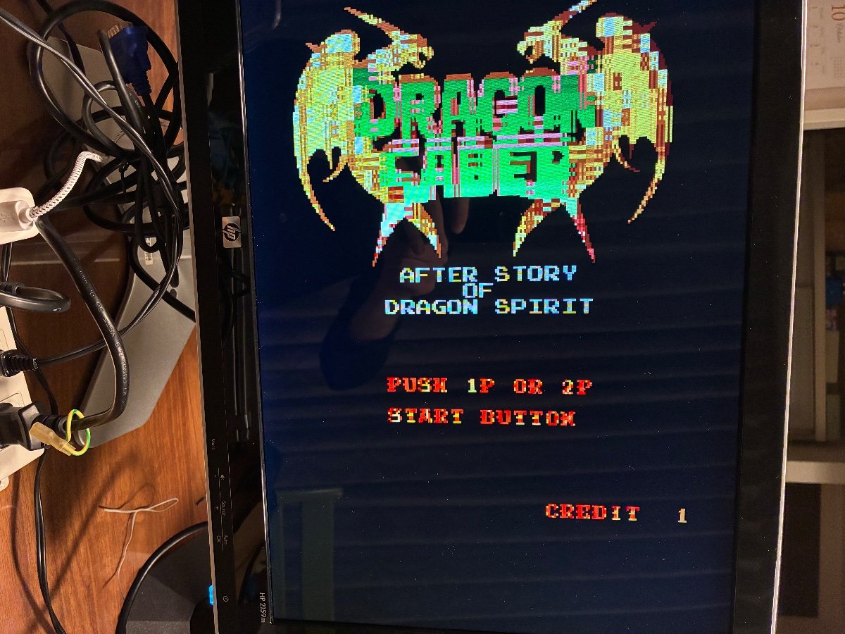

Hi I could install the multi but I have some pixel mess

Did the original game work properly before installing the multi?
Are you sure that all pins of the multi go fully inside and make good contact?
And last check, are you sure that you wrote all modules correctly and they are in the right place?
The original game, didn’t worked properly as i showed upper , some squared glitched appeared. I thought it was minor but apparently its serious. I will first rechecked everything again. Reseat chips etc
As a general rule - the donor should be 100% working before you drop a multi on. It stresses the board a little over the “stock” so you need perfectly working. Hopefully it’s just an issue that reseating a few times will resolve.
Hopefully it will be the ram if it's not that, then most probably one of the 2 SMD custom video chips has gone bad and that is bad news.
