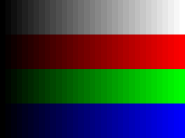

15K shows an picture, but has troubles
monitor menu: 640x240, H 15.8KHz, V 59.0Hz
there's the bottom of the picture on top of it, and a strange duplicate bars in the center.
