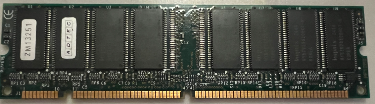

After replacing the big lateral fan the game works, however....here we go again! you can play one game and although the chihiro run without any issues (the green status led is always on) the monitor start showing some interferences.
I thought that it could be the vga cable but after replacing it the situation is pretty much the same, I play one game but after 5' only have interferences in the monitor,i have sound i can press start and play but i can't see a thing. if i restart the game although the sound is there it goes directly into big interference lines as in the pics. If i wait 2 hrs and then restart everything is normal for about 2' (i can see the chihiro loading message in the screen) and then i have the interferences in the monitor again. If instead i switch off the game and i try the day after i can play 1 game no issues but i will have the interferences after 5'. Suspect it is something with the video board maybe overheating...could it be the small cooling fan in the board that was spinning and hence not replaced?
