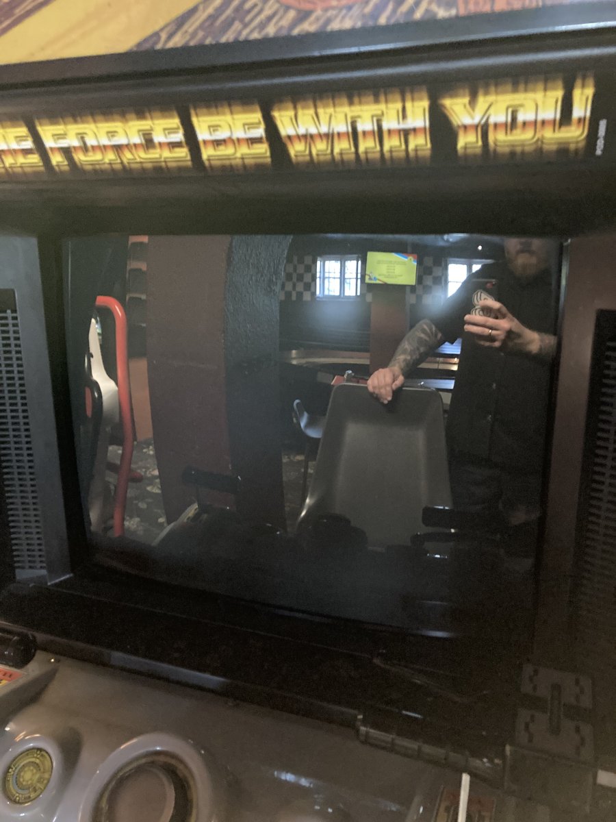

Finally got all the parts I needed to finally complete one of the Mario Karts that had given me major headaches, so it was time to fix the shit out of it!
Was sold as working, but had a faulty chassis, busted speakers and a fubar Triforce unit…

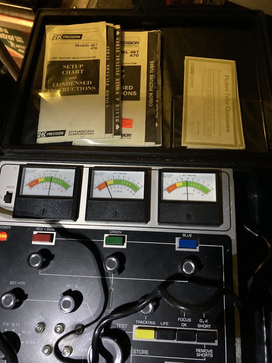

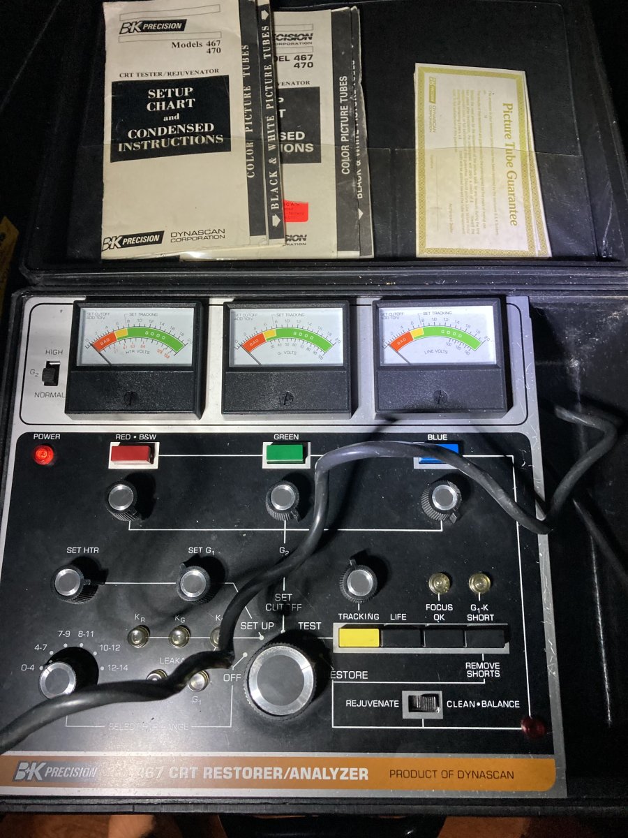

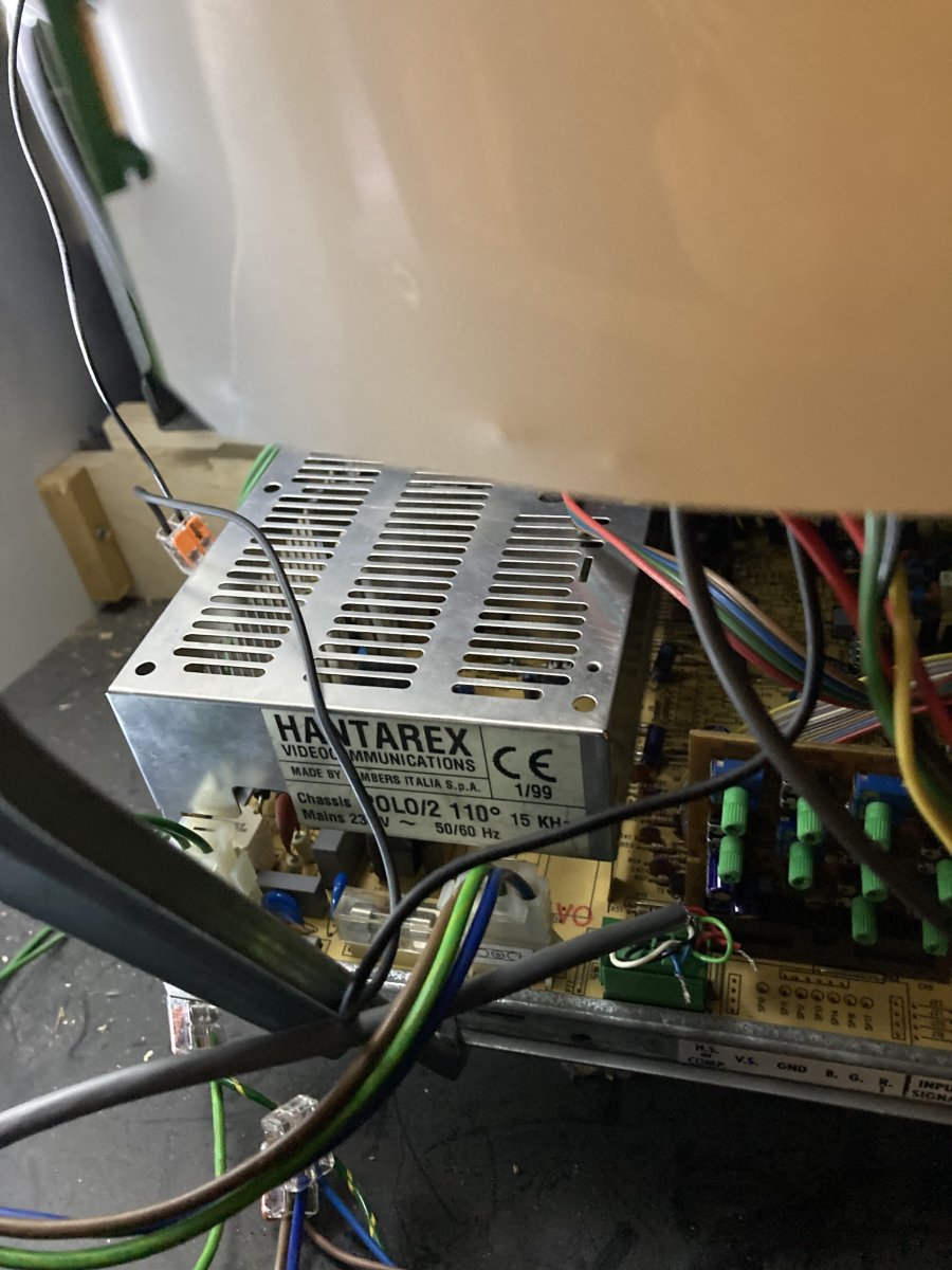

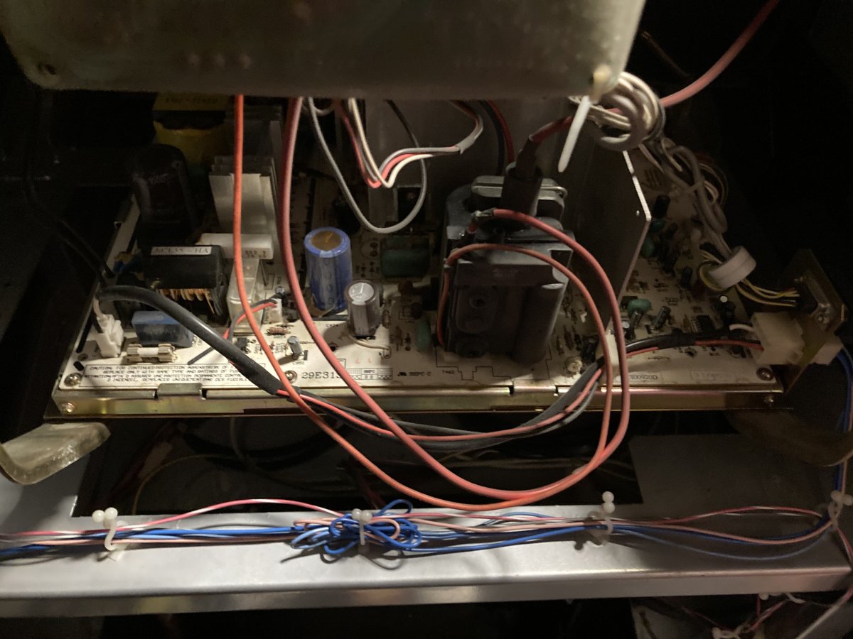

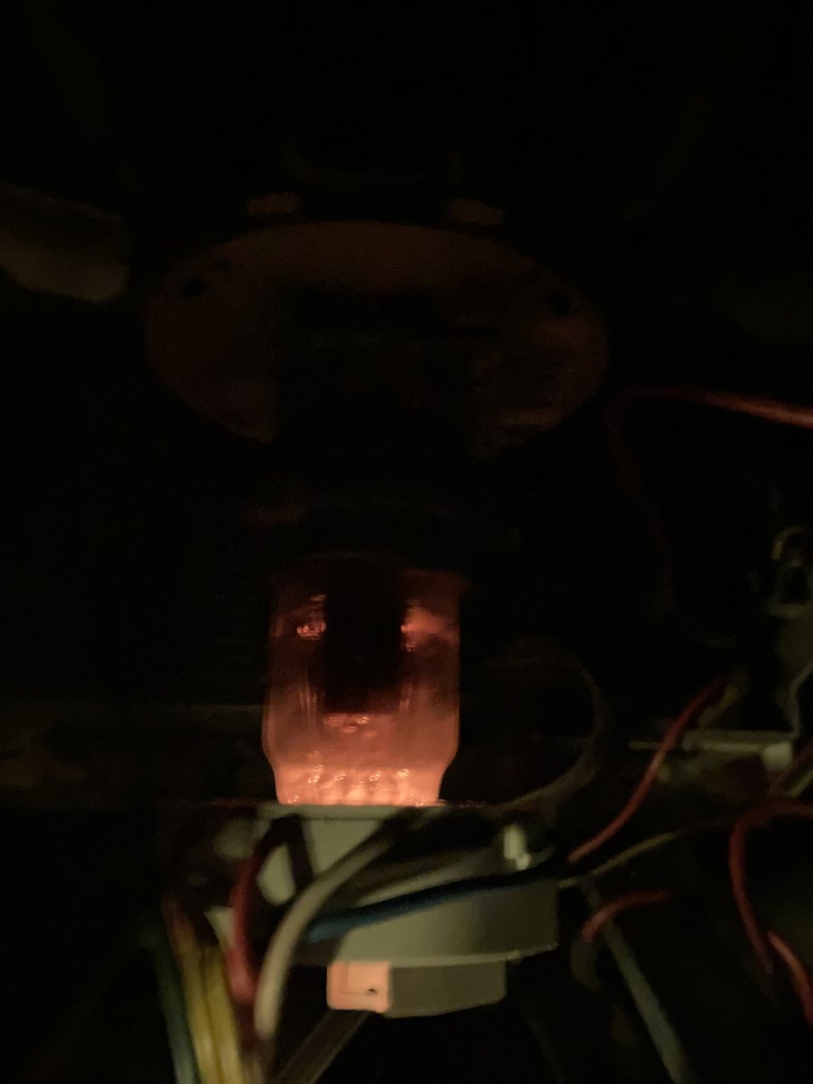

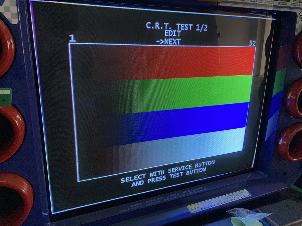

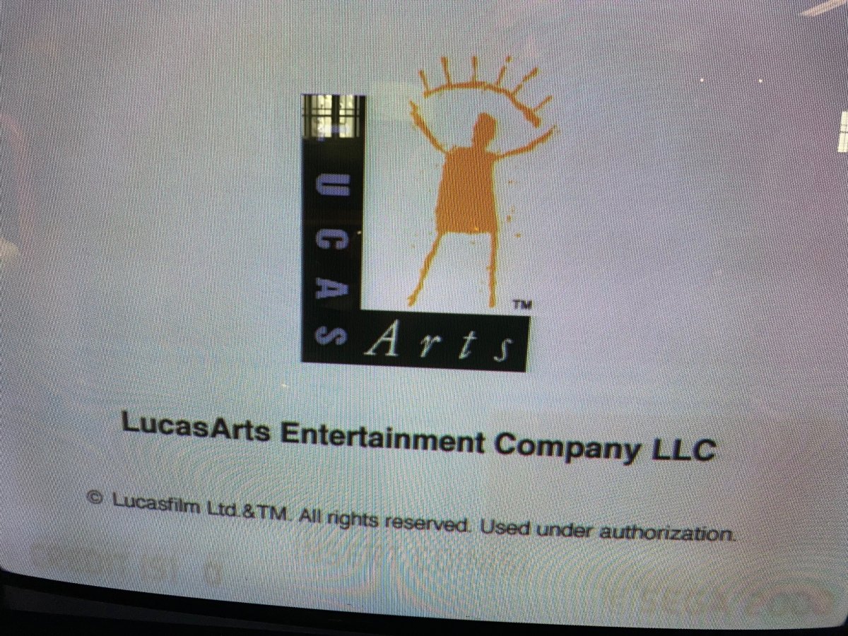

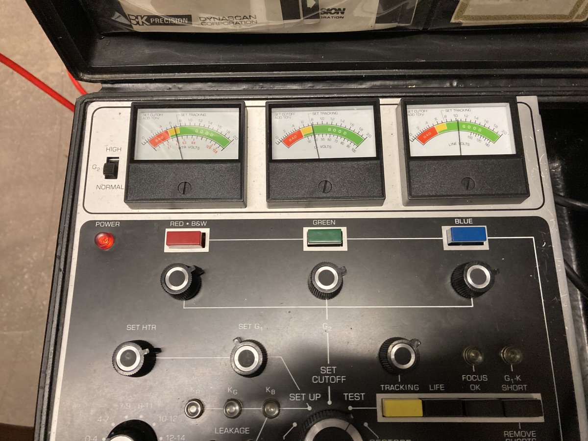

Got a surprisingly clean spare PD1843 chassis from Yaton and some new speakers that I found by accident (https://www.arcade-projects.com/thr...rs-for-mario-kart-gp-2-cab.21179/#post-342156), but hooked it up to my trusty Rejuvinator first just to check the tube.

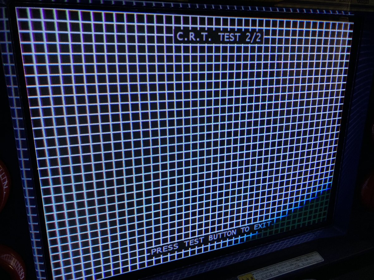

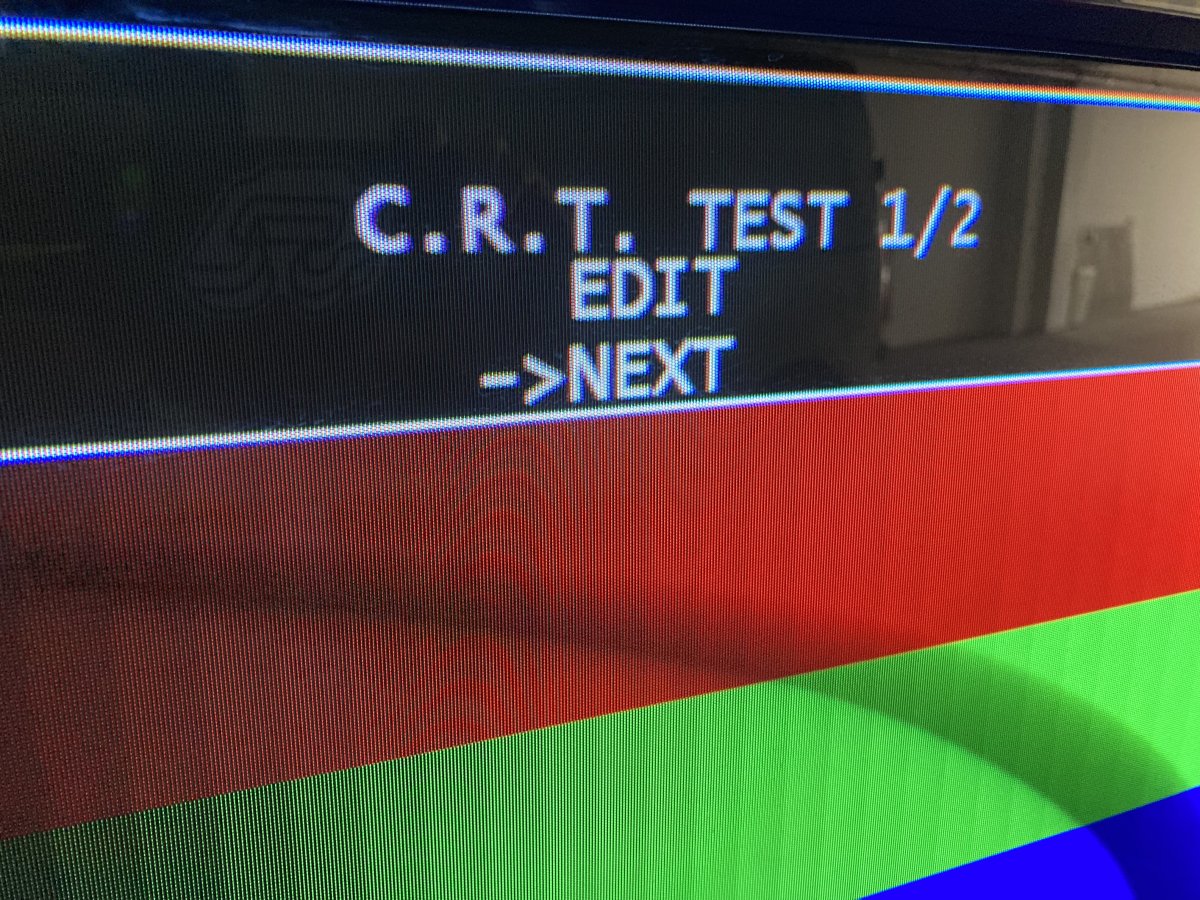

Not at all the results a tube from 2003 should produce, but a quick clean & balance worked wonders! Everything in the green.

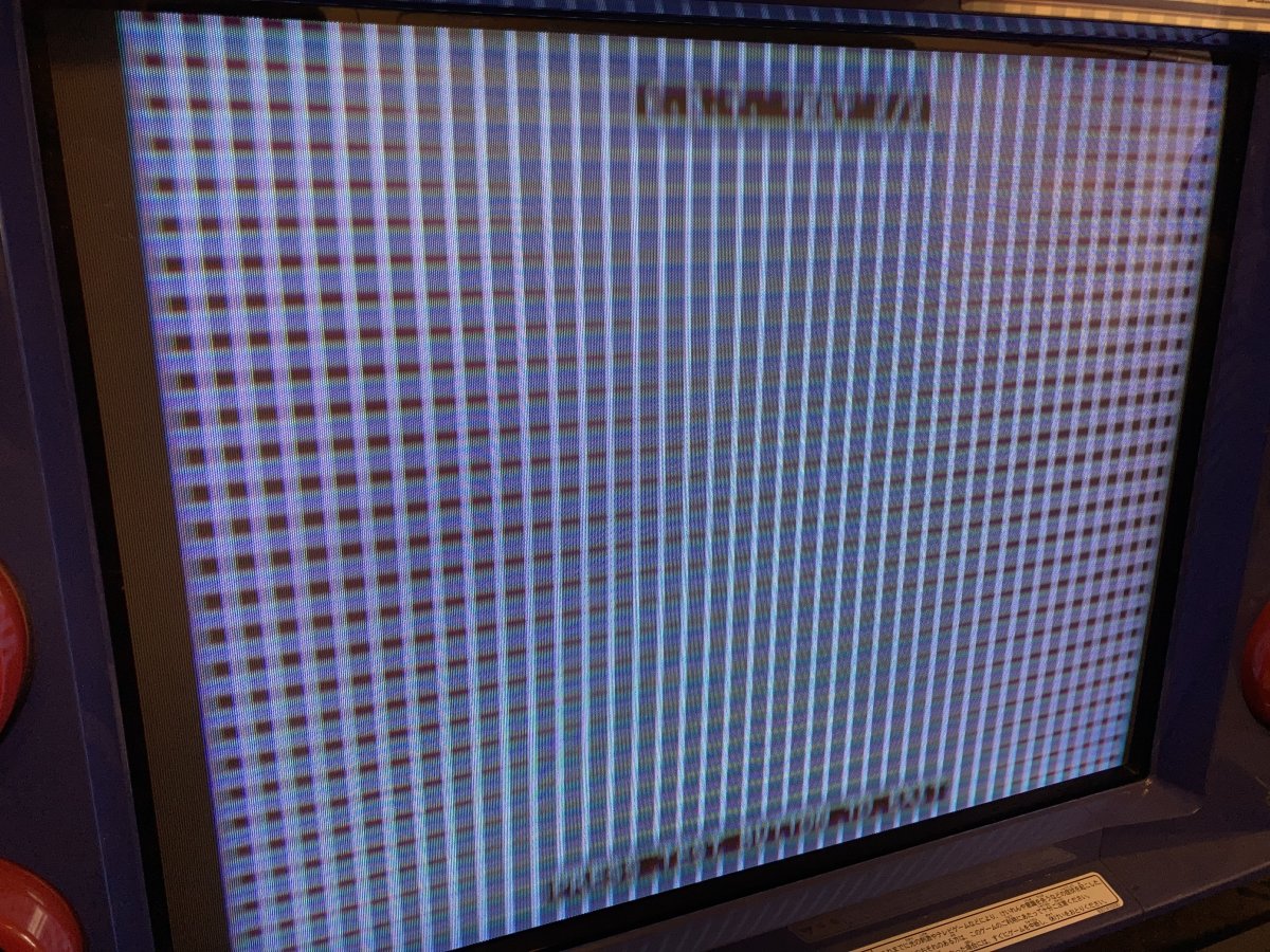

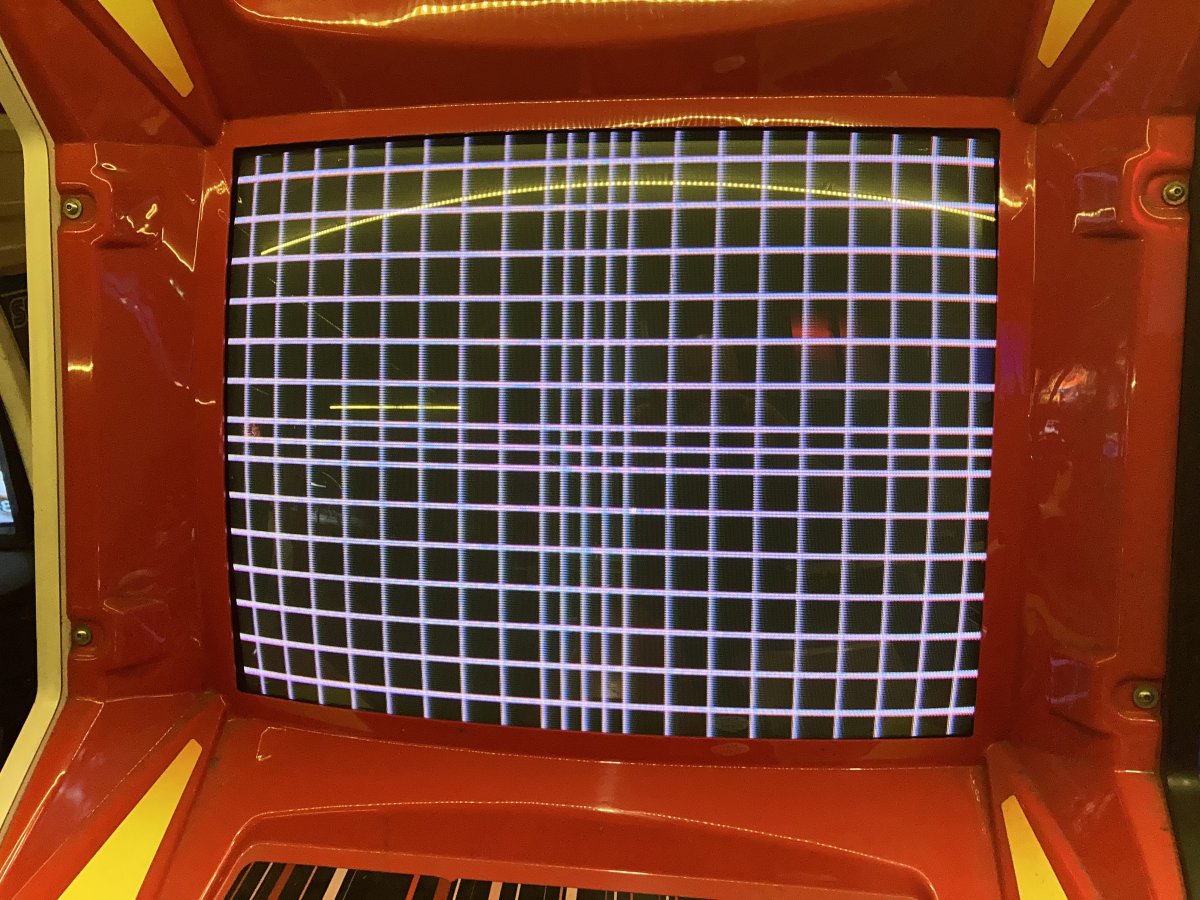

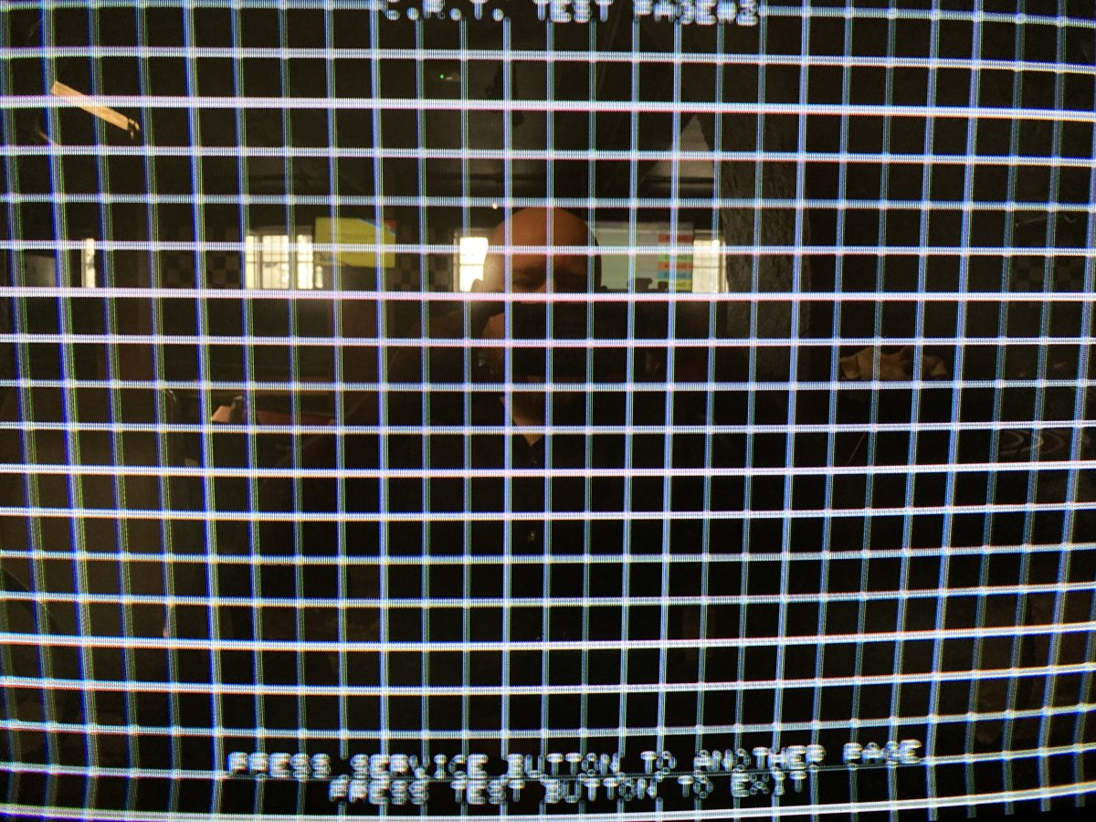

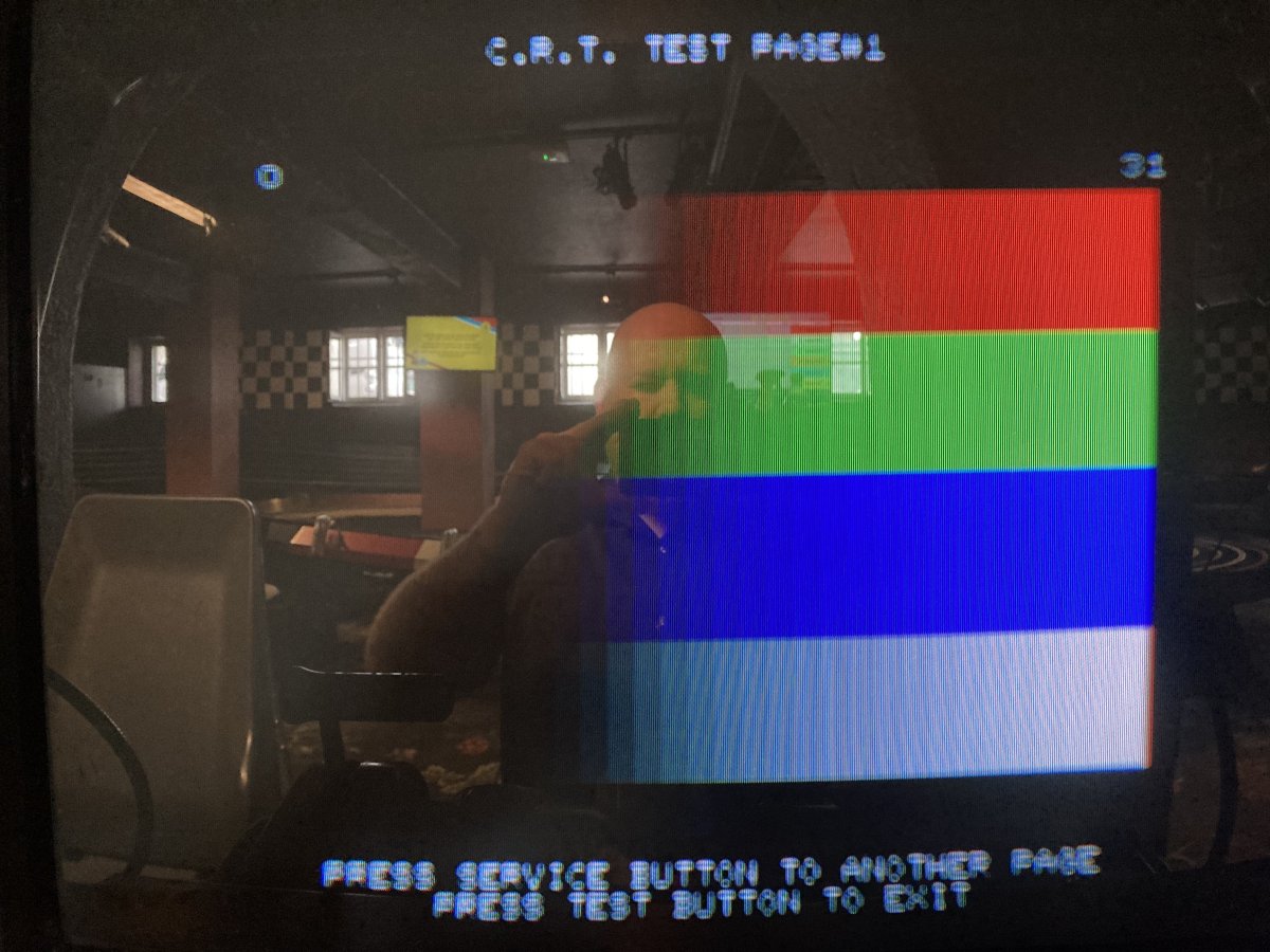

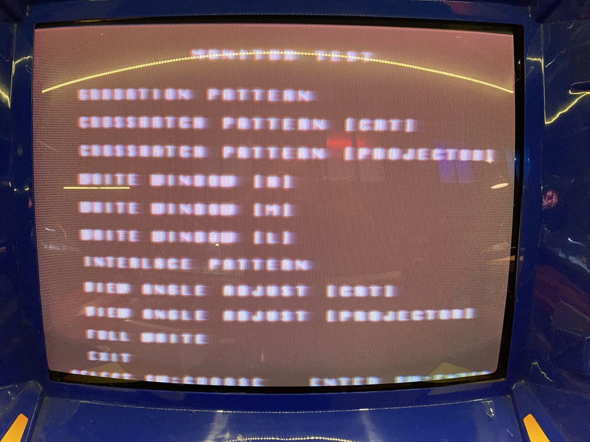

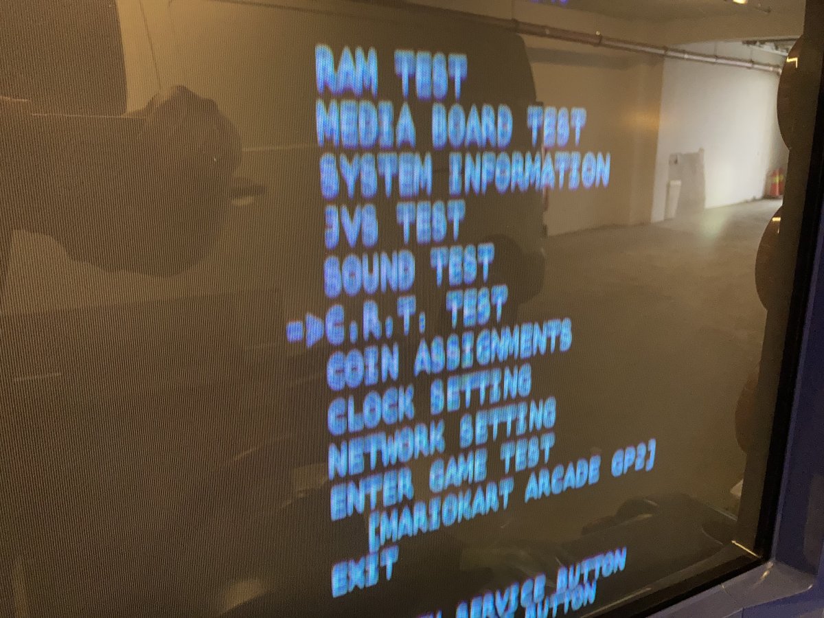

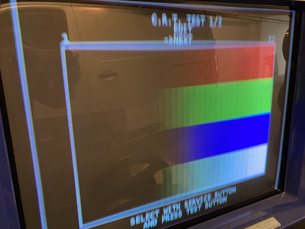

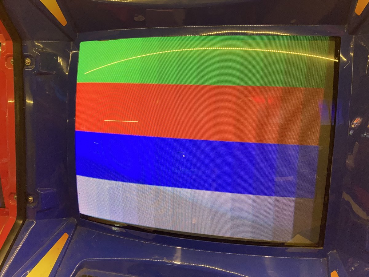

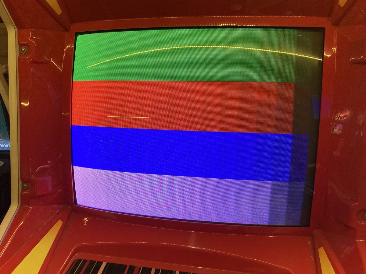

After installing the new chassis I was greeted by this lovely image
Needs some love!

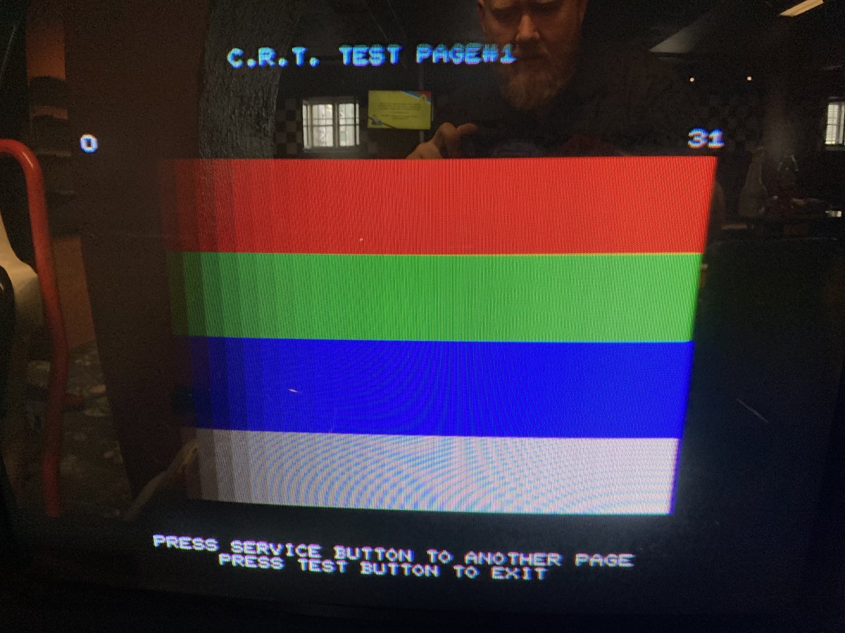

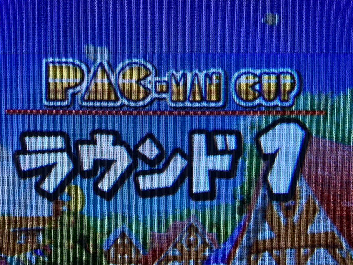

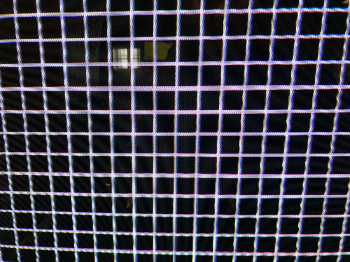

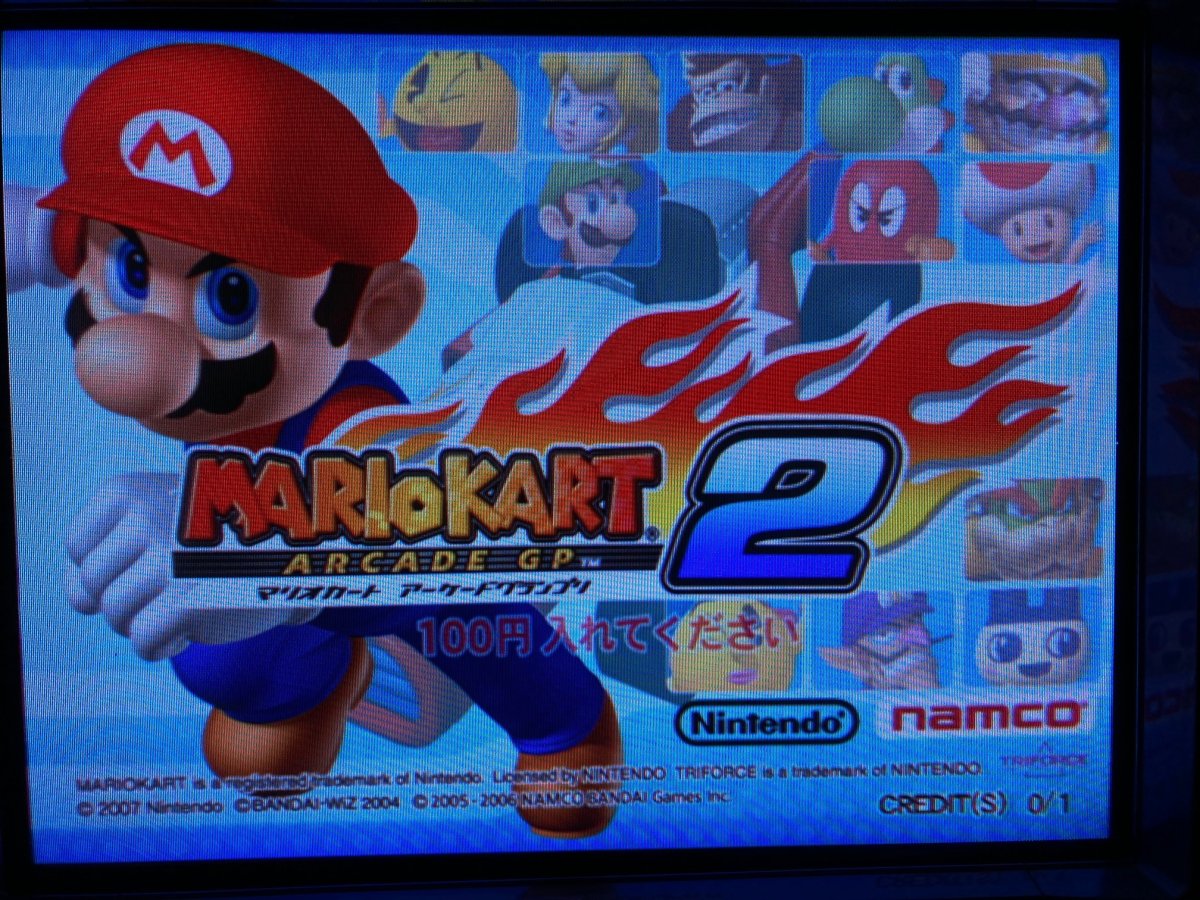

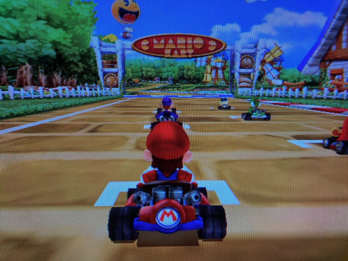

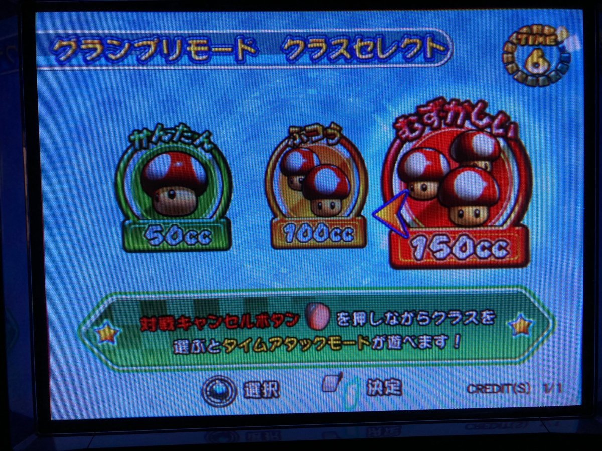

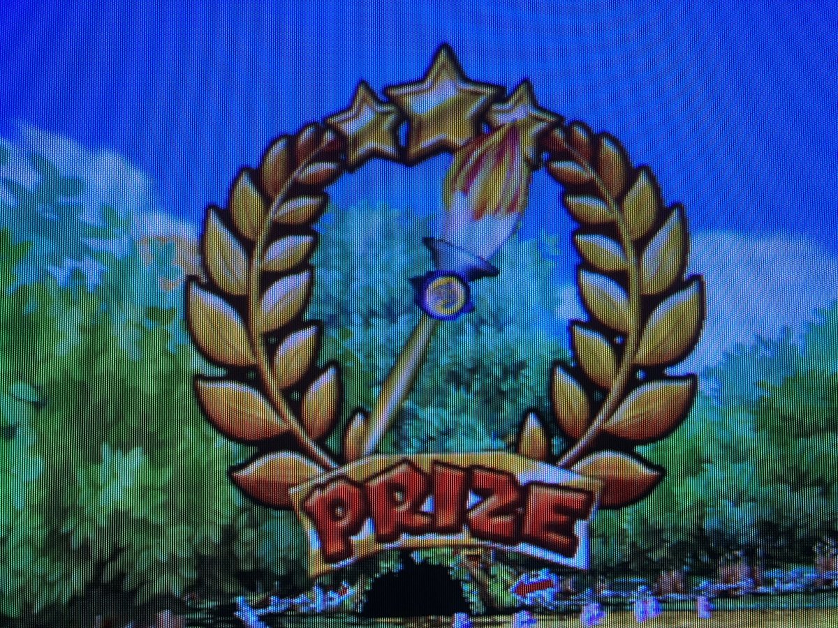

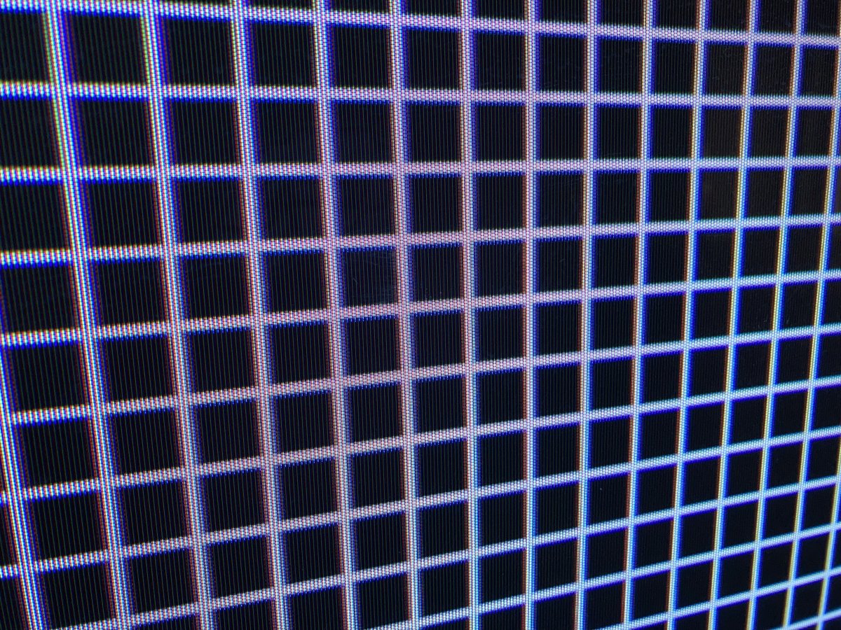

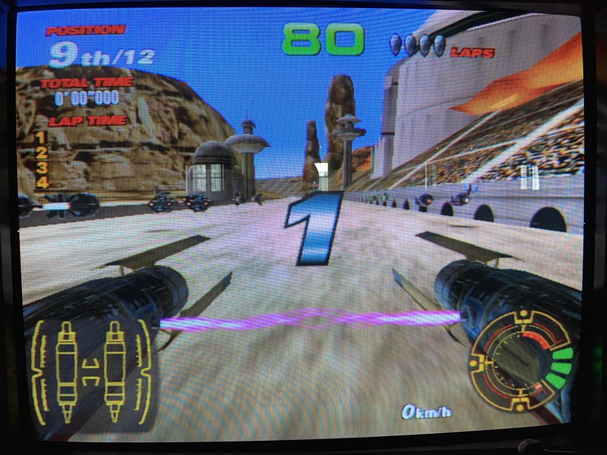

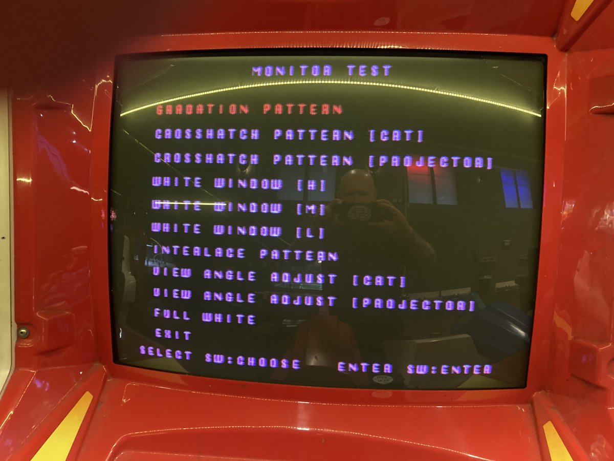

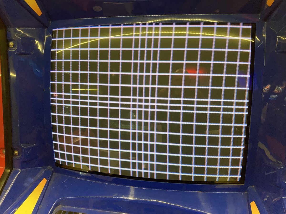

Convergence was surprisingly good, so just some tweaks to screen and focus & color calibration. Results where quite nice if I may say som myself.

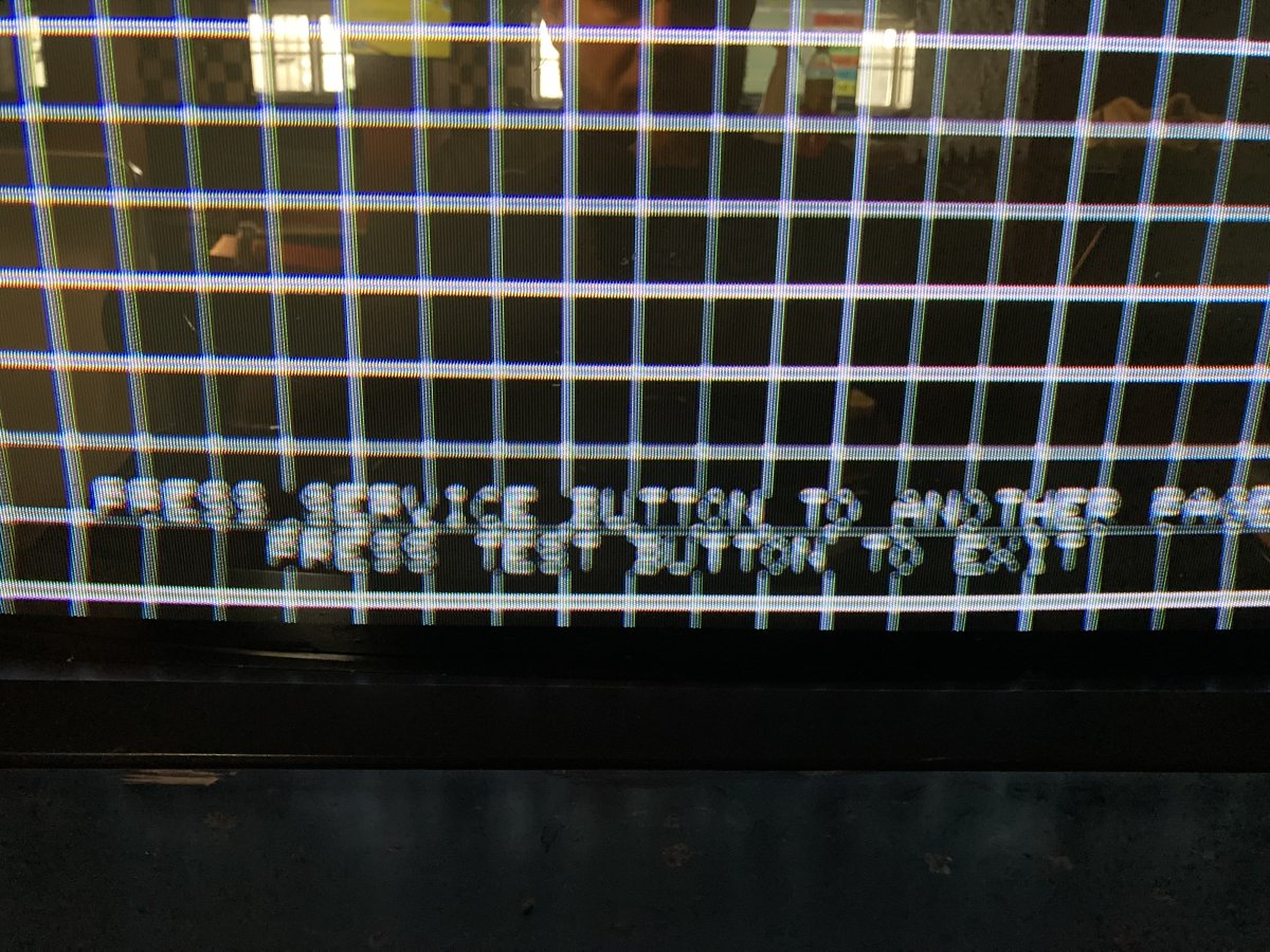

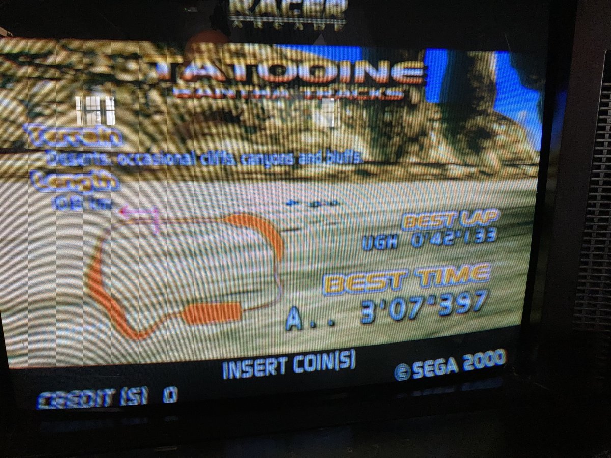

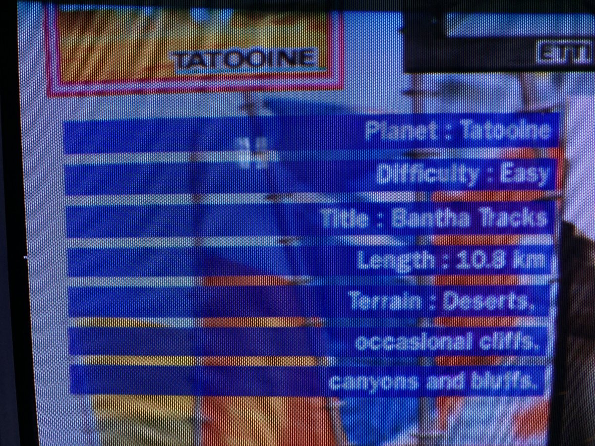

Needs some love!
