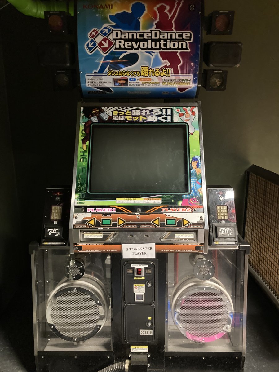

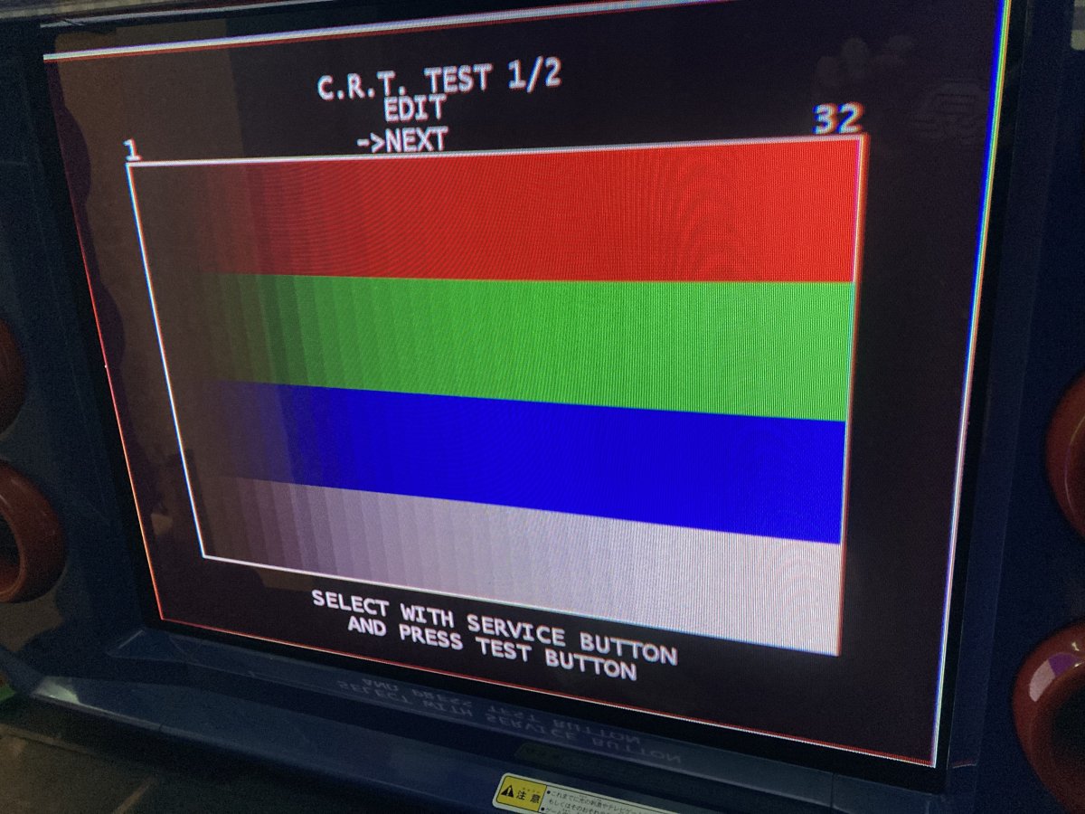

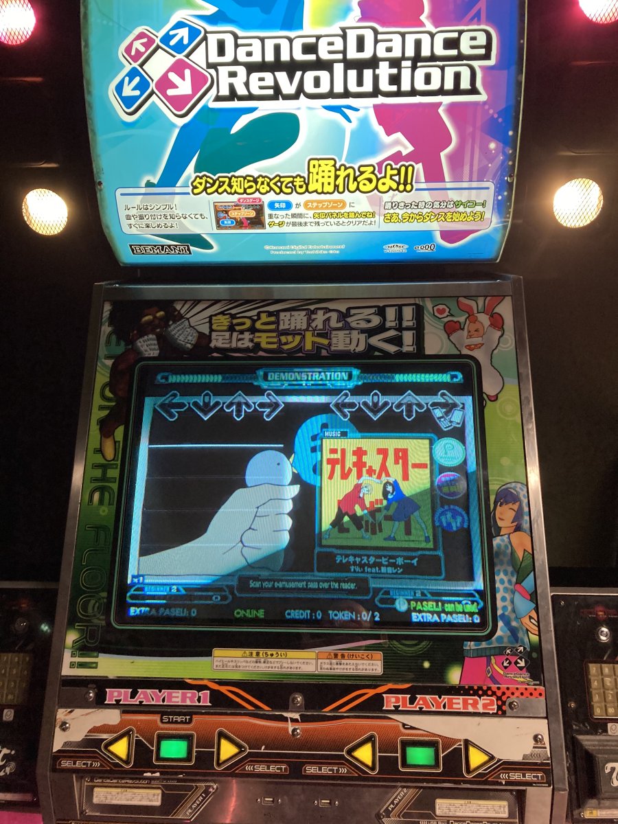

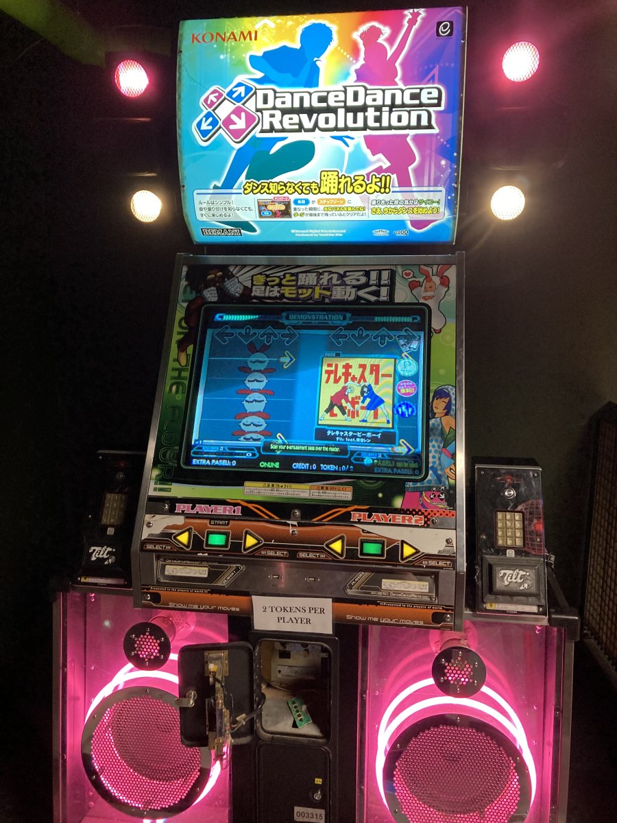

Today I had a date with Dance Dance Revolution

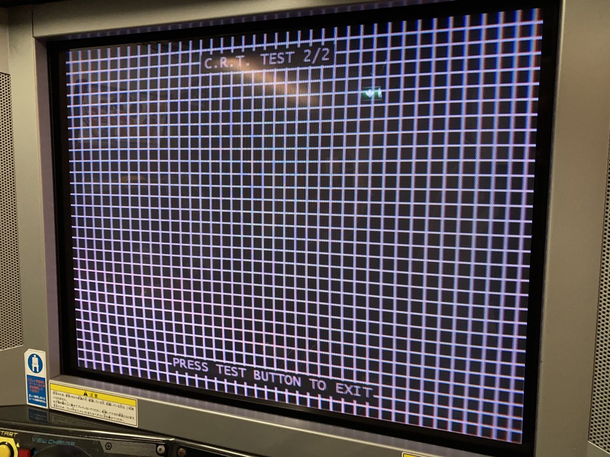

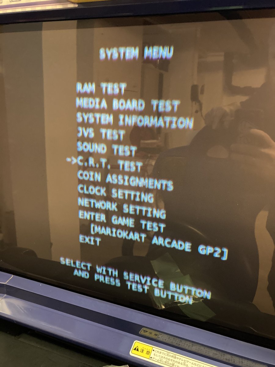

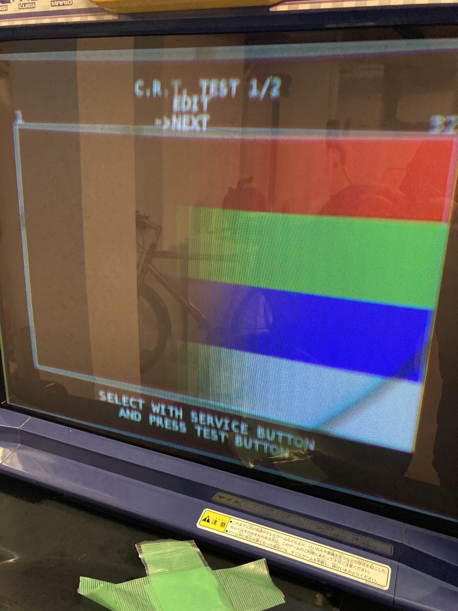

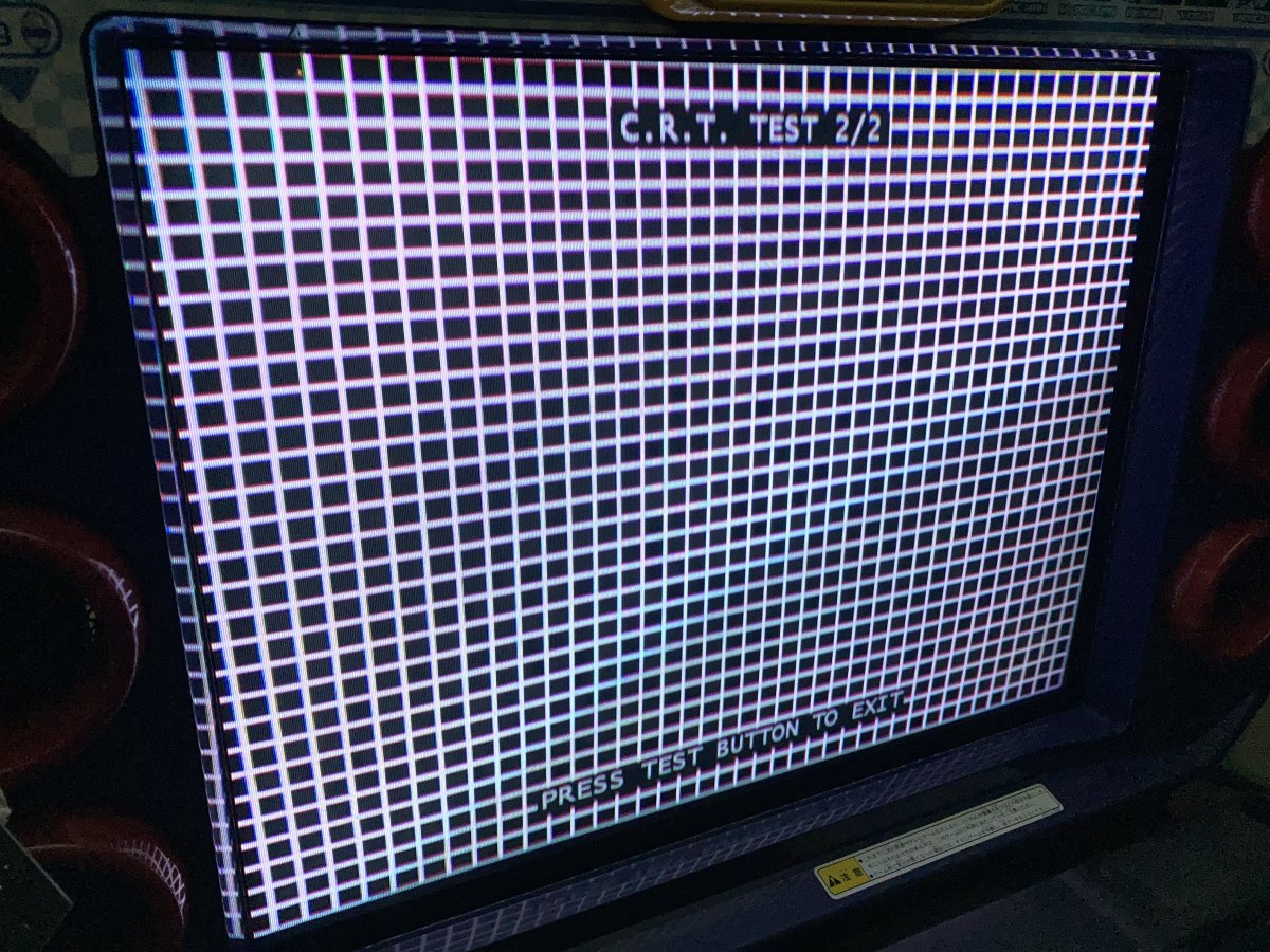

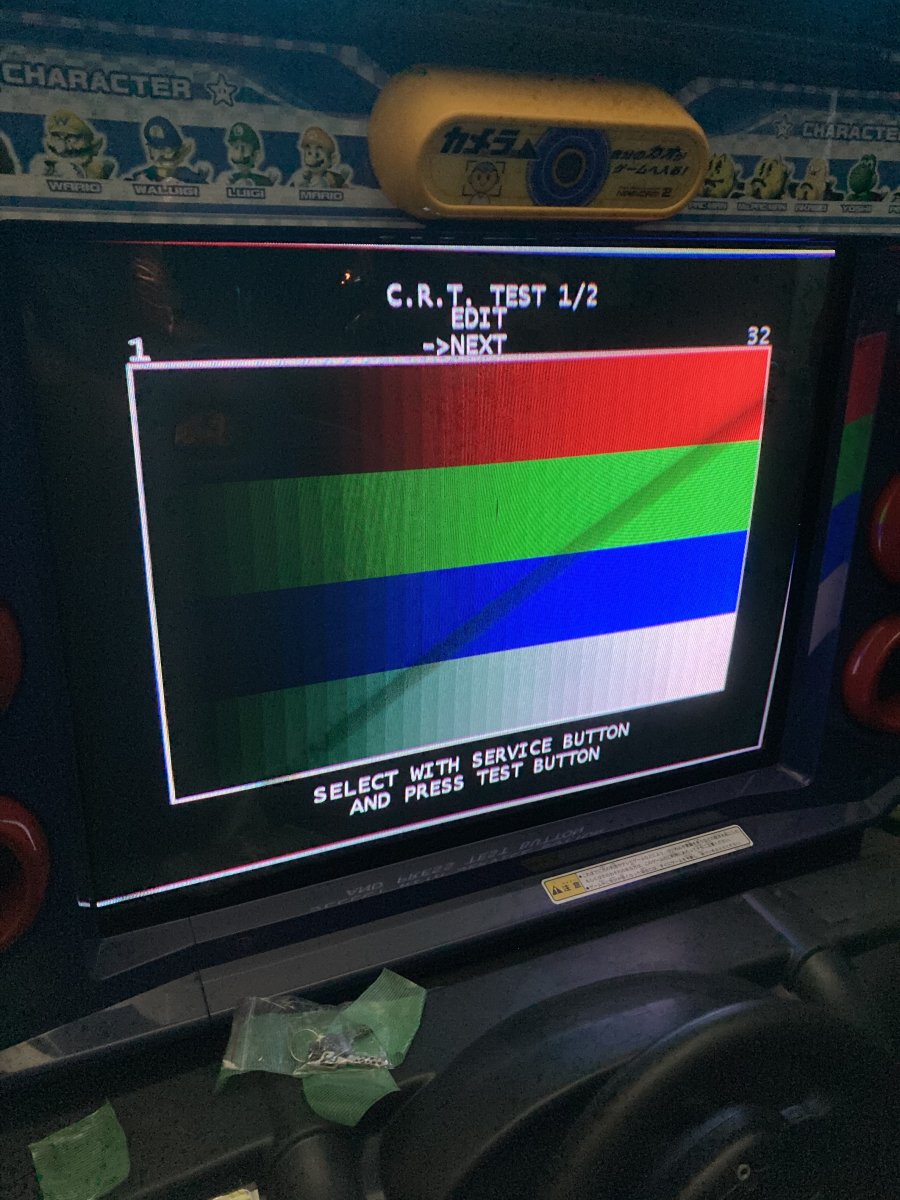

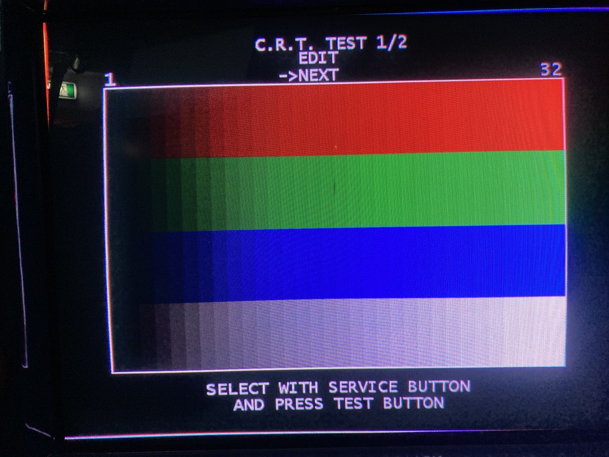

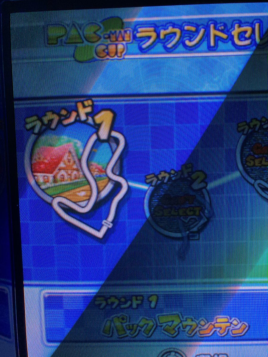

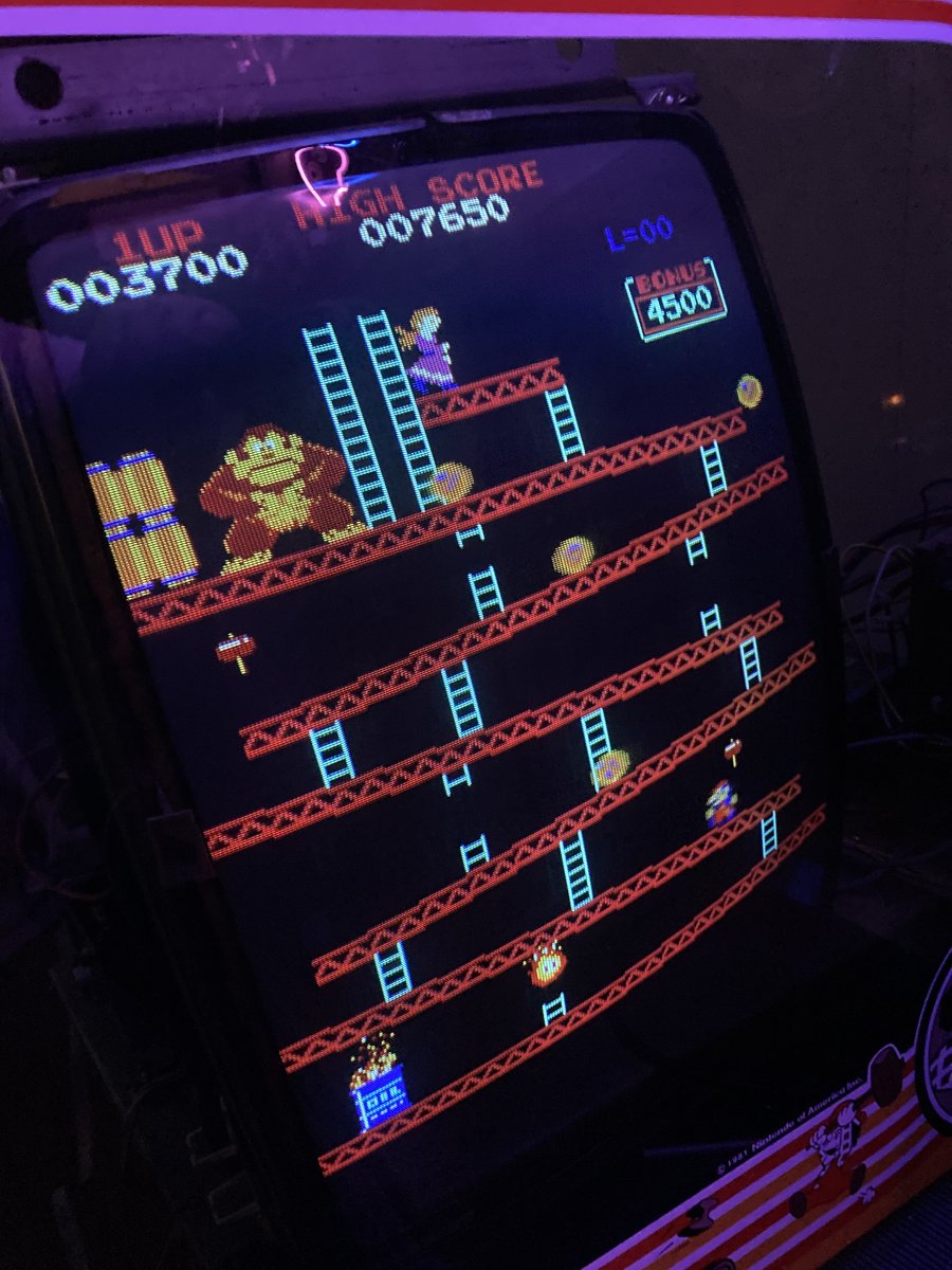

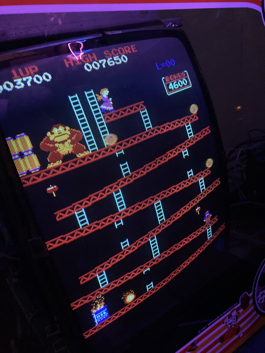

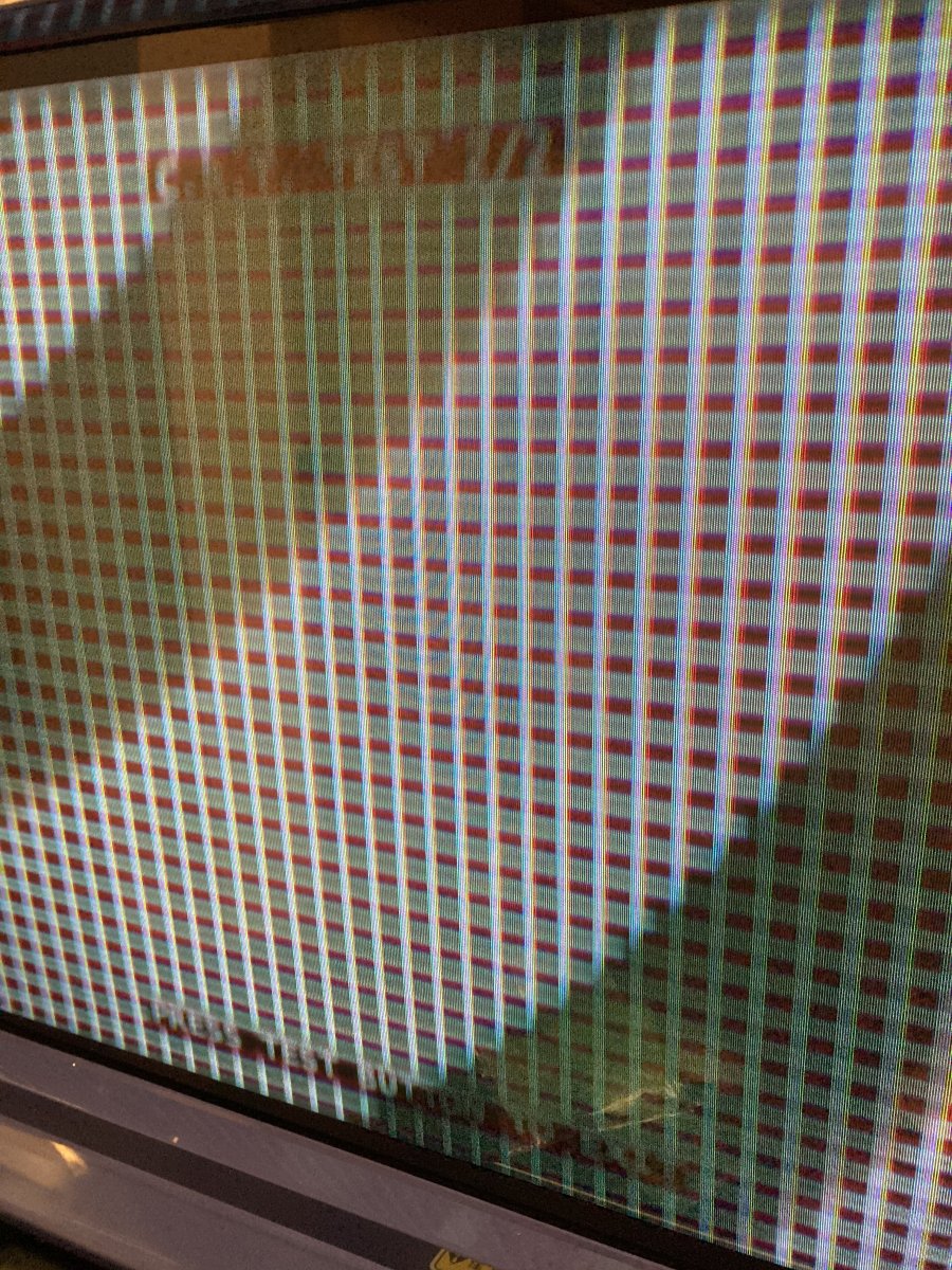

Everything was working ok, but the monitor had some quirks to deal with.

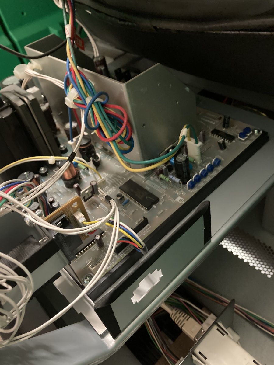

The original Nanao tube had been replaced with a Wells Gardner 9400.

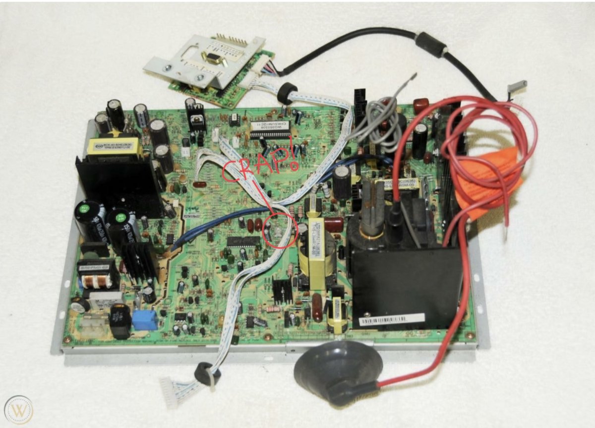

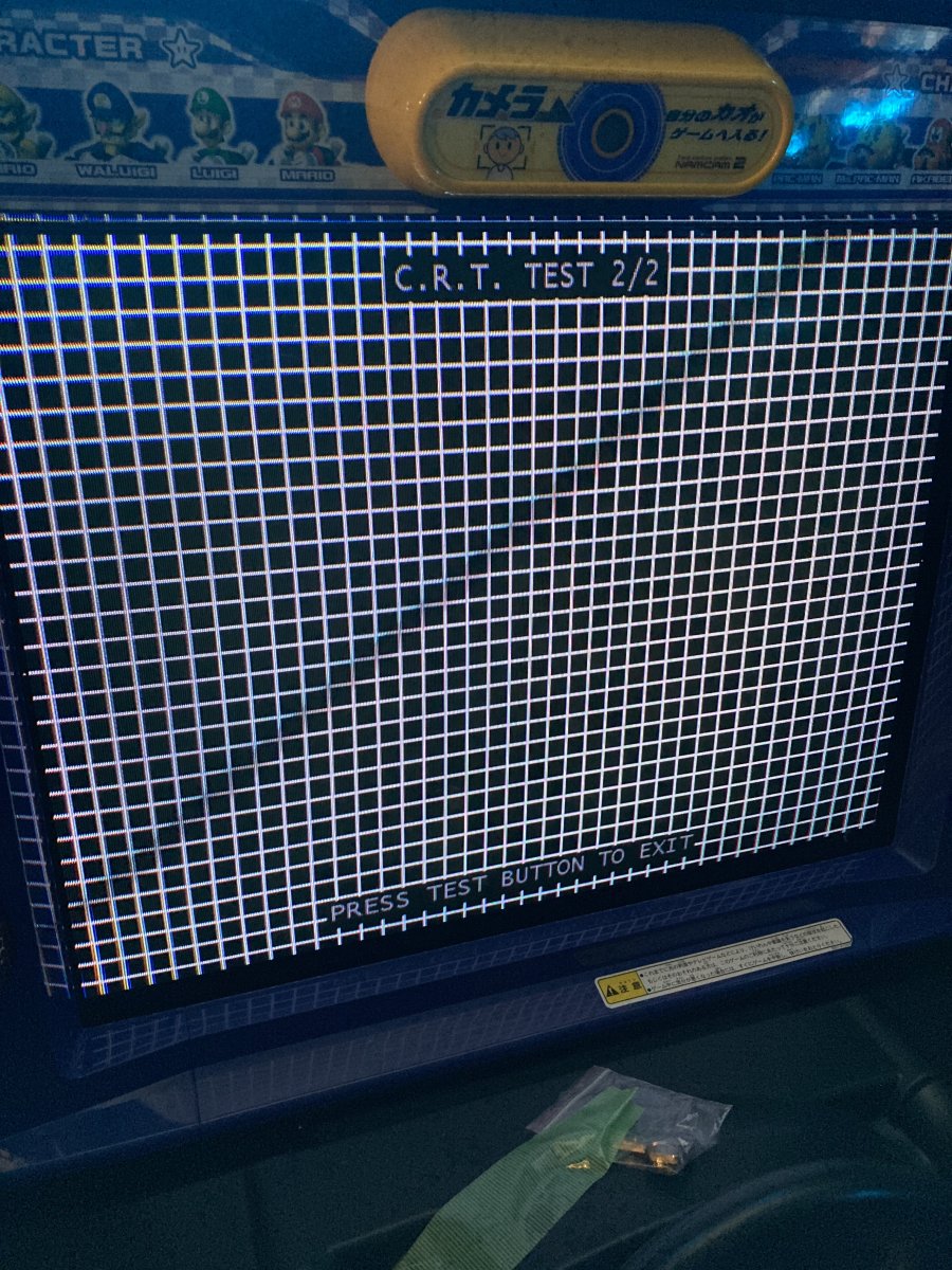

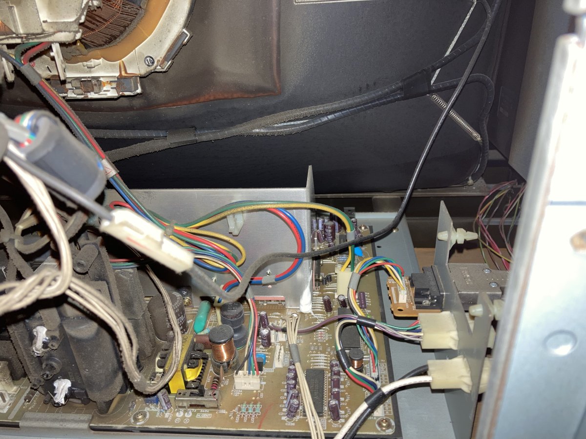

The 9400 has a OSD with a remote to calibrate most settings, but H. Size did not fill entire screen + the focus setting with the remote didn’t do shit. Time to open this big bastard up and see whats inside.

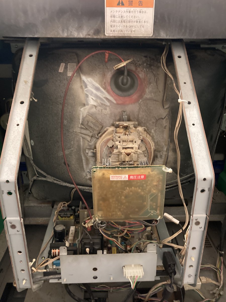

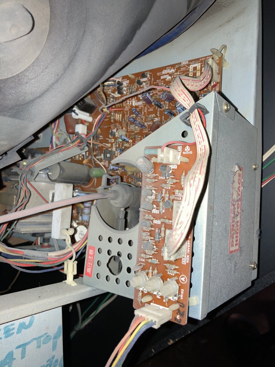

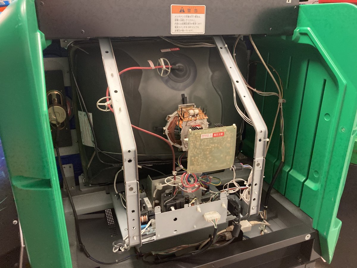

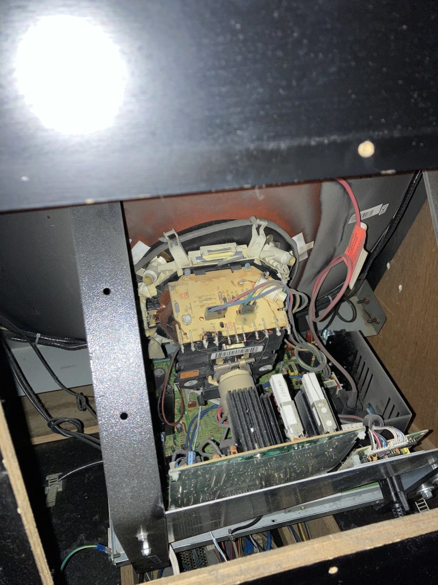

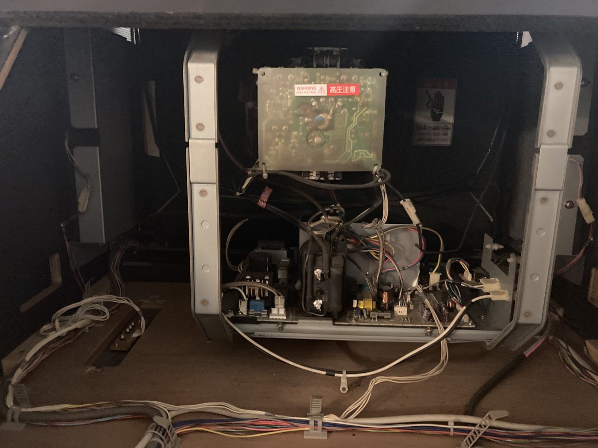

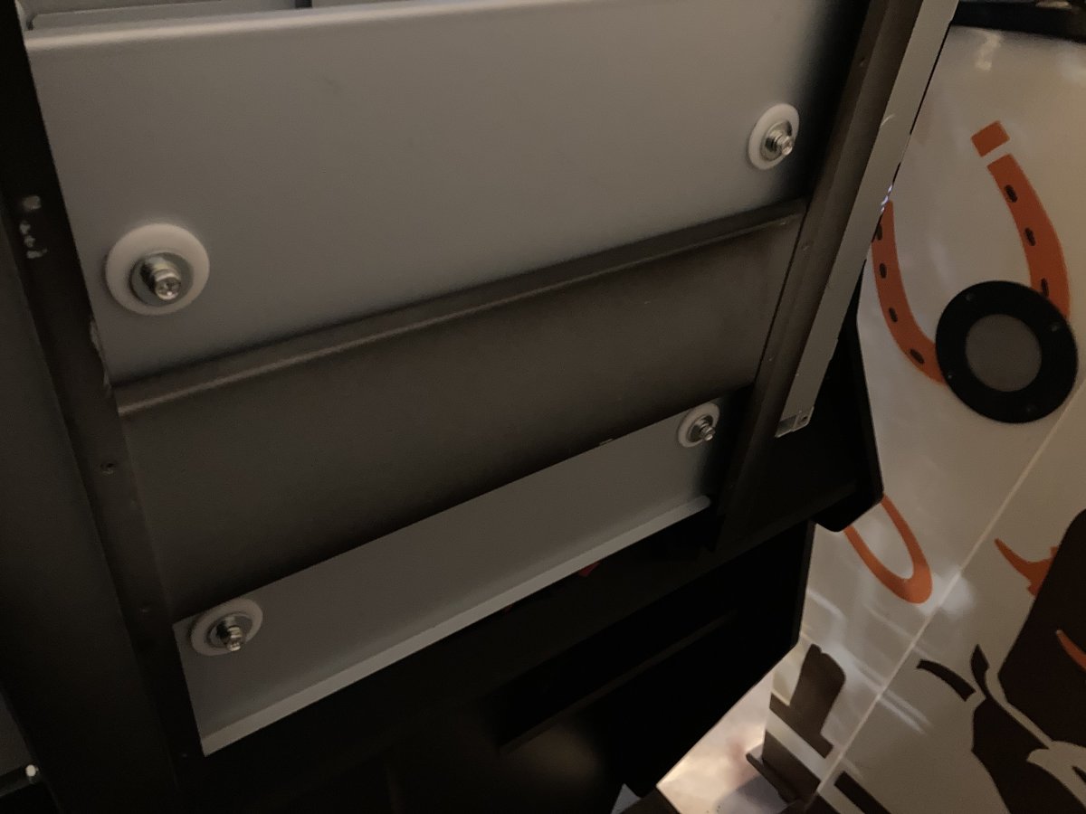

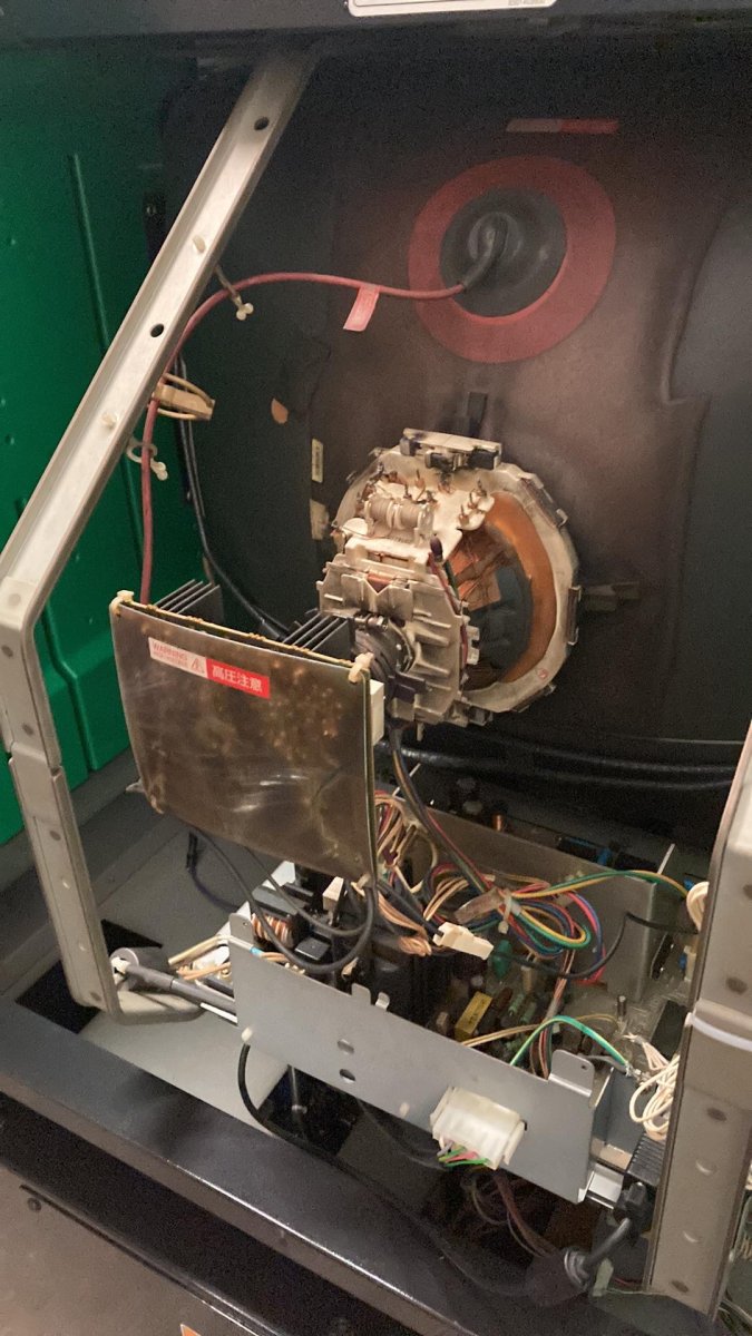

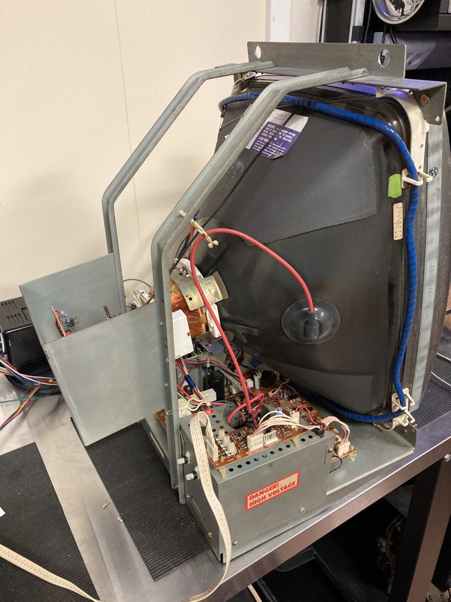

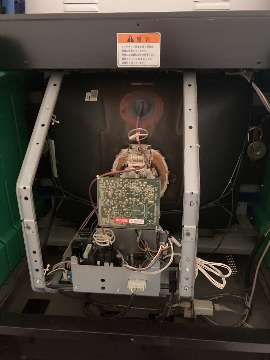

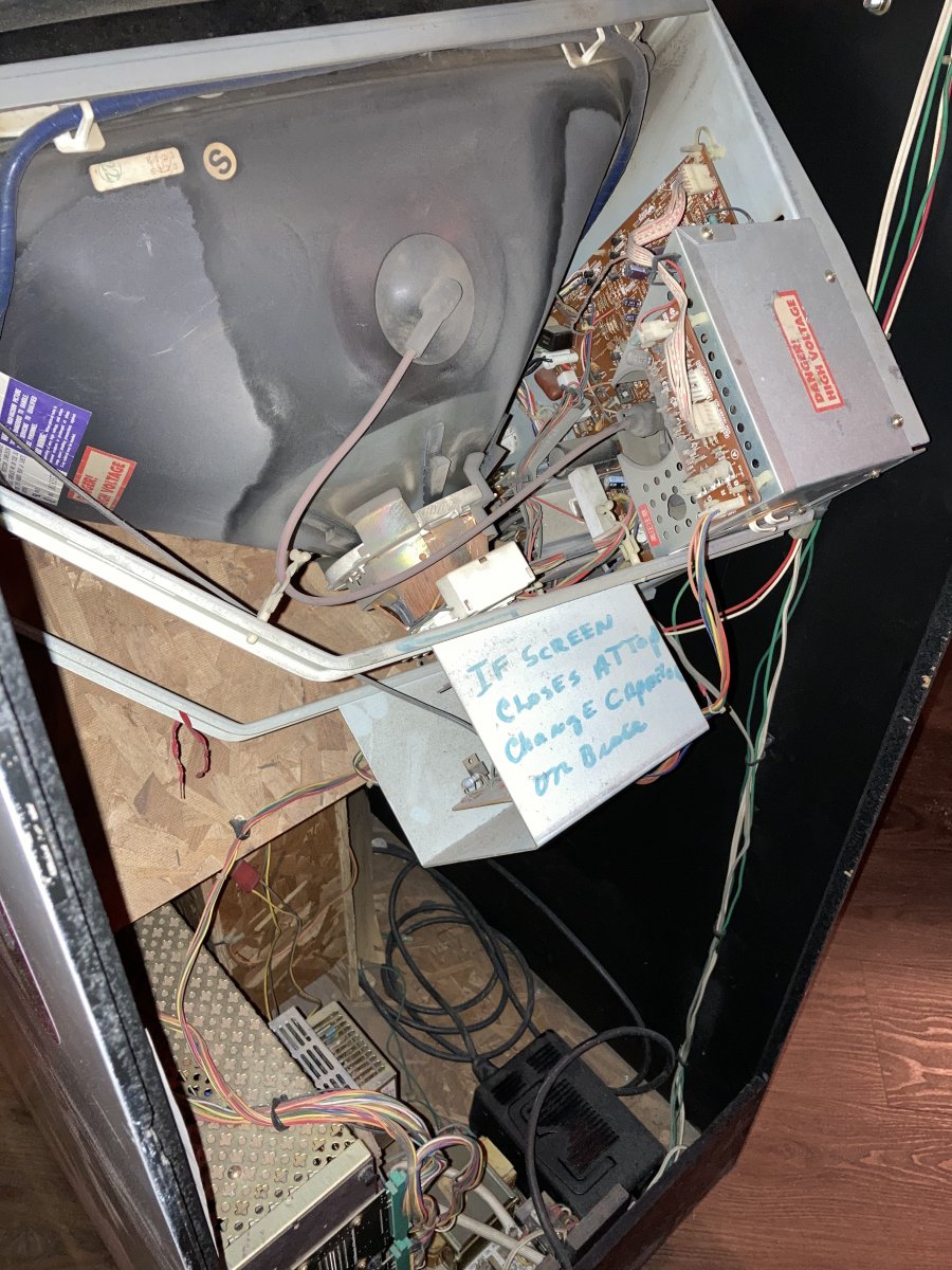

After removing some screws, I had some access to the chassis… Kind of snug, but doable.

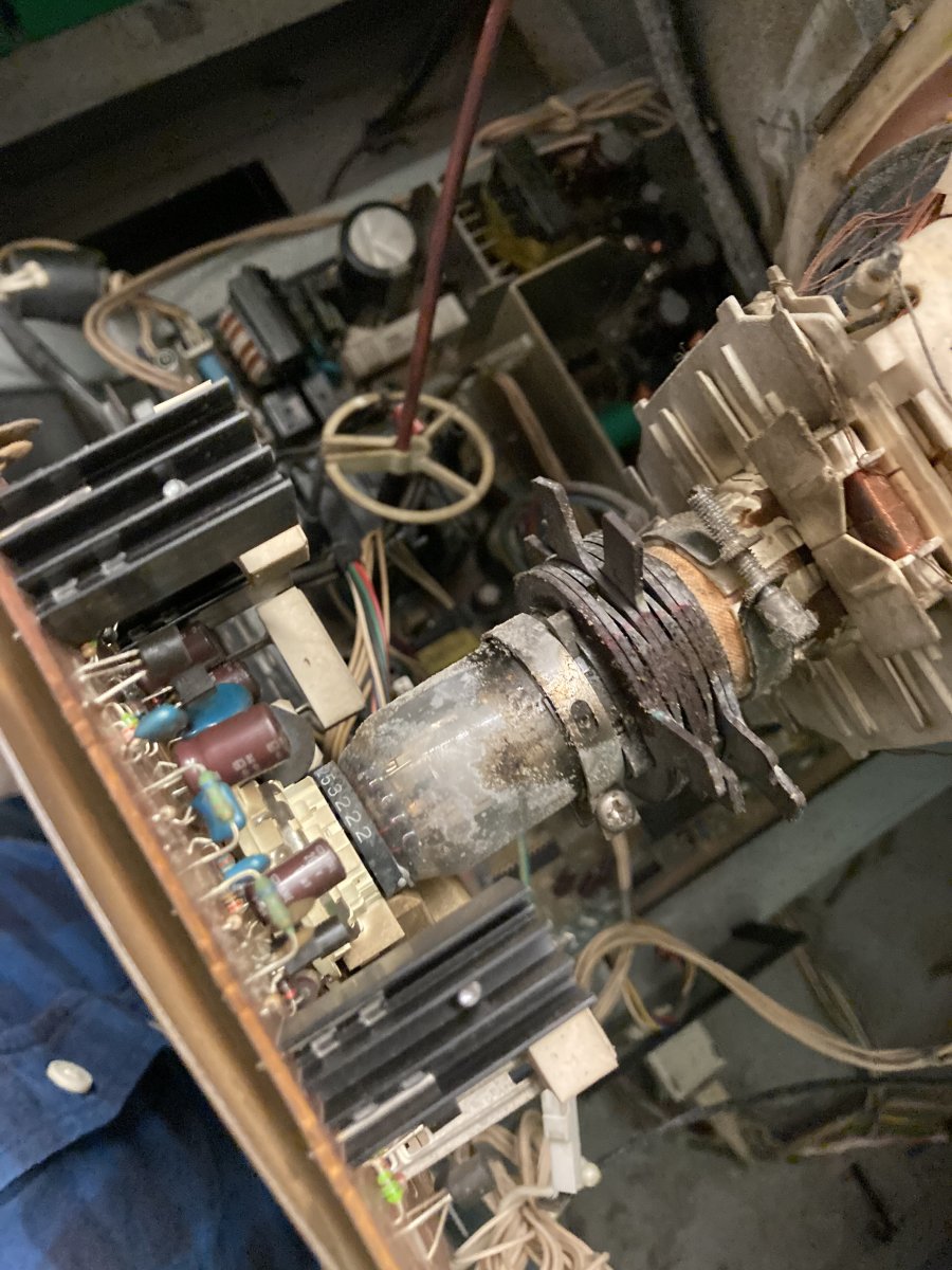

After a quick look at the 9400 I found the awesomely place H size pot on this chassis.

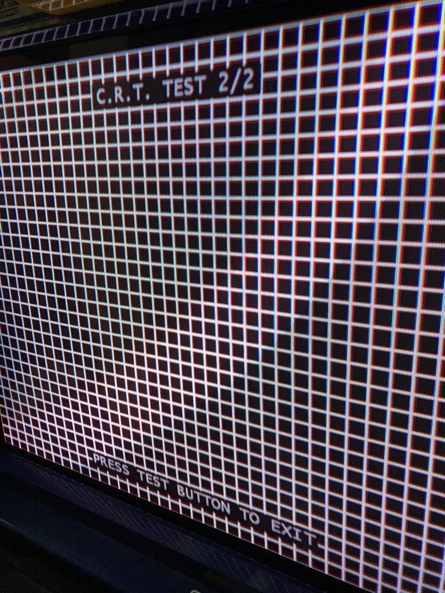

Ok…. A little scary to adjust while it was turned on, but no issue to adjust while off. Cranked it to the max and had lots of room to adjust with the remote. The focus pot got some love and everything is looking snazzy!
