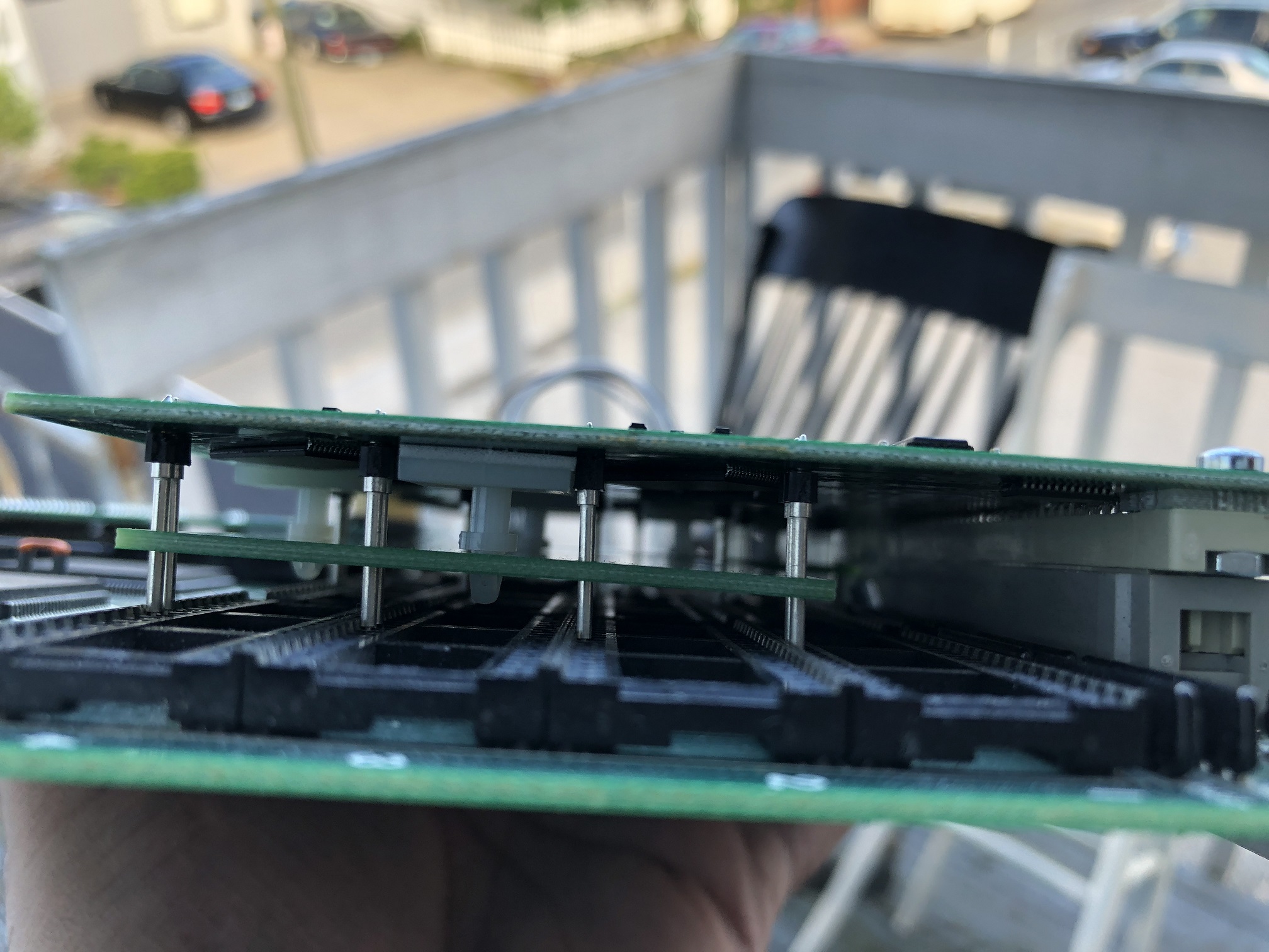

In any case, I see two things that I don't like
1) looks like the long pins in the main PCB are not completely inserted in some areas, specifically in the are close to where the contrast knob is. Try pushing it deeper while looking from the side carefully.
2) It also looks like the middle PCB that joins the 2 PCBs is not properly sitting on it's left side (the one closer to the main PCB of the multi)
Please check those and get back to us.
I also re did my key writing wires because i had put them backwards before. Would the wires put incorrectly cause permanent damage to the board?
I hope not.
So i did what you said and now i am getting a little more then just black. Getting a solid green screen on most games and on Dungeons and Dragons i got a error message on the screen saying ram error other i get some garbled stuff then solid color. Ive attached pics.
