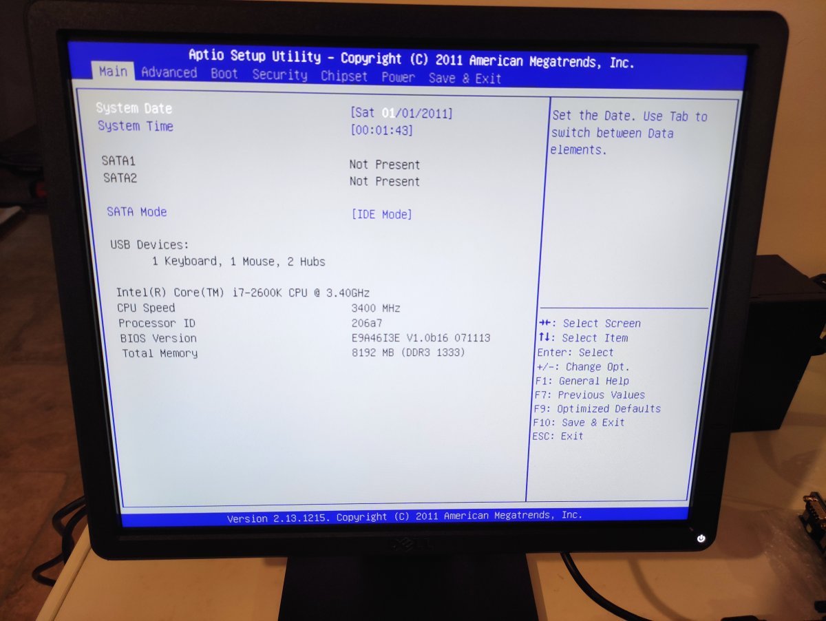

Most of my units have
E9A46I3E v1.0b16 071113
There's also an older bios i found on one of my units.
So that makes 3 different bios revisions so far
E9A46I3E v1.0b13 040512 i7 2600 works
E9A46I3E v1.0b16 071113 i7 2600 works (i7 2700k works for 300wins on this bios)
E9A46I3E v1.0b23 092614 << figureheads only so far (xeon E31290 works on this unit confirmed)
Can't help on the i7 2600k model though, i don't have that cpu, only the standard i7 2600, which works in either system.
