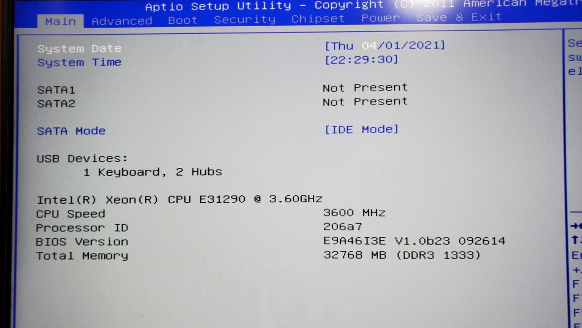

I also want to point out that Xeon CPU (in the Sandy Bridge family) works on the X3. The highest I have seen that works is the Xeon E3-1290.

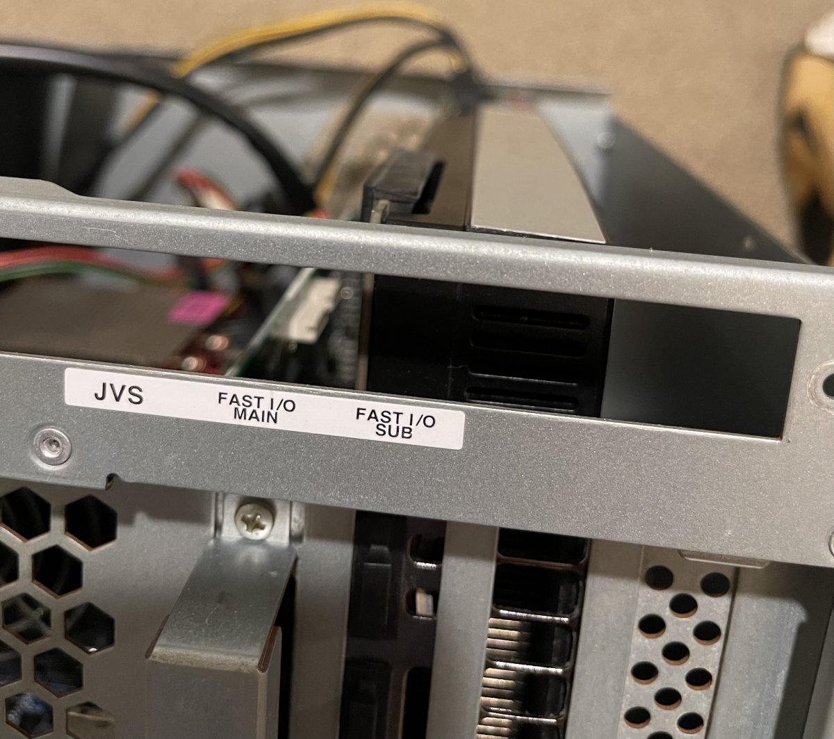

You will also need to mount the case fan on the outside of the case as this card doesn't quite fit with the case fan inside the case. I'll update this post with a picture of mine tomorrow. It's very clean mod and it actually cools the system better than when it's on the inside.
@Murray would love to see those pics!
I have this card, it has 2 X 8pin power inputs. Could I use 6pin to 8pin adapters?
That EVGA card is going to struggle for clearance with the IO board though..... Just sayin! You might have to mount it differently. See how you go.
This section right here is where your daughter IO card sits in the case.
Great eye! I see how it is taller than the average card height.

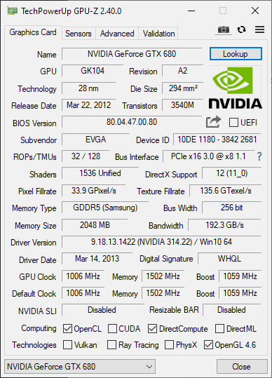

EVGA GTX 680 2GB 02G-P4-2680-KR
I got the exact same reference, label says "P/N:02G-P4-2680-KR"
However my Device ID is slightly different. Memory brand as well.
BIOS version on PCB label is 80.04.47.00.80
as below.
However the card came with this version installed.
I backed up the BIOS it came with and had a look at the CRC, and it matches yours.
