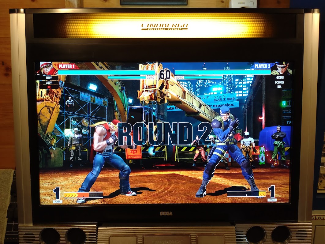

What games really benefit from a better gfx card? I had a small amount of screen tearing in KOF15 but otherwise it looks great on my stock one.

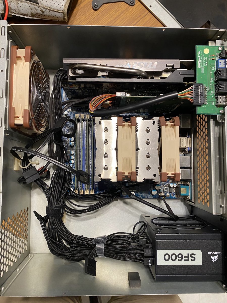

I can personally confirm that the 1650 fits without taking the rear fan out and it leaves your FastIO & JVS header intact. The rear fan is missing in this pic since I was trying out several cards, but I reinstalled it afterward.

I had picked up an MSI 1070 two fan model thinking it would be similar in size to the original 660 and 770 I've been using. It's huge. Even the back plate is too big to fit next to the dmac card. It's too long to fit with the fan, and too tall to fit with the io board.
It looks like 1660 supers are small and cheap enough. I might try one of those instead of looking for the perfect 70 series.

I finally got around to installing the 1660 super and it fits great in every dimension. It's a Zotac ZT-T16620F-10L.

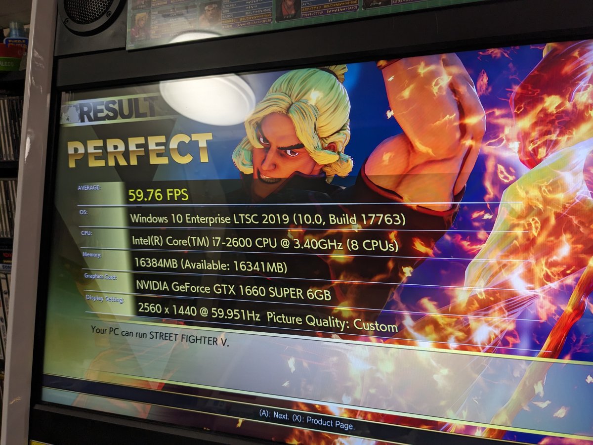

I upgraded the CPU to an i7-2600, no problems. Combined with the 1660, SFV benchmark has a solid framerate at 2560x1440, max settings.

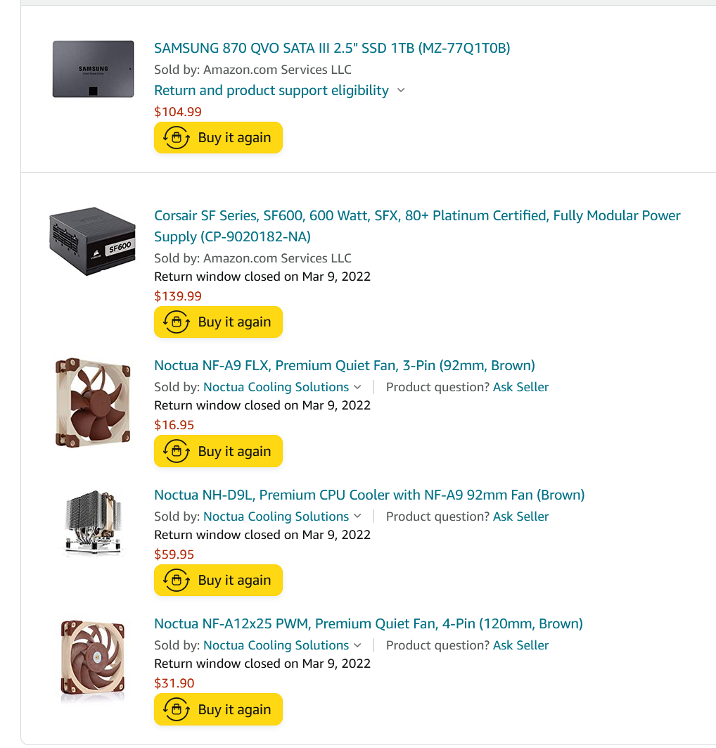

I added a Noctua NH-D9L cooler and there's no way the hard drive mount will fit with that cooler. At least not the two drive mount mine has.
Similarly I had to remove the GPU support since it's right where the 1660's power connector is.
