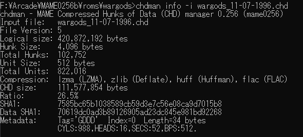

What did you do? That CHD is clearly different, and here I was thinking it would be the boot rom that needed adjustment.
The CHD is different to show that it's not using the geometry of the original one but it's totally arbitrary geometry.
I figured out the only reason the game was not starting is changes in the geometry of the disk.
Simply adding a cylinder more which should not impact LBA <-> CHS conversion and it was refusing to boot/crash.
Meaning is was definitely asking the drive it's geometry and it was not hard coded.
I dumped every ATA transaction and found that on a normal run (with the right drive) it was calling "Identify Device (ECh)" ATA command and stored the geometry in memory.
This happens two times, the first time when bootsector.bin is ran and the second time when the game code boots.
The check validating the hard drive is the following:
Code:
(((NCylinder * NHead * NSectors) >> 2) + 0xFF) >> 8 == 0x323
This check is done a first time after loading bootsector.bin and after reading the first game code sector.
Then every time a sector is read once the game code is running (from a different function).
Hot patching the memory with the right values and voilà, the game runs with any disk geometry without impacting the LBA to CHS conversion function.
From there i figured out what instructions can be rewritten to permanently patch it.
The bootrom is untouched, everything happens in the bootsector.bin and the game code which are stored in the hdd.
I am finishing to patch the hdd and will upload it.
