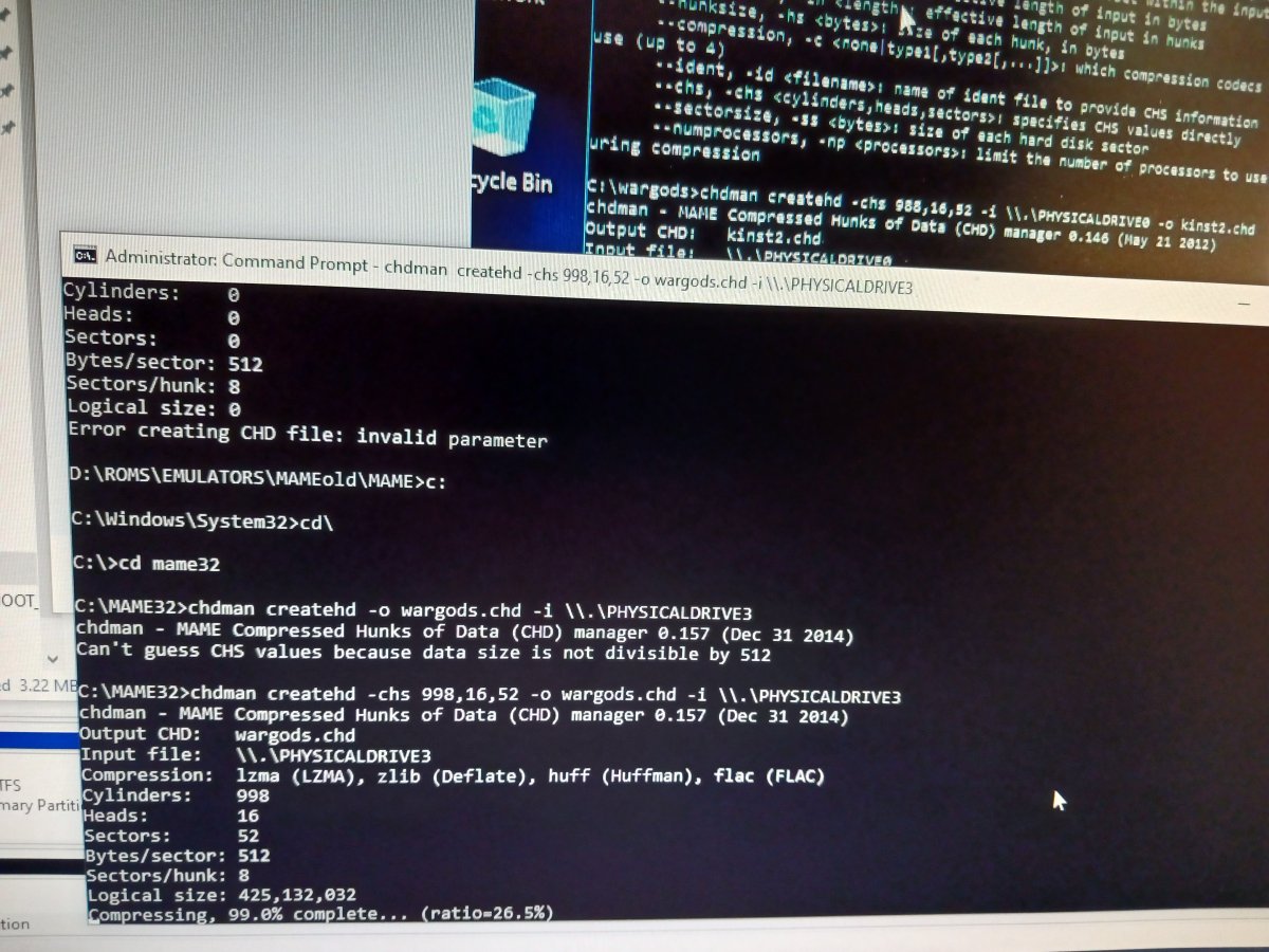

I believe this was my exact syntax with CHDMAN when I converted a KI2 drive to War Gods last year. be mindful the CHDMAN commands vary between versions, so my command will only work with the version 0.157 I used (I think the older one was like 0.138, they changed everything since then)

Oh man .157 is from 2014. time to upgrade! But even on 157 the commands you shared are not the right ones to use for writing this image to a CF/DOM/SSD. Those commands create a CHD image from a drive - so maybe you were backing up the drive there? (good news?? find that file!)
you used:
chdman createhd: create a hard disk CHD from the input file
folks here want:
chdman extracthd: extract raw hard disk file from a CHD input file
you used:
folks here want:

before everyone jumps on me for this, full disclosure, I noted that I was using a very old version of CHDMAN for this operation. also the CHD files are dependent on CHDMAN versions, they're in like different compression formats? so I think what happened was I was using a very old version of wargods.chd from my MAME repository and the CHDMAN version I used was compatible with it.
