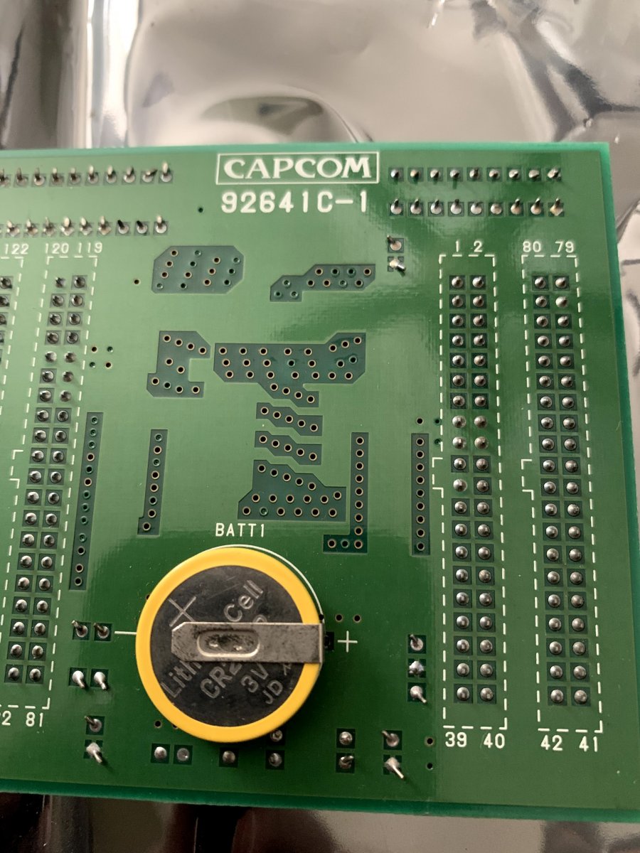

Picked up one of these: https://www.ebay.com/itm/284267824466
(not affiliated in any way, but saw these while poking around and thought of this thread)
They look a little rough, but should do the job.
Following up, the one I ordered from here arrived and looks better than anticipated. A weird bodge wire to ground on the B-21 chip, but I think that's fairly common.
that looks like this was at one point modified to NOT use a battery, and then the modification was undone.
I wouldn't call that common. a Bunch of these were modified for non-battery use because that's what people wanted for conversions. Then when the multi was announced as wanting a battery backed board, they went though and undid the modification on their stock because that's what people started searching for.
