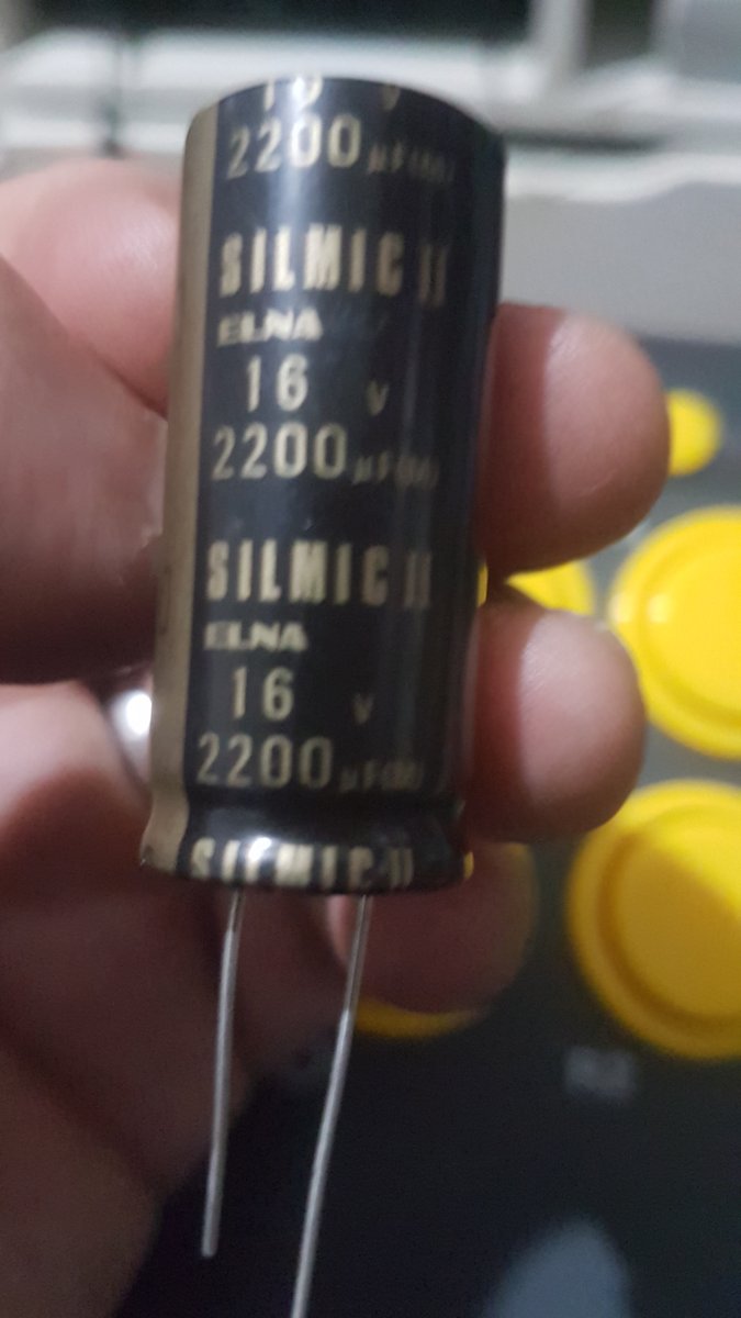

That capacitor is a bit impressive. I guess you can't close the console now, can you?
What are the exact values for that capacitor? Please remind me the exact model of your AES. Was it NEO-AES 3-6?

So the Neo Geo is 3-6 and the capacitor is huge @Royalsystemcrt did inform that I need to be careful with the legs (I don't know how to name them)
This is the capacitor I use Elna Simlic II 16v 2200uf
Capacitor looks good. Is the orientation of the capacitor right?

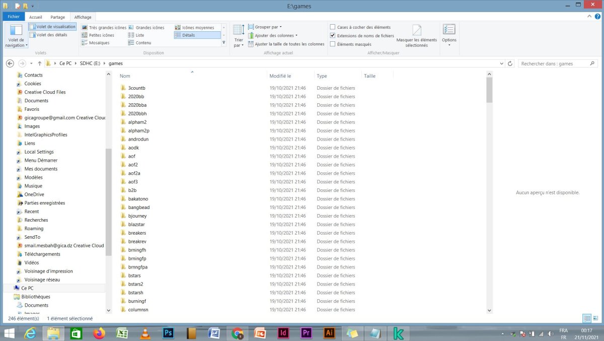

Yes of course i follow the same orientation as the original one. I dont get it or I'm doing it wrong, I follow the tutorial for the sd card, create a folder "games" on the roots of the sd card. Put the sd card on the multi aes, run the console, I got glitch and weird colors pixels and after that the blue screen.
I tried to update the firmeware i got the samea pixels glitches few seconds and then the screen become blue. I mean each time I tried I got the blue screen.
However I can play all my original cartridge without any problems. So what the next step?

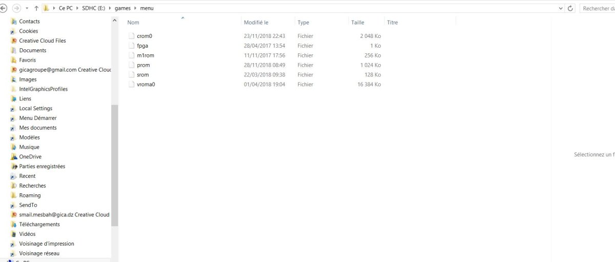

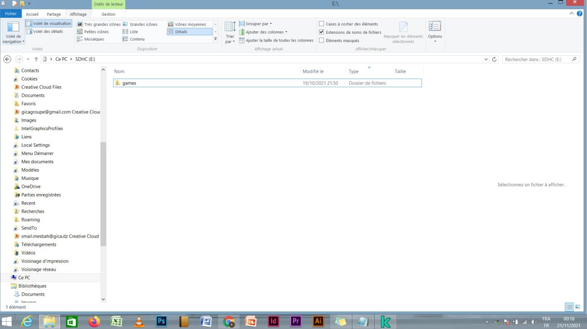

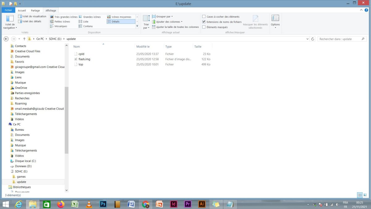

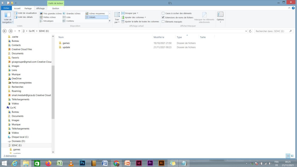

CAn you show how does the directory of your microSD looks like?
I made screen captures of the roots of my sdcard juste with the games .
