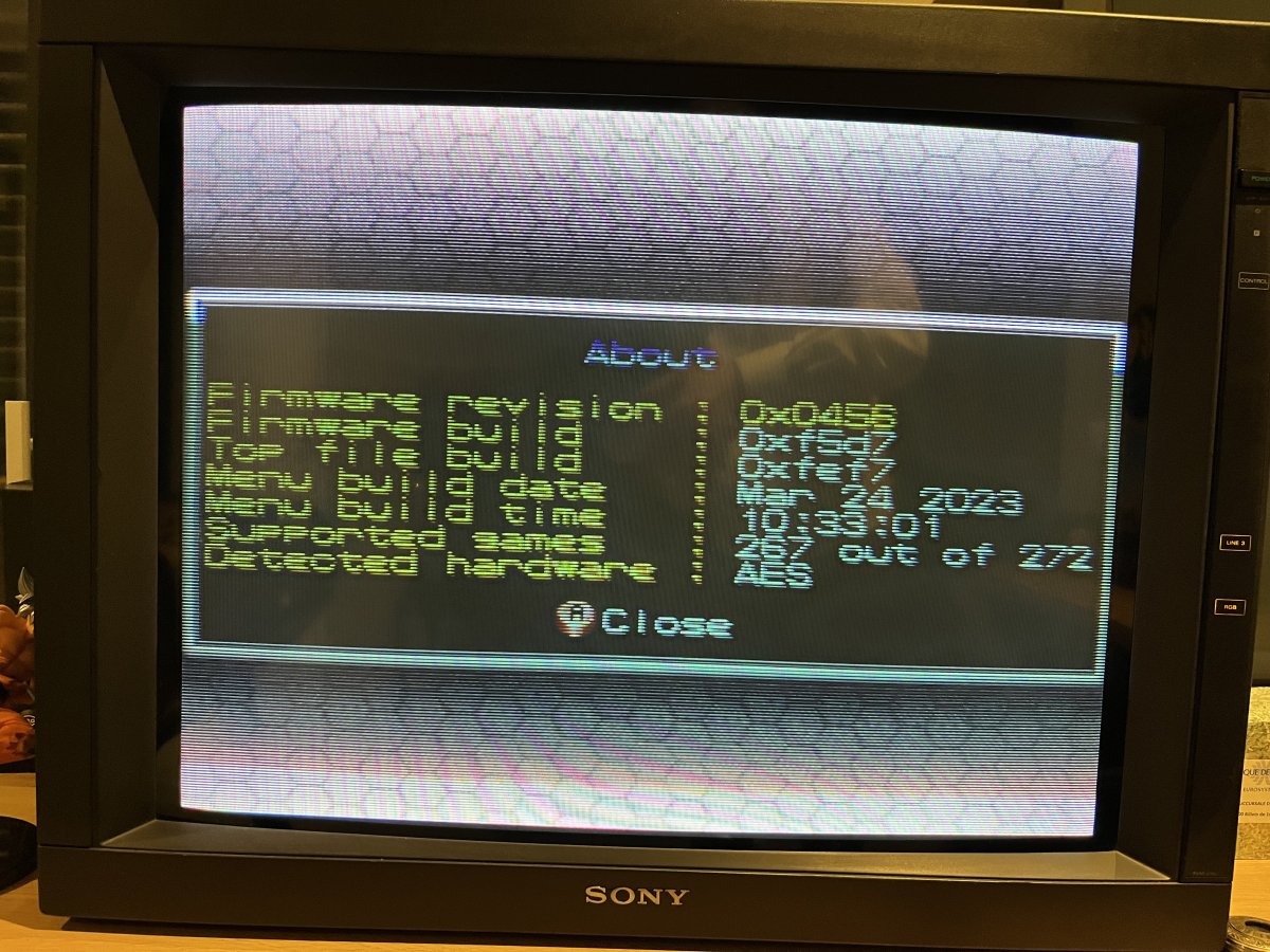

Hello everyone, I use my multiAES on my neo geo 3.5. Everything works perfectly. I just bought a neo geo nec mothercard. I have the image but no sound. I use a quality 5A power supply though. I insert the cartridge + or - up but that doesn't change anything. I would like to point out that I have no problem with an original game. Do you know where this could come from?

that fix that you mention was for some specific games, the menu should always have audio. Show us which FW you have, but I'm pretty sure that the problem comes from PSU or just the revision of you AES.
That looks good. It's not the latest FW, maybe try to update. In any case, most of the times the problem comes from the PSU. Tha amount of AMPS is important, but the quality of the power is even more important.

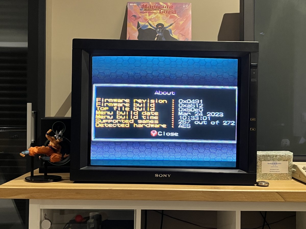

I don’t use last firmware because i have glitch.
I can try.
Psu I hight quality homemade.
I have two models, I will try the other one.

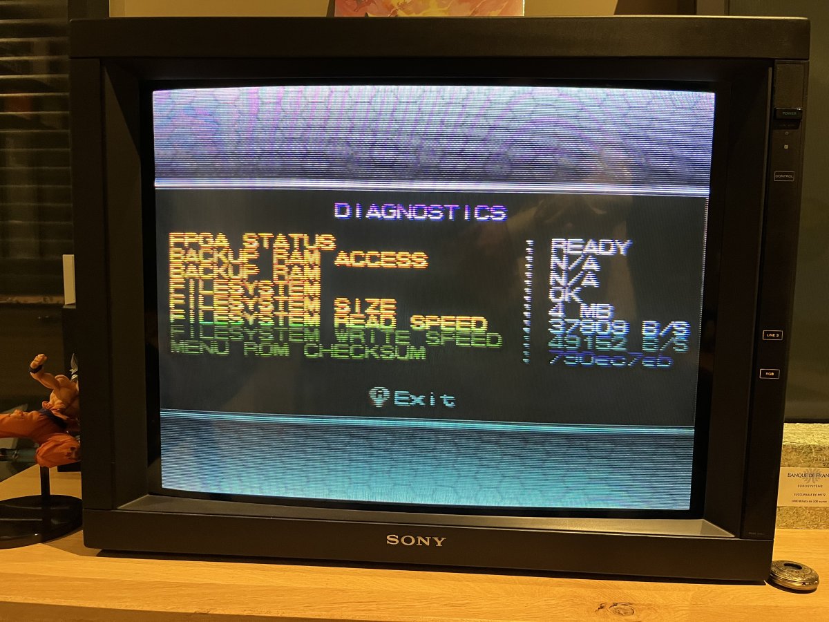

I update last firmware, no sound.
My PSUI is a Mean Well 5v 5 A.
Very good .

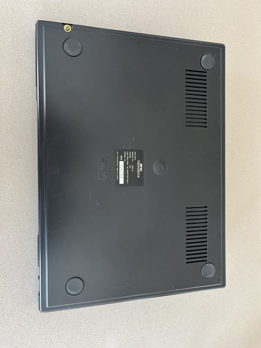

Maybe it's your AES 3-5. Do you have a different AES to try?
If you push the cart lever with your fingers and look at the right part of the console, you should be able yo see the text without opening it.
