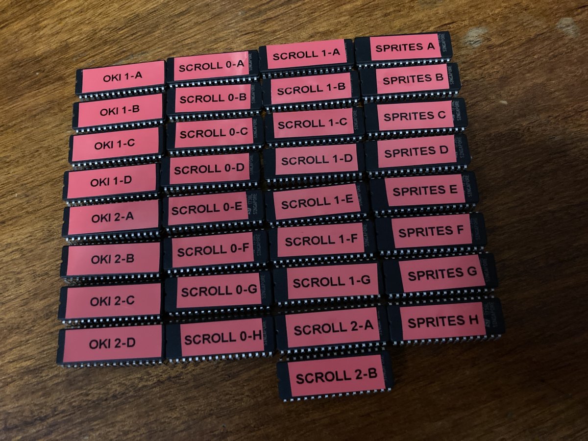

That's over 1000 rom sockets alone, think if i were to burn the roms also nothing would get done!

Just got x36 801s at -80 speed for £45 (all tested and blanked) Ebay UK seller, so not too bad 8)
I think I've just used the same seller for 36x 27C801s, it seemed like a decent enough deal. If the stock level is accurate, they have enough to satisfy two more multi's ;)

Yes, The rom burning takes a good bit of time due to the number of them.
It was a nightmare getting the files correct, hopefully there's no bugs still lurking in those ones :)

Writing, labelling, dumping and checking probably took a good 3 hours. Just wanted to get the jump off. Let me know if there's any bugs in those files and I can re-write.
Thankfully they all worked too. Had some that wouldn't blank on the programmer but they just needed some more time in the Eraser. I'm noticing that 30+ minutes is the sweet spot these days for a certified clean in my eraser.
