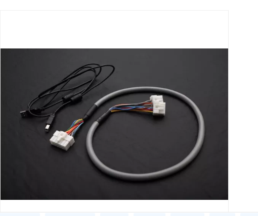

SO the JVS/JAMMA CBOX Supergun will work on all 3 of your systems.
i have a sega STV and Naomi.
You will need a Sega STV kickharness for some games (SOLD SERPERATELY)

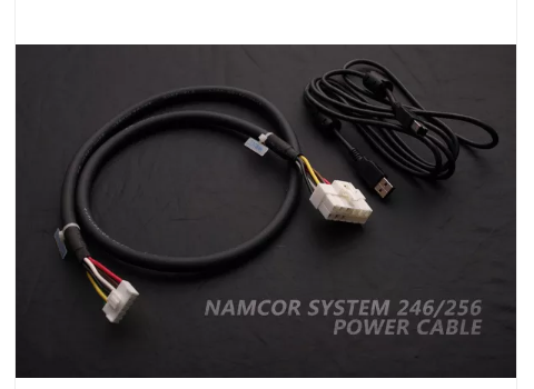

You can power your Naomi1/2 and Namco 256 straight from the CBOX for a CLEAN setup (SOLD Seperately)
you could run JAMMA video out of your CBOX to your OSSC and then run the video and audio out of the OSSC
for JVS run the video directly to OSSC
as the CBOX will only handle controls for your JVS ;) its designed this way to keep the best video signal from JVS source
