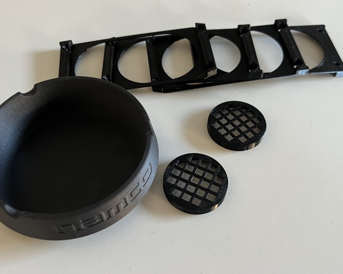

@nem thanks for the files. Got a friend to print them for me. Speakers are in the mail.
