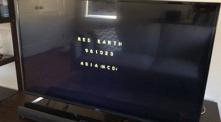

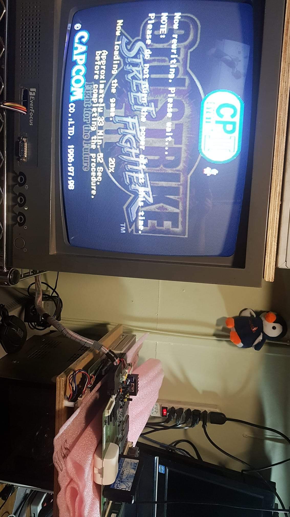

Yeah, the NoCD utility disc gives an “invalid CD ROM inserted” message when trying to load up Warzard. All other encrypted games seem to write from it; I was able to rewrite Third Strike on a spare setup I have & it worked with my battery Asia NoCD 3rd Strike cart). The only SIMM I could write for Warzard with the NoCD utility disc was WZD 50 (the 32 MB SIMM) in slot #7 when using the SuperBIOS.
For some reason I don’t think the NoCD utility disc can properly execute a Warzard encrypted rom rewrite. I have tried writing Warzard with it on two different CPS3 setups but can’t get it to run....the NoCD utility disc just gives an invalid CD message.

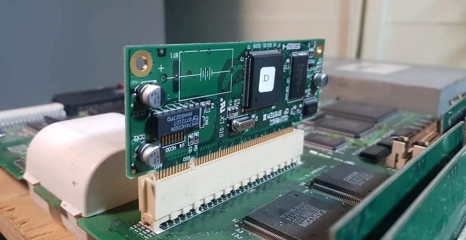

It's frustrating as heck because this Red Earth Asia cart I have isn’t known to exist according to MAME? See attached for pics of the cart & after my successful battery swap. I bought the cart separately & it’s never been with a full Warzard kit before, and I get a "not enough memory message" error whether my CPS3 board has the correct SIMMs installed or no SIMMS installed! (Edit: yes I cleaned the cart connector after receiving this; it makes no difference with this not enough memory error message that comes up. I think this is an actual NoCD cart that s meant to verify there's correct SIMM data on startup).

Dumping the BIOS is beyond my scope unfortunately. I’m waiting on SIMMS to get back to me from KaPH33n that I sent him to flash Warzard to them with a JP cart.
Once I get these SIMMS back this week & fire them up with this cart I’ll finally be able to confirm if this is a NoCD cart.

Just to close this loop: I got my SIMMS back (amazing quick, thanks again @KaPH33n) with Warzard written to them with a JP cart & fired them up with my battery Red Earth cart. The cart I have is *definitely* an Asia NoCD version.
@Darksoft I appreciate the offer to dump it but I really would prefer to keep this cart alive & battery-powered as-is. DE667316-73ED-4E15-A332-7EB7010F7BEC.jpeg
If the battery does die in future it is still possible to dump the cart.
I can understand not wanting to kill it when there is no current method too resurrect these with the original BIOS intact.
