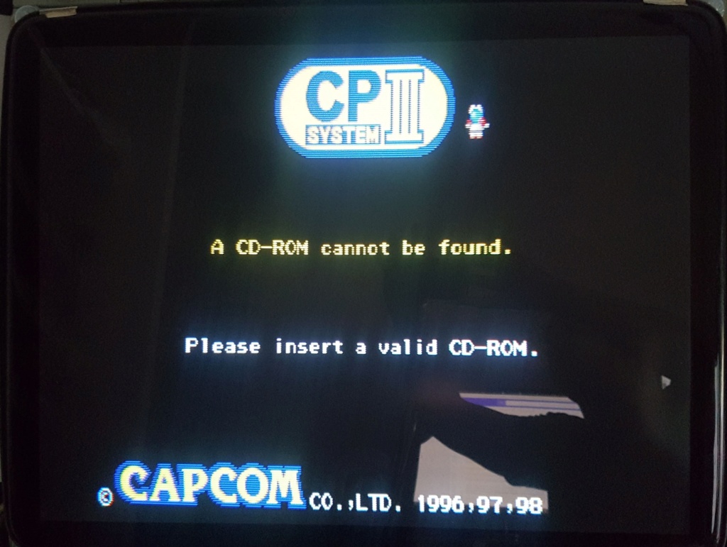

hello, I have this message after few second game boot. is it normal ? I have an original drive and last ultrabios installed in my cart.
THX
No it's not normal. Which game is giving you this error? All of them? Only one? If you are using an original Drive, many things can happen. Those drives are 25+ years old.
THX, yes will all games, tried with another mobo/simms and cable same issue. maybe cart? So i assume that 99% from cd drive.
