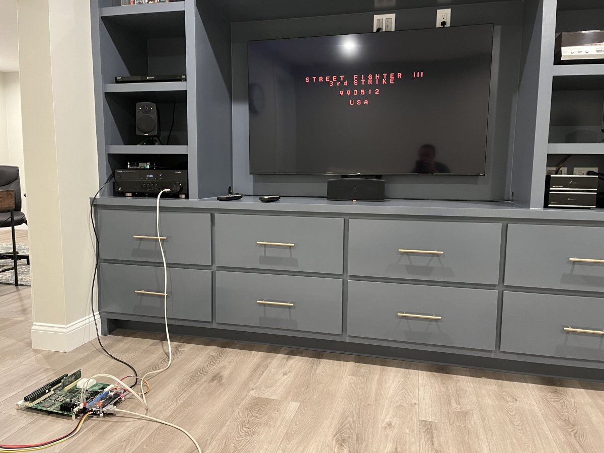

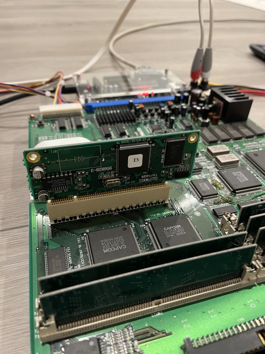

FWIW I had a spare dead cart lying around that I was able to successfully burn a SuperBIOS USA NoCD BIOS to. Interestingly, I had to write it twice for it to work after erasing it with my programmer (Xgecu T48). The addresses all read blank (FFFF) when I first programmed it which was odd considering I erased the chip beforehand. Writing the same BIOS a second time & reading it afterward to verify it burned got me back in business.
“Look ma…no CD!!!”

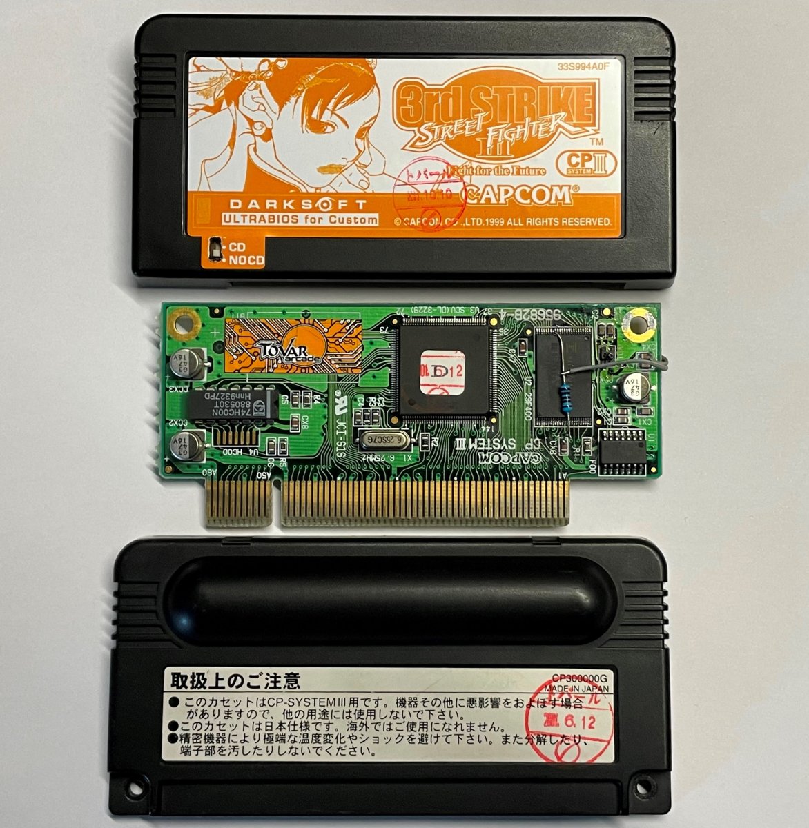

It is also possible to expand the Bios and have CD and NO CD in a single cartridge.
