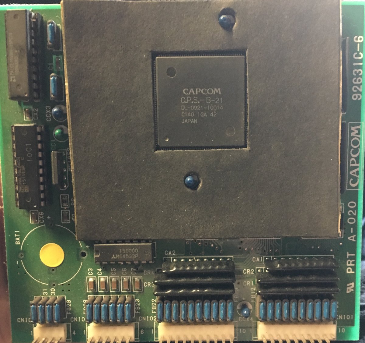

What about this “C” board?
It has the B-21 and looks to never had the battery installed from the factory.
I tested and have continuity between B-21 pins 45&46 and 5V, can I just lift those and tie them to ground(no visible trace to cut)?

That board, even having the placeholder to install the battery, doesn’t have the capability to be key-programmed.
It lacks some components and traces that model 90631C-5 has, such as some diodes and resistor to avoid battery-powering the B-21 while the PCB is running on a cab, and some traces required to send the proper signals to B-21 to be programmed. So, that board will only work with patched romsets prepared to be run with B-21 in default mode (without decryption)
Saying that, it is possible to tune it up to make it behaves like 90631C-5 board. For the particular case of upcoming Darksoft multi-CPS1, battery-related stuff are not needed, but signal programming stuff are.
That modifications were only theorized initially, but we recently tried it with real PCB with success, so it could work and that could be a valid option to run the entire catalog.
Anyway, it is not an easy stuff to perform as it involves smd soldering and tracing here and there.
I think more details will be posted when it will be released. ;)

I followed the instructions in this thread so hoping I’m good to go.
https://www.arcade-projects.com/thr...a-90631c-5-battery-backed-b-21-c-board.13116/
I have no problem buying one of the other types but would rather leave those for other folks if this is a valid board after the modifications.
