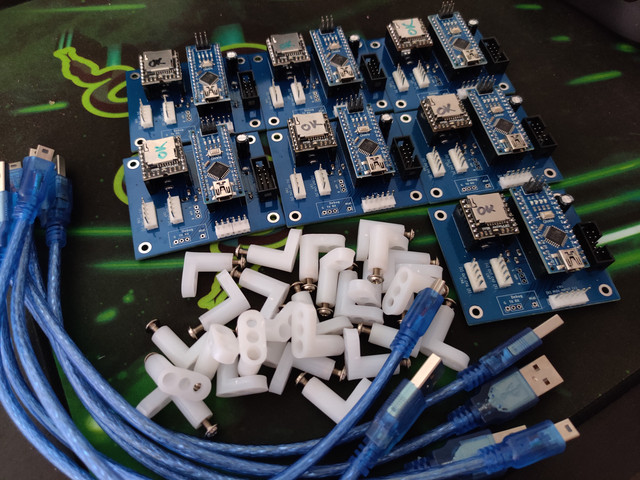

I'm in the process of building new board. Currently waiting for connector... Every big shop (mouser,farnell...) are annoucing huge delays and other sources says they got it but never ship.
I hope to have some in May.

I restocked few boards. First-come, first-served :D
All sold
Note: The shortage of components forced me to replace the 6pin connector by 2x3pins. In practice it's the same, still using the same original JST as on the SEGA board.
