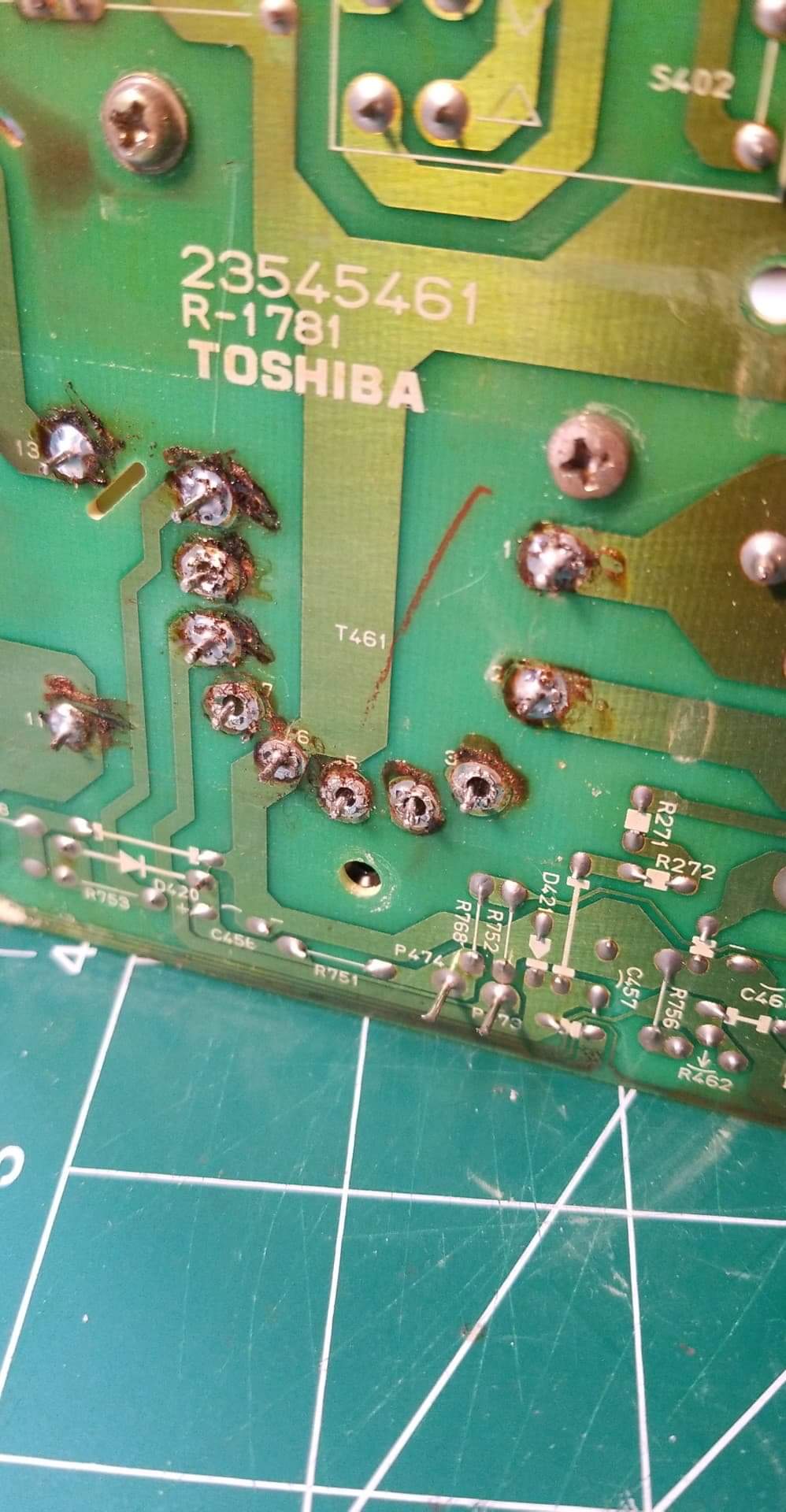

Perfect thank you sir. Yesterday I rework my chassis a bit. Change my caps out. Lots of bad ESR failure. Will need e/w pot... Assuming pincushion? Based on image. Chassis ran for a while but eventually blew switching regulator STRM6511 apart. Not sure what cause that yet. Now I need to wait on parts before taking it on again.
