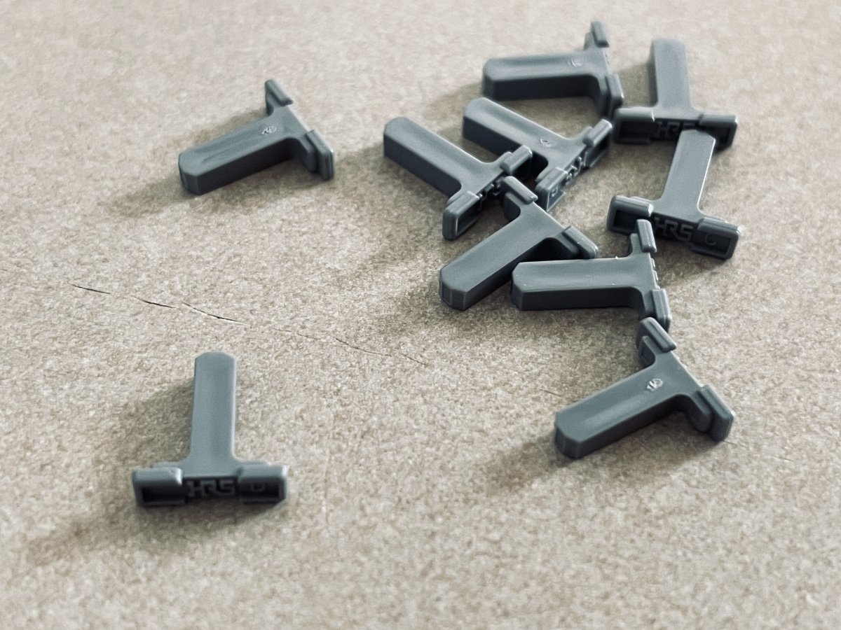

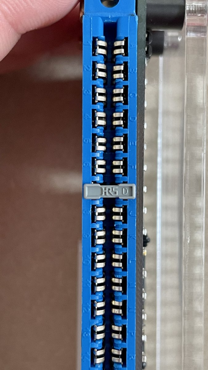

The Hirose connectors are brittle and do crack. You can mitigate the cracking if you use a polarizing key which helps locate the connector horizontally during insertion. You also get the added piece of mind of never reversing the connector.
Hirose makes a high quality key, (part number CR1-GPIN). Mouser has stock though it looks like the part is discontinued. Laser Bear makes a more affordable 3D-printed version though the fit is not as good as original part.

Yeah u get that when u force a pcb in without aligning the pins first. I used to use those keys but got tired of having to constantly take them out for bootlegs/adapters or pcbs without keyed pin 7. Still i bet it will still hold a cps2 cart vertically without any assistance right? Mine still has grip of death.
