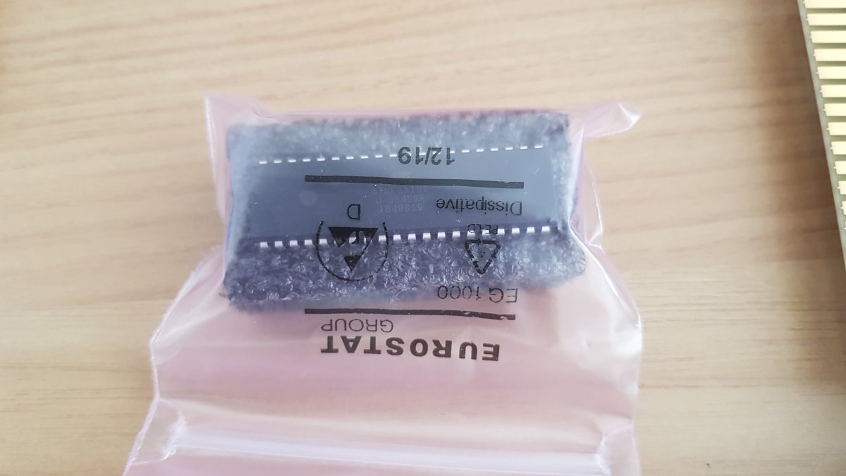

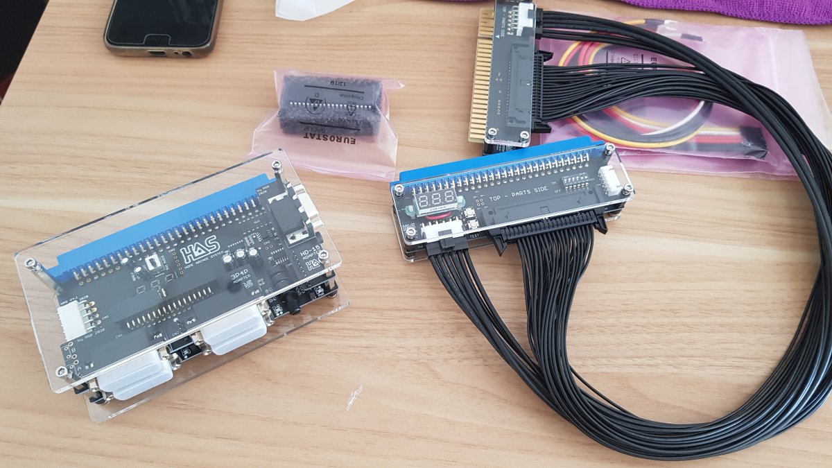

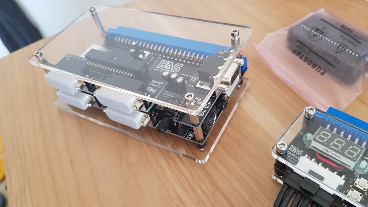

Hi, i got the HAS from @RGB in september of last year but wasn't able to unbox everything until now, i setup the supergun with the 4 player module + the hd-15 pcb module, i also got a jamma extender, but i have this eprom which last after putting everything in its place and dont know what is it or what was for ? Any idea please ?

That looks like the IC that controls the button remapping. In your pictures, I can't see in there is already one installed on the HAS. It would be underneath the player 3 & 4 controller board.
If there is already one installed, you must have bought an extra. If not, just put the IC in the socket.

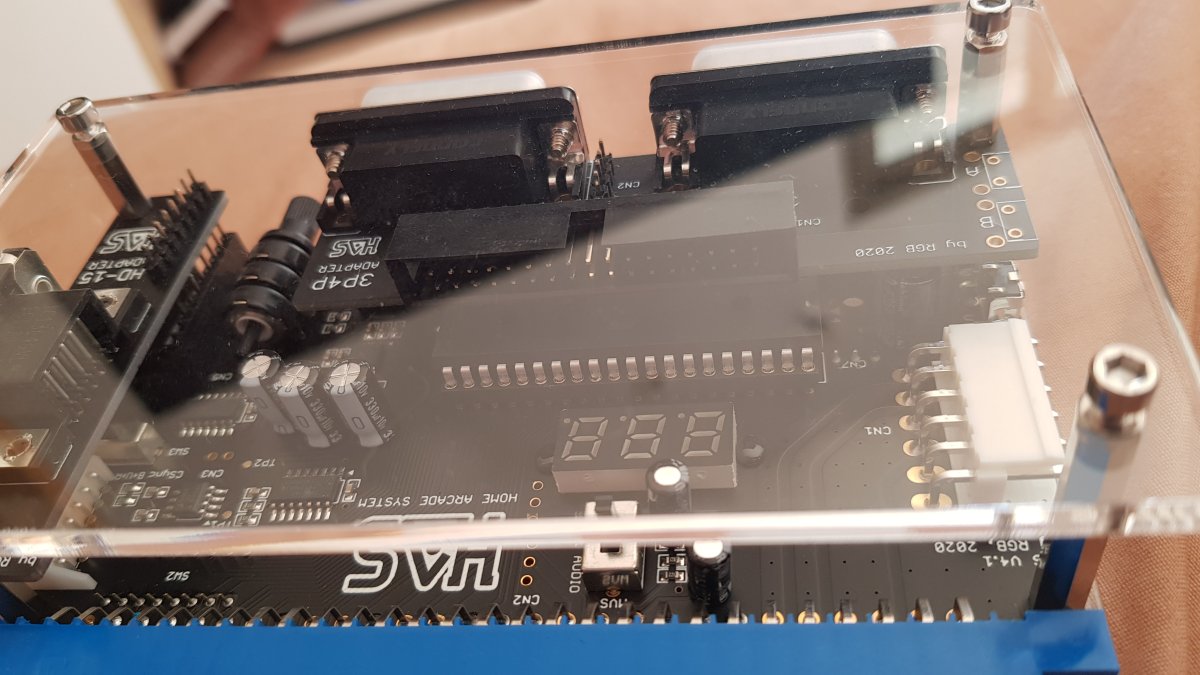

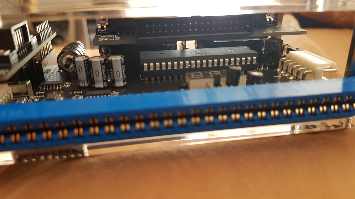

I think there is already one. Could it just be an extra ? Because i didn't pay for it, maybe @RGB just sent it for free ?

It's a backup microcontroller, I must have included it by mistake :thumbup:
He included it because you wants you to have more than you asked for!!! Great salesman!
For me @RGB included an extra that allows me to re-map my start button (not a button that you can usually remap) so I can play certain games like Rampart with my HAS. You should pop yours in to see if its a normally microcontroller or if it is programmed like my extra one!

I just checked the initial invoice, i ordered a backup one and forgot that i did it 😅 very likely that i wont use it.

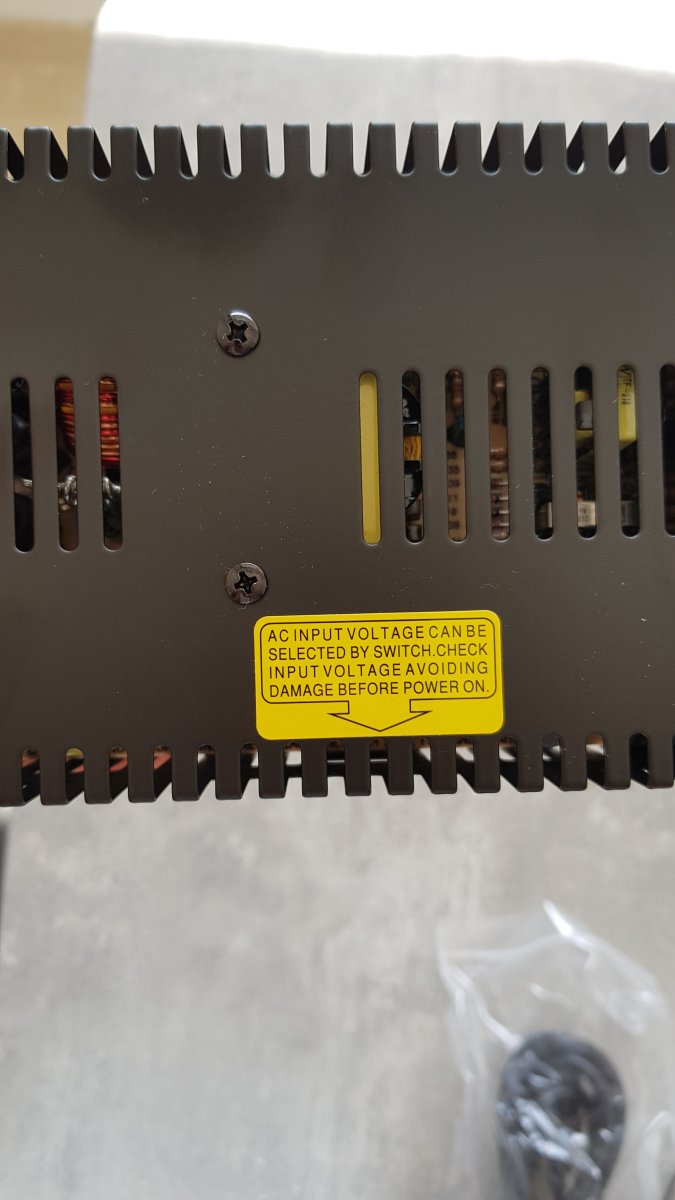

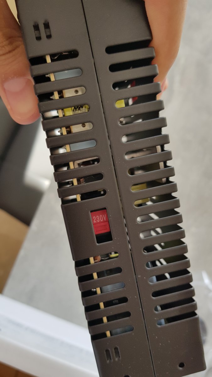

Now i just unboxed my PSU but don't know how to use it, i have a warning message but dont know if it talks about the switch inside ? Also i have 220 volts in my country, should i leave it at 230 ?

Hey, that's a nice PSU! Leave the switch at 220V, the real voltage range it accepts is much wider. It's 88~132VAC for switch at 110V position and 176~264VAC for 220V.
Please make sure you read the HAS instruction manual and refer to FAQ if you're unsure how to connect the PSU - https://homearcadesystem.wordpress.com/faq/

Do i have to avoid touching the PSU metal core while its powered on or i should just avoid the connectors (the screws) ?
If i want to turn it off do i need to unplug it from the socket everytime ?
Could i use the whole setup (HAS + PSU) connected to my retrotink 5x + my oled tv without issue ?
How much voltage do i need to feed on a PGM mobo ?

1. You can touch the metal housing of the PSU, but DEFINITELY do NOT touch the screws. In fact, you should look for a 3D printed cover for them. I've heard stories where children or cats have touched them to some sad endings..
2. Yes. I personally use a power strip so I can use the power strips button to make it easy. That is less wear and tear on your plug. Also, do NOT power the HAS up without a game.
3. Yup, in fact, you have the BEST TV for this case, IMHO!
4. The PGM should be cleaned, all connectors, at the JAMMA edge, and at the cart edge. I still run my PGM at around 5.05-5.10v because it seems to be a bit power hungry. I would not go over 5.15v.
