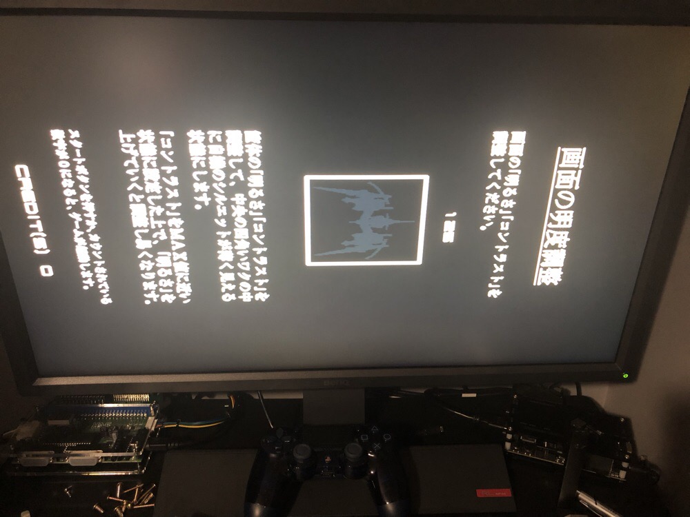

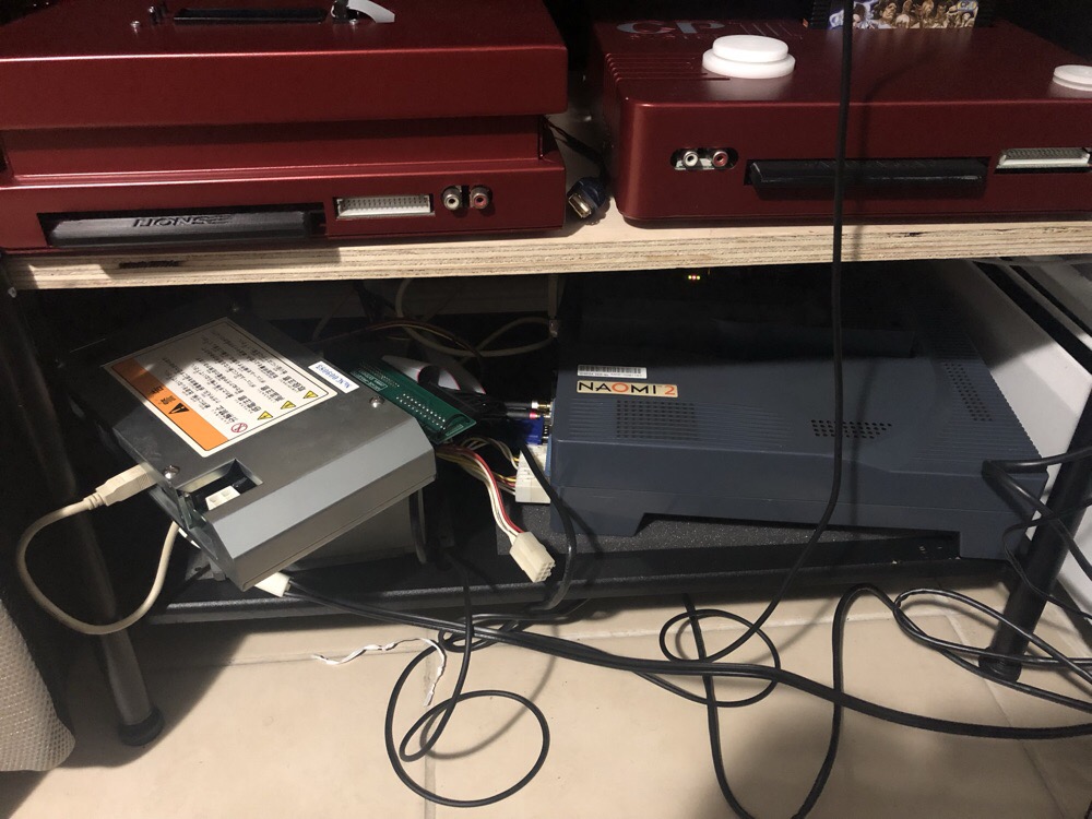

for now put the good stick in slot 1 and the bad stick in slot 2 and test on some small games (Ikaruga for example is the smallest NAOMI game)
Even though ikaruga says on the chart you need 256mb? Because technically i only have a 128mb working.

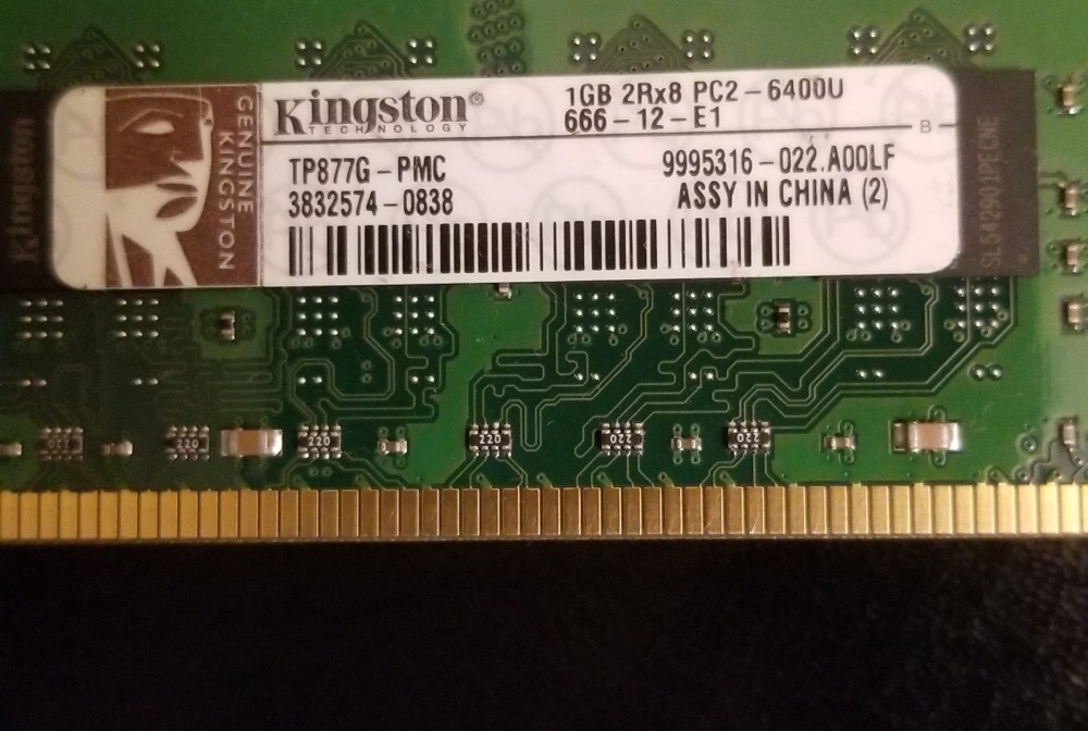

Sooooo ikaruga worked with the 2 128mb dimm even though one is bad :thumbsup: , im gonna go grab that 1gb kinston dimm from a friends to then test it out with that one.

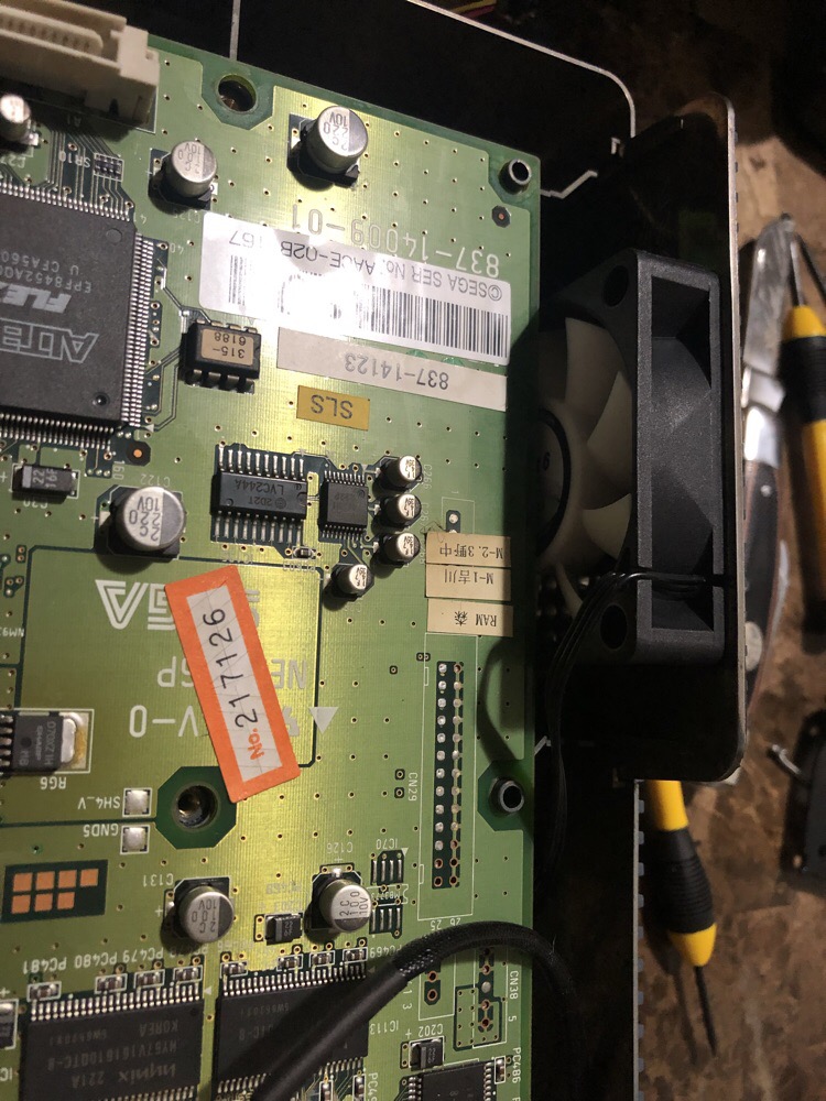

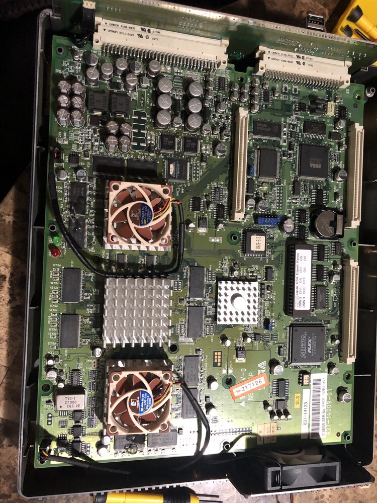

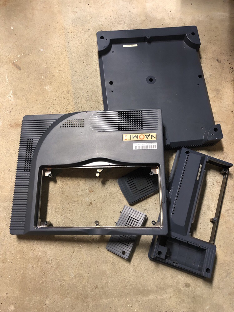

A good wash and some silent fans :rolleyes:
I think this warrants an adventurous time to broach the positive vs negative airflow debate...
Positive air pressure should win out on the dust issue - you control the point of entry (the fan).
Of course you need a filter on the fan to ensure only clean air is being pushed in, which the Naomi for example doesn't have, so... kind of fails at the implementation stage is guess...
when you crack the case and are replacing fans, you kind of have control over that, no?
Yes, but adding a filter has an impact on the airflow. To compensate for that, you need a faster (noisier) fan.
Besides the fact it decreases cooling, dry dust isn't very harmfull for electronics (it's not conductive).
You can easily blow a pcb clean with a compressor. (Monitor chassis are less forgiving)

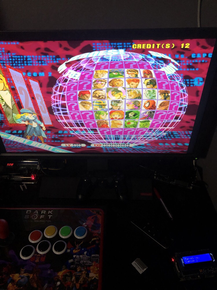

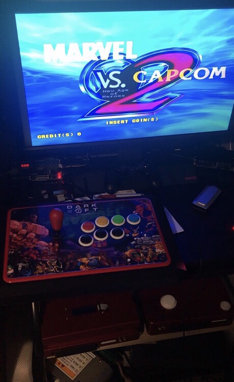

Would anyone one know why i dont have all the characters unlocked with the “Unlocked” version of MVC2?.
