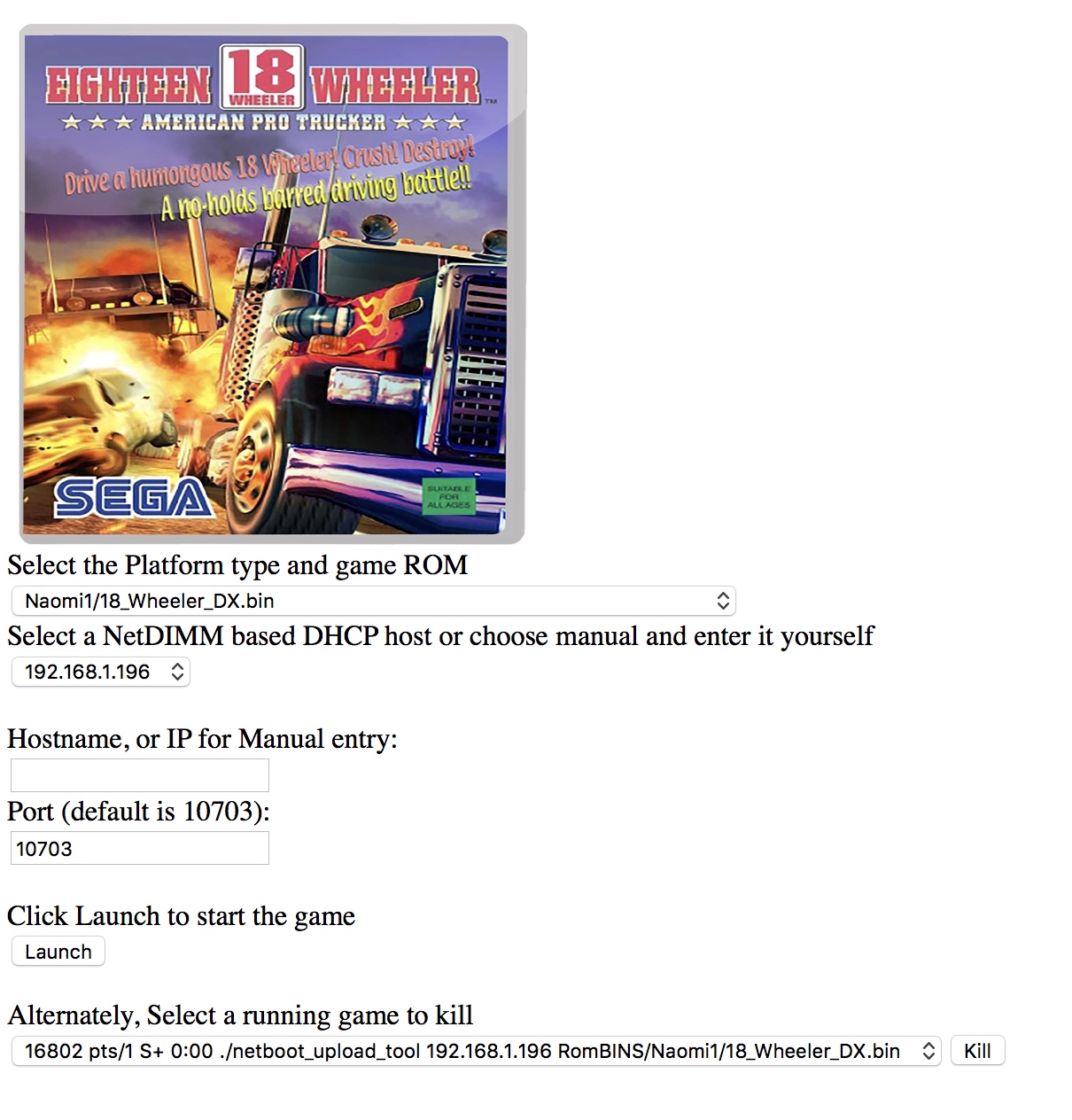

I too have been hammering on a web interface to use along side my internet based loading, mine however is written in the ruby language. It isn't much yet, but if anyone wants to follow along the code is here. https://github.com/ArcadeHustle/RomHustler
I just got the core functionality working, and started in on the aesthetics. Sorting out all the game images is on my immediate plate. I wanted to use the game flyers from here: https://emumovies.com/files/file/3119-sega-naomi-2d-boxes-with-discs-151/ the guy says you can't reuse *his* art, but they are just scanned game flyers, so I am conflicted on his ability to claim they can't be used.
I'm currently using a DHCP setup to make sure my boxes have a valid gateway as outlined here: Details on how to use the "REMOTE" (DHCP) setting with a NetDIMM to get a "GOOD" Network Test . I use that alongside the code above running on a dedicated internet based server. It takes about 2 minutes to push a game out remotely (and I could care less about the bandwidth). I can send games currently to either my home network, or the one I am testing at my best friends house. We are using dedicated port redirects on the router to manage individual remote machines. As long as you have a port open, you can hit it from the outside, and push it a rom. There is a "manual entry" field that you can choose and subsequently specify the remote IP and port to push the rom to.
